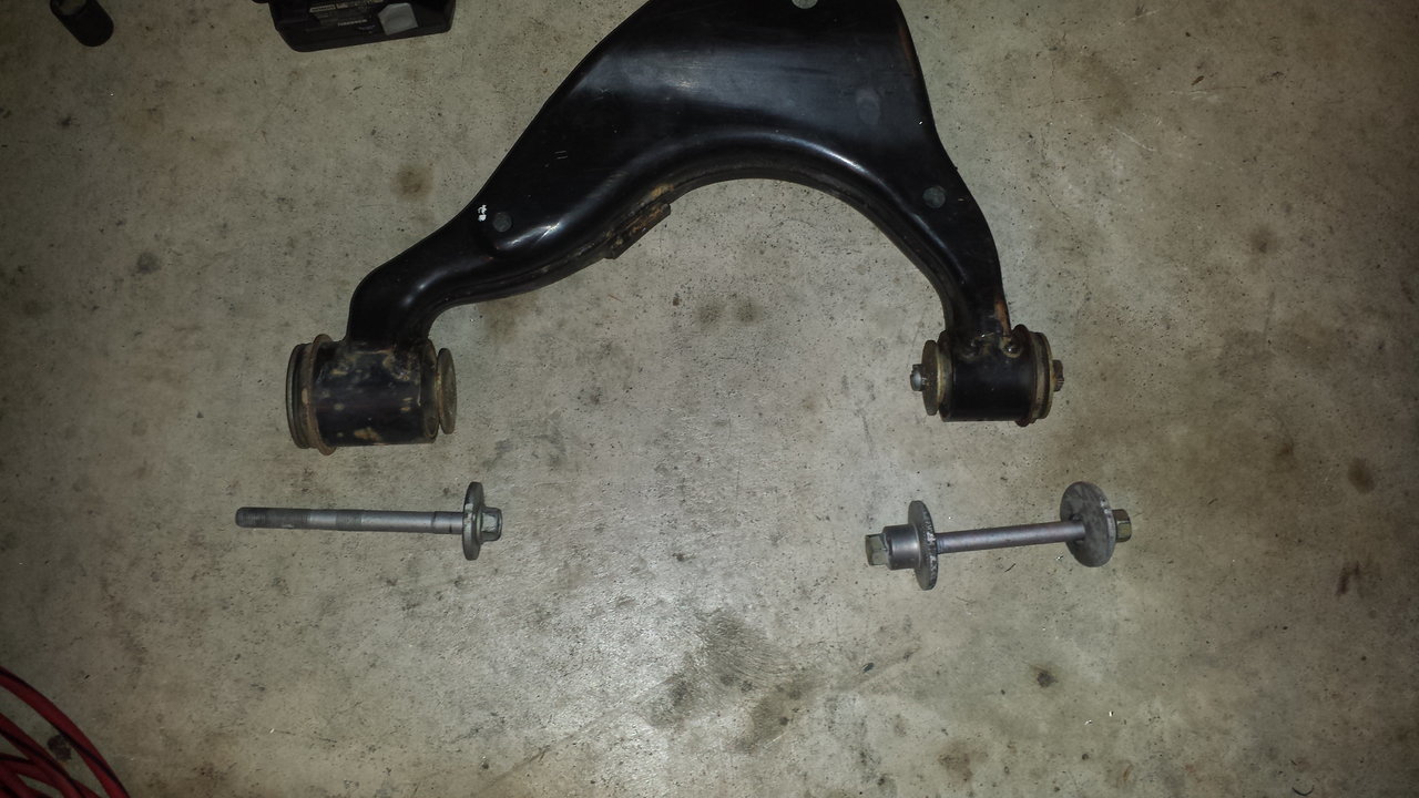

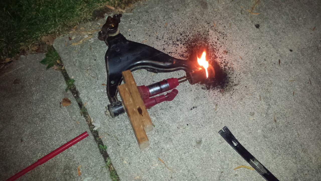

    The cam bolt sleeve is gone. Had to cut it to get the arms out (both the front cams, rear cams don't have sleeves)
    So do I knock out the whole bushing or just burn out the rubber?

    I had to burn mine out then cut the outer bushing with a hacksaw to peel it out. Make sure you don't cut the LCA :D

    Just a little. Cut off wheel on the inner metal part of the bushing?

    huh? Don't remove sleeve, jist burn away rubber.
    All metal pieces are reused. The poly just replaces rubber.
