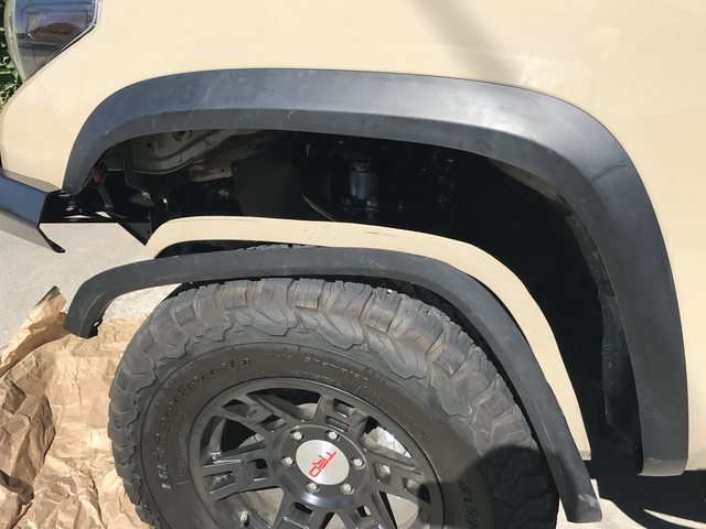

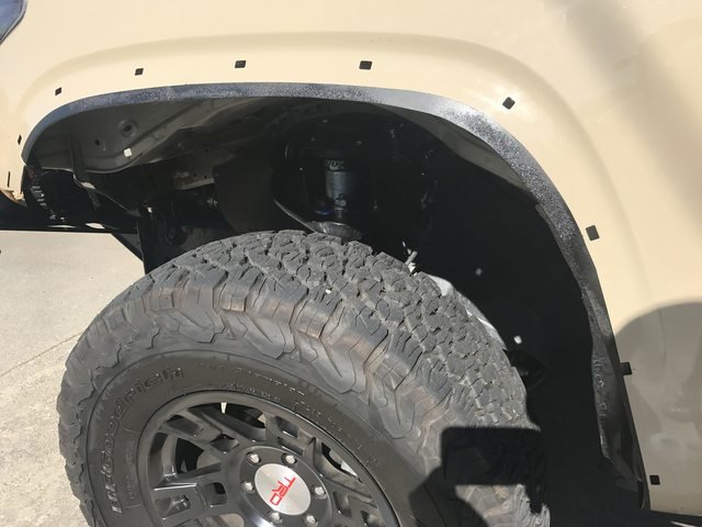

    These are from someone else's page. My flares wrap down and back under into the wheel well. If the bottom portion is cut off, what keeps it from just dangling?

    they just are open. i ran bolts through mine in a few spots and sprayed all in openings with plastidip for extra security when slinging mud. You'll keep all the original clip on points but all screw spots get cut off.

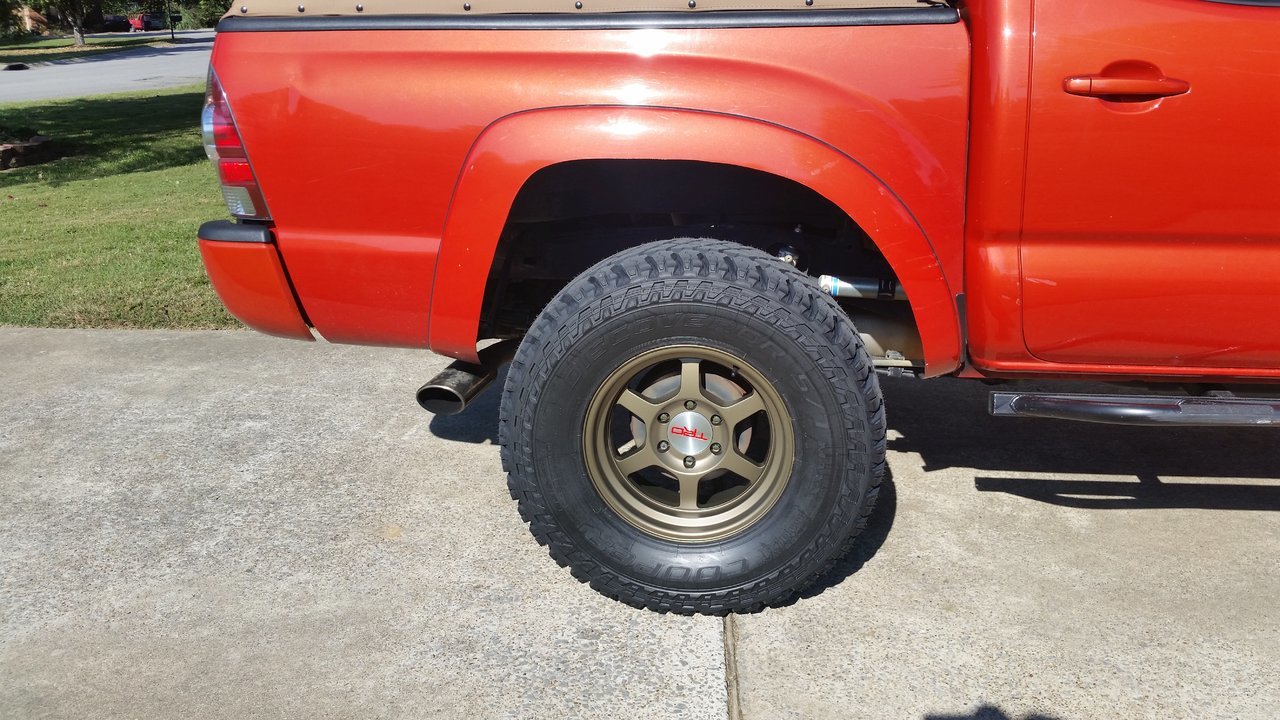

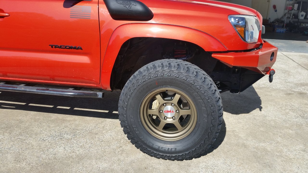

    Here are the best pictures I have of my cut flares.

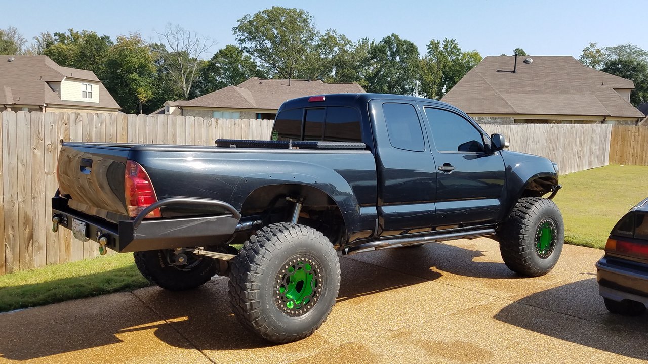

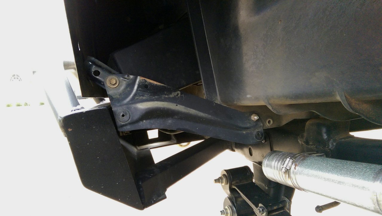

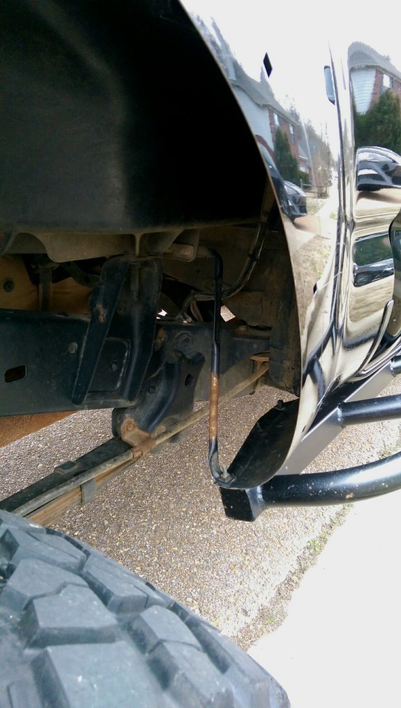

    Here ya go Tim. I never put my flares back on so it just leaves holes. I also reused the stock brackets to hold the bedside. The rear brace is just flipped over and I drilled 1 mounting hole with a black hex head bolt. The front brace is cut, shortened and welded back together.
