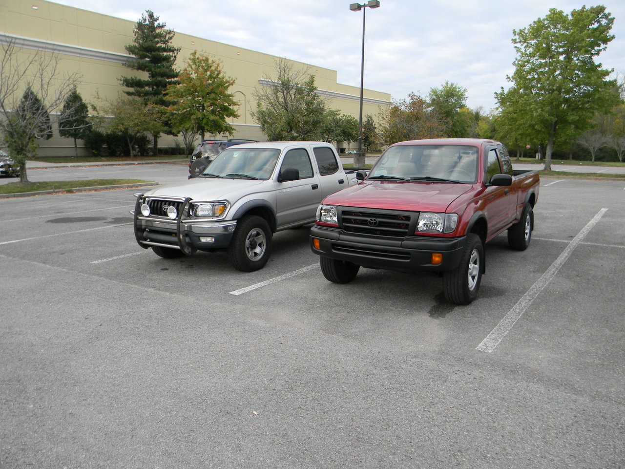

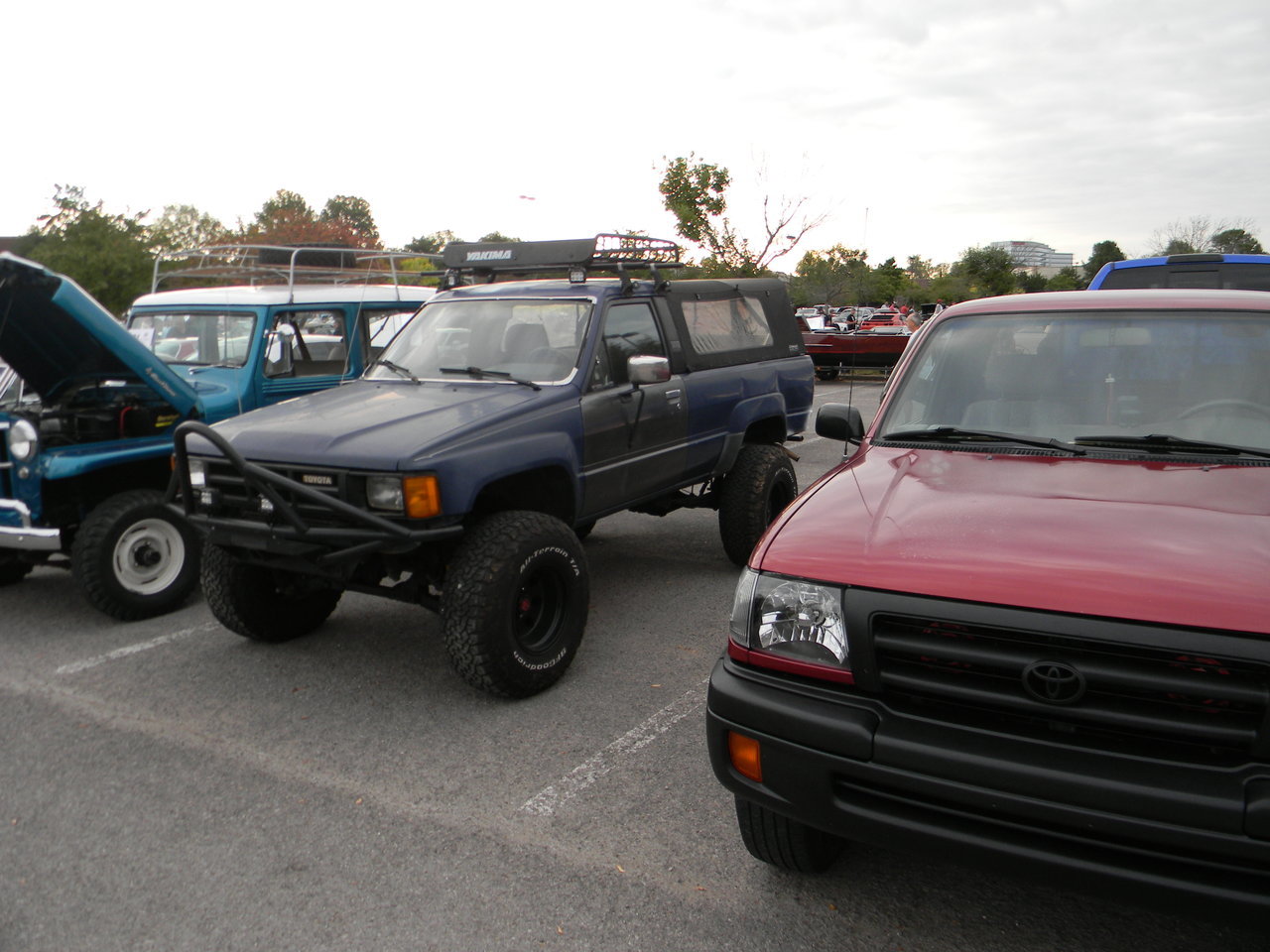

    Forgot to post this. Saw these guys at C&C last Saturday. Anyone on here?
