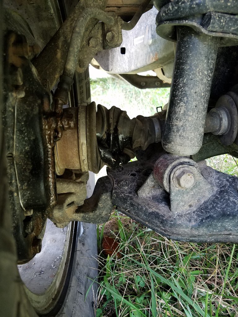

    Cv axle boot is all twisted up and it's making an awful noise. Wonder what could be the problem? :notsure:

    Well dang...that sucks..is that a piece of the cv cage poking out?

    Yea, it cut up the boot. @rngr, @JBTacoma and any other first gens. I need advice. I've only had 4wd for a couple month and already broke a cv axle. They were the duralast gold. Are there stronger than oem axles I can get? I looked into rcv axles but didn't see any options for first gens tacos. Searched
    the first gen forums with no luck and also no answers from google

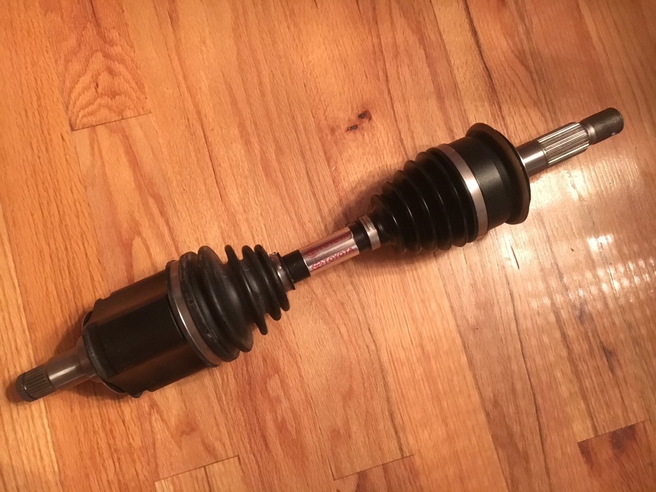

    I just bought a remanufactured OEM axle for $200 with the core refund.

    Yessir. Got two re-man OEM axels on my taco now. Kept my old ones for a rebuild and spare for future.

    So how do you not snap axles every few months. Is this a driving skill issue. I was teetering between front driver and rear passenger tires while driving up onto a creek bank. Gave it a some gas and the front passenger came down spinning, gripped and snapped the cv. I know it was hard on it but I didn't floor it or anything so it couldnt jave been spinning that fast. Just a lil gas and pow.

    From what I understand OEM axles are
    Much stronger. Never had an issue.

    Go OEM, you will just keep braking all the others.
    I broke an off brand a few weeks ago, got my OEM back on now.
    Go to the junk yard and find a good set and order you a reboot kit.
