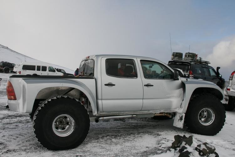

    Pretty much what they said. To fit 35s you need to cut just a few small things but anything larger and some of the wheel well has to come out. I'm cutting out more then I need to right now so at some point when I get 37s, they should clear no problem. I'm also doing this because I off-road my truck and with the suspension fully compressed, big tires will get into everything where as its much easier to fit bigger tires if all you do is drive on the street as you just have to clearance for ride height.
