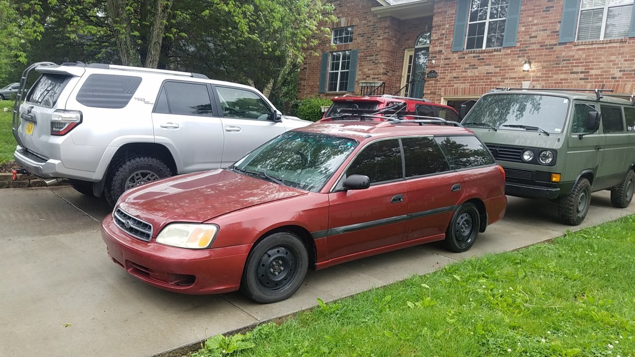

    Got my wife's new car.

    Nice! Great time to do it. If you swing through Boston let me know and we can meet up for a drink! Salem is only about 45min away from me.

    Driveway is getting full... What is that, a '02 Outback?
