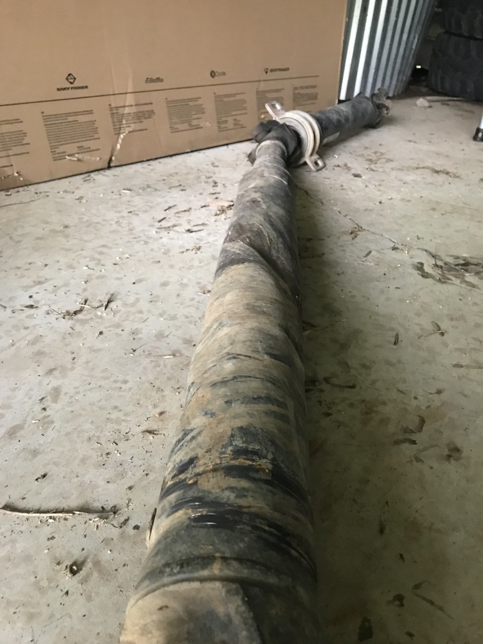

    Figured out what one of the other noises is on the truck.
    How much can I keep driving with that center bearing of the driveshaft squealing?

    I drove for a couple of weeks like that. Maybe 2-3.

    I wouldn't worry about the wet spot man. If it don't leave a puddle underneath I'd let it go. The carrier bearing though, I got mine from McMaster Carr. Can't remember the part number exactly but it's pretty much a direct fit, plus it has grease nipples so you can keep it lubed up easy.

    Not advised.
    Pull it and you can still drive to work in FWD a few days while you fix it. :thumbsup:

    New Spicer center support bearing will be here friday. $38. :)
    Just going to hope i have some metal laying around if needed to make a bracket for it.

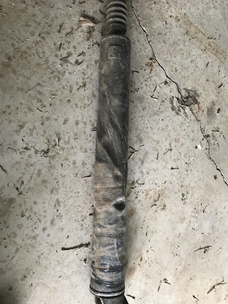

    It doesn’t look like this one does it?

    Retube it while it's out with heavier wall. Factory is .063 upgrade to .093 if possible
