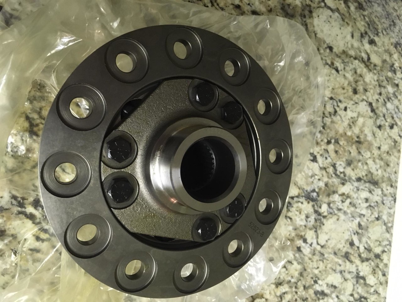

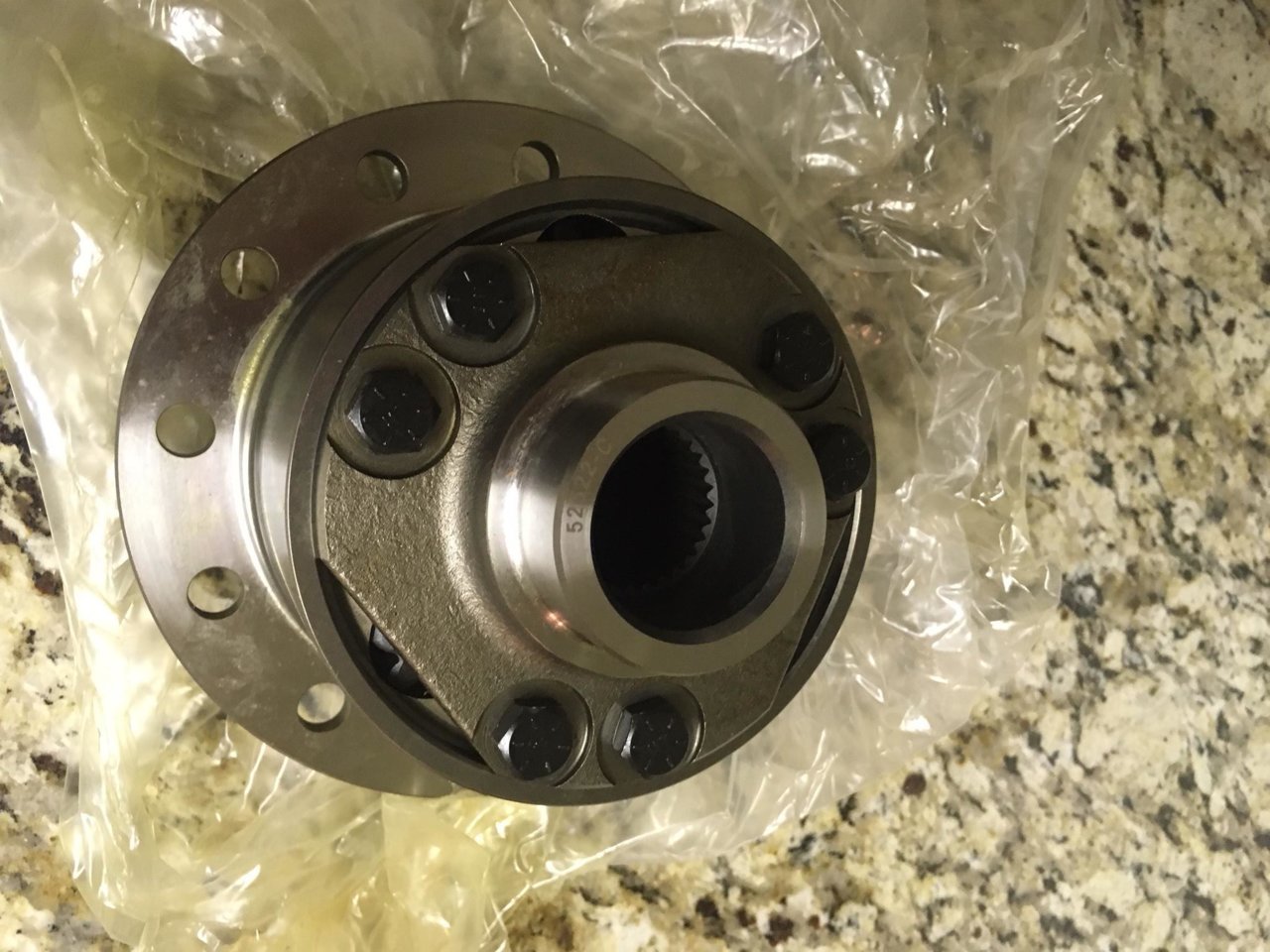

    Not the same thing. That’s a limited slip. Would be more traction than your open diff, but still not a locker.
    My thoughts... if you’re going to wheel, get a rear locker.

    What Carter said.
    It's a small increase in traction and would be great for doing burnouts in an Xrunner, but offroad when you're already in a pinch and you need a real locker.. then you need a real locker. LSD just won't cut it in most technical offroad situations

    Gotcha. While waiting for a reply, I was doing some reading. I always thought they were a locker acted like an open diff on the road until one wheel loses traction. I've now learned they are not capable of sending 100% of the torque to the opposite wheel if needed. That is no bueno.

    This would be much better for On-road use than the powertrax, but you'd suffer some off-road performance. That's a heck of a deal on one though! As far as LSD's go the TrueTrac is the top of the line! Being gear driven vs clutch they don't burn out like most LSD's. I had one in the front diff of my Ford, combined with Detroit rear locker. The off-road performance was awesome! :mudding::thumbsup:
