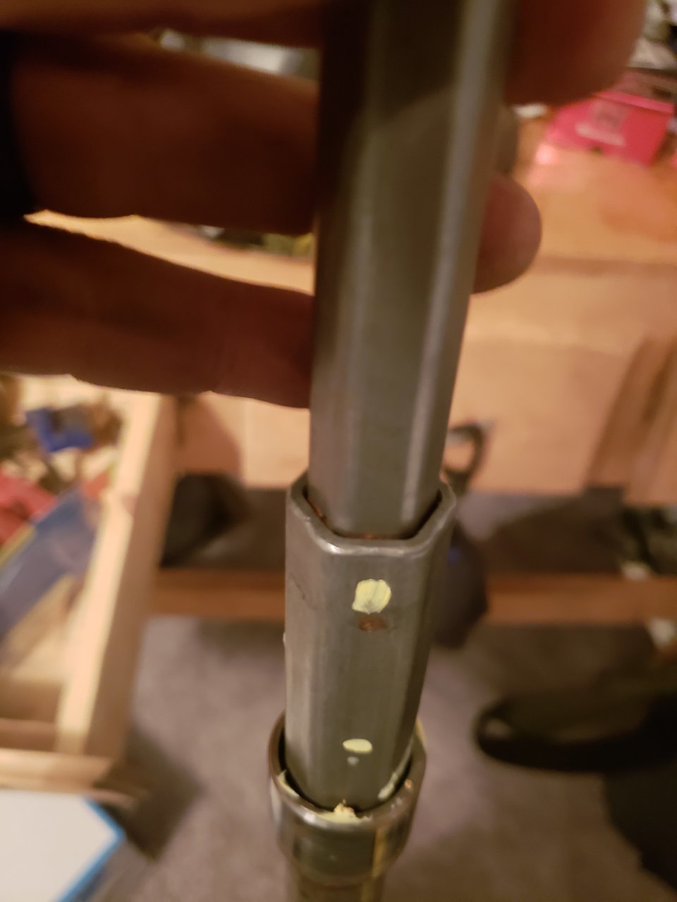

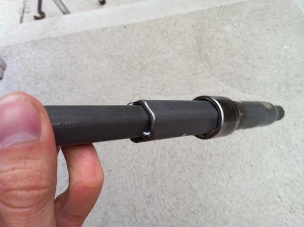

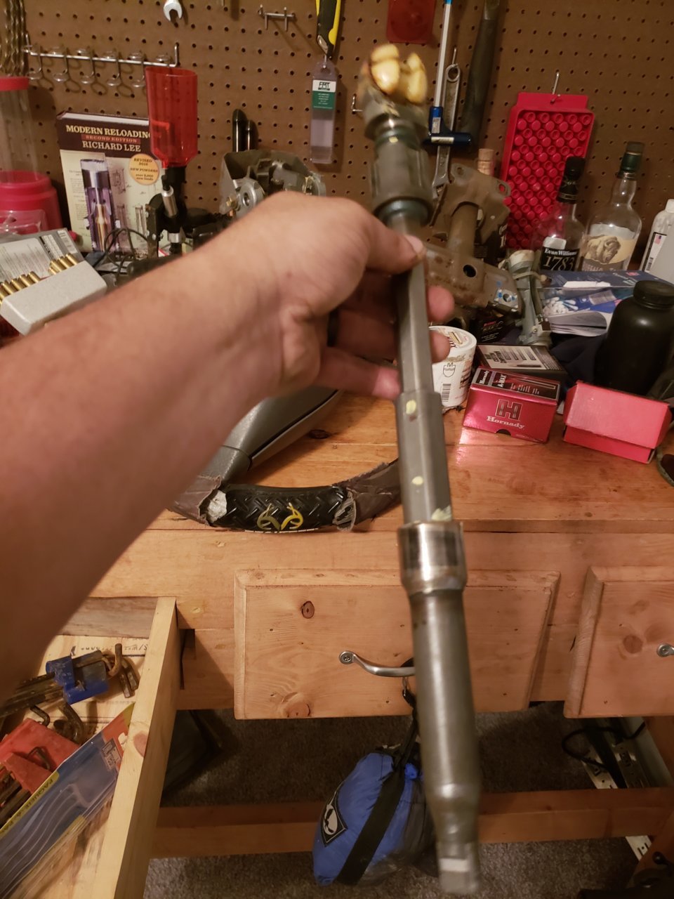

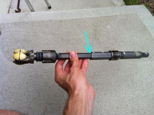

    Anyone in or around galatin have a mig welder I could use? I need to put some tack weld on my steering column. After replacing most of my steering and suspension joints only to still have play, it turns out I should have listened to @rngr and @Justinogo and looked at the column first. :facepalm:So this is the plan to fix it. Basically just putting a tack weld here. user42191_pic4205_1280607966.jpg user42191_pic4207_1280608055.jpg tack weld.jpg
    Already pulled the shaft out,20180828_211011.jpg 20180828_211008.jpg so you dont have to worry about me ripping my dash apart in your driveway. Only need to make the quick tack welds. And I need to get it done asap. I'm headed out of town for the weekend, hopefully in the truck. Haha

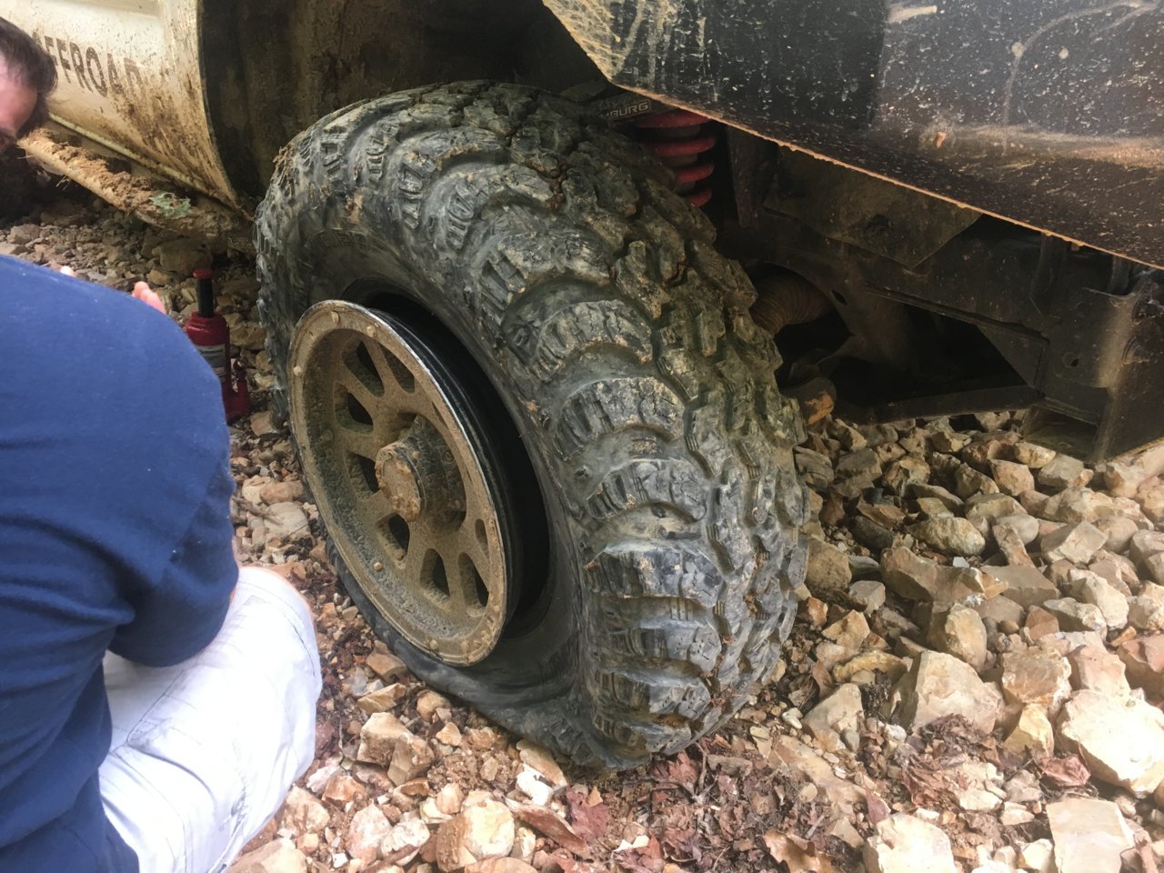

    What wheel/tire combo are you running now?
  16. Aug 29, 2018 at 4:25 AM
    rngr
    rngr Aix sponsa
    Jan 13, 2015
    #146258
    9,244
    01 SR5 4x4 2.7L
    The ones that hate holding a bead. It’s nuts.
    beertimecontinuum likes this.
  17. Aug 29, 2018 at 4:29 AM
    Snowy
    Snowy Is neither here nor there
    Feb 5, 2014
    #122349
    3,464
    Connor
    Winnebago, IL
    3 linked 98 Xtra cab
    Stock-ish
    If that’s a 17” Irok than that explains things. I remember years ago it was pretty well known that the 17” Irok doesn’t hold a bead at all...like guys running 15 lbs on beadlocks to keep the inner bead on. Things may have changed since then but it was definitely a thing
  18. Aug 29, 2018 at 4:32 AM
    Snowy
    Feb 5, 2014
    #122349
    3,464
    Connor
    Winnebago, IL
    Stock-ish
    One of the fixes is to either run RTV or silicone on the wheel bead surface or a layer of duct tape on the wheel to tighten things up too
    tacotim448, Justinogo and rngr like this.
  19. Aug 29, 2018 at 4:33 AM
    beertimecontinuum
    beertimecontinuum What's outside the simulation?
    Dec 29, 2013
    #119461
    9,991
    Everett
    Ky,Earth,SolarSystem,MilkyWay,VirgoSupercluster
    10 Pyrite DCSB VEEEEEE 1.618
    FoxShox, Dirt King Heims, Chevy63s, 2UZ-FE V8 Flowmaster 40, Demello Front/DYF Rear w/Swigouts, BAMF sliders, DYFAF
    That's a thing? Damn was thinking about those for my next tire (37x) but I'm only locked on the outer...
  20. Aug 29, 2018 at 5:28 AM
    Snowy
    Feb 5, 2014
    #122349
    3,464
    Connor
    Winnebago, IL
    Stock-ish
    Yeah it’s only on certain sizes if I remember right. I’m sure you can google around and find some info on the size your looking for. Interco isn’t known for consistency across sizes
