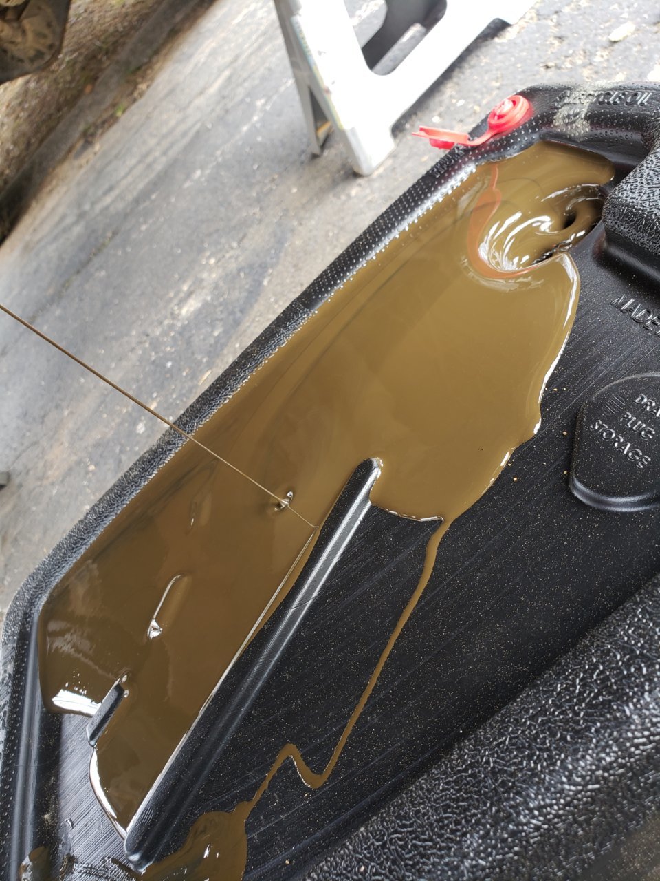

    Is it normal for the front diff's oil to be this color?
    ThunderOne, Dave41079 and tacotim448 like this.

    Just put a dose of Pepto in there for it. ;)

    Mmmm water oil

    More like year old lbl mud and oil. Even smelled a little rotten lol

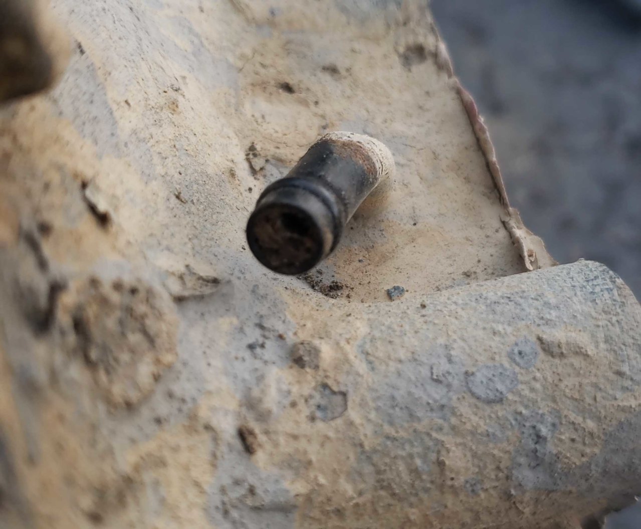

    The main reason for this is the fact I didn't install a diff breather when I did the 4x4 swap. I also didnt even have the stock one on there. Just and open tube that now is clogged with mud.20190202_165807.jpg
    It was also an add diff that I modified to always be locked so it would work with manual hubs and no vacuum lines. I didnt plug any of those holes either. So mud had many different ways in. It destroyed the thing over a period of about 2 years. 20190202_164347.jpg

    All good. Got another one to go back into its place. $300 lesson learned. Also have the stuff to install a diff breather on to this one. Lol
    Kinda curious what its gonna look like when I crack the rest of it open.

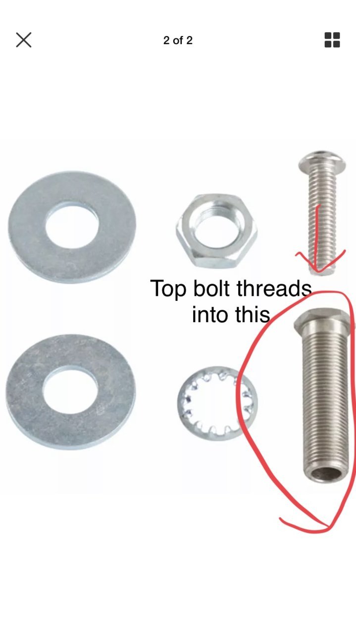

    Would anyone know how to piece together something like this? Just need to know the names of the parts, chiefly the circled one that seems to be the most special.

    What is this for/what are you trying to achieve? I would call it a threaded bushing.

    It's for my spare tire carrier that's in the bed.
    Here's the item in question
    https://www.ebay.com/ulk/itm/312455900106
