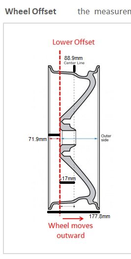

    7 inch wheel = 177.8 mm. Offset = -17 so backspacing is 88.9 - 17mm = 71.9 mm. 71.9mm to inches = 2.83 inches
    Could be wrong but if offset measures the distance from the middle of the wheel and BS is the mounting surface to the back of the wheel.. the math adds up but that's SUPER LOW backspacing.
    Now if the offset was +30 (seems like people are not sure?), then the BS would be 88.9+30 = 118.9 or 4.7 inch BS. Which sounds more like stock toyota BS for most truck wheels

    That's what I figured, which makes them no good for my application. 4.5" is stock for 1st gen taco/3rd gen runner. I'd be rubbing frame with little tires. haha.

    I can't find official specs on the backspacing of those steel wheels. But after some digging, I'm finding numbers ranging anywhere from 4.5 to 5.5 BS, 5.25 being the most common.

    A 7" wheel is 8" wide. Go fix your math.
