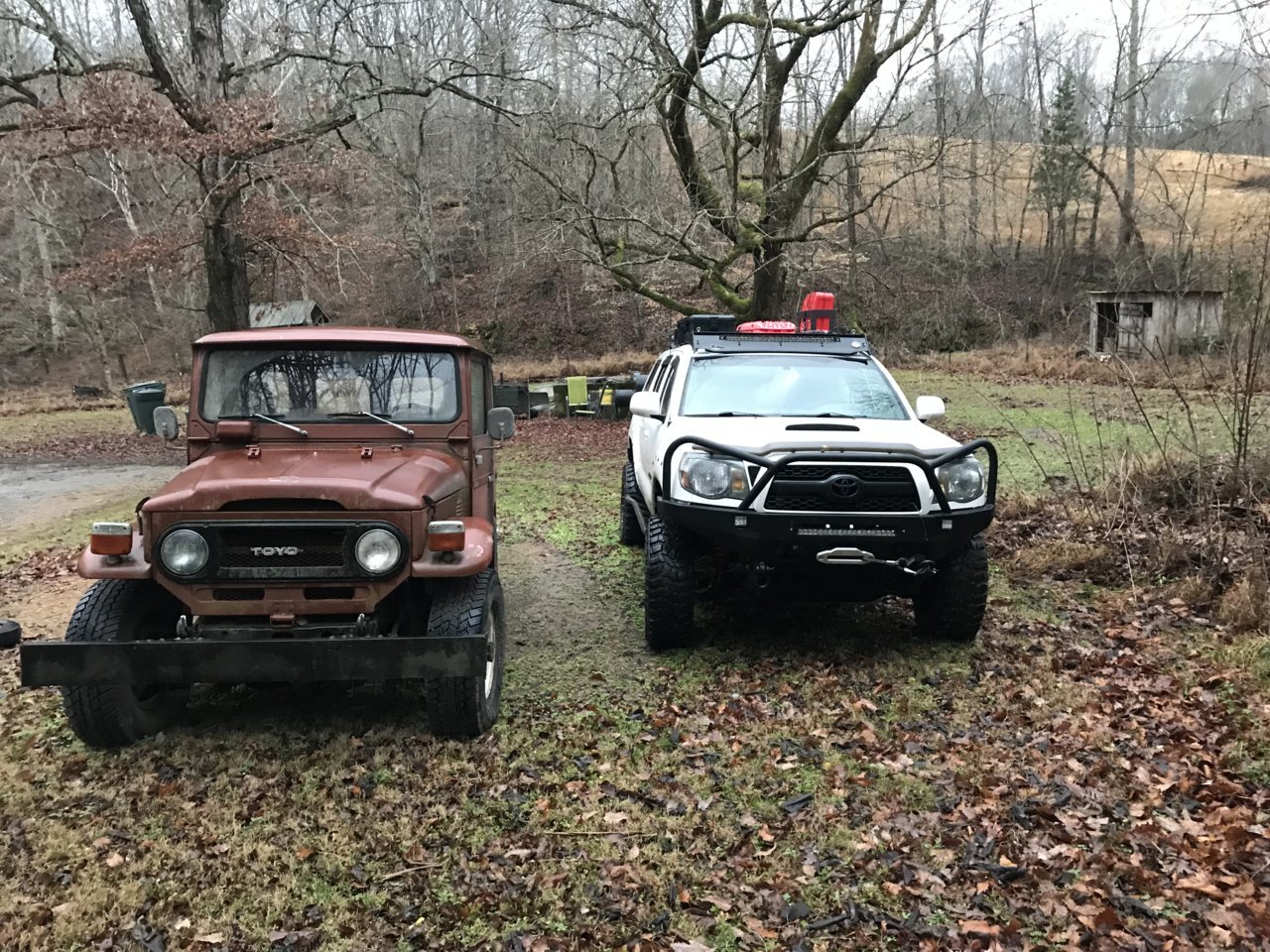

    Here’s mine. Someday I’ll get started on modifying it.

    Dude! hell yeah! there are two routes to go.... the restoration route... or the crawler route. Crawler route is pretty simple. Spring over conversion is pretty cheap and easy and gets you 4 inches or so of lift to at least fit 35s. If you stretch the wheelbase these things are damn near unstoppable. Mine has some love marks on it haha

    Dude leave that thing exactly as is, rust and all. Badass!!

    Yea, I don’t plan to overbuilt it. I do want to give it some love eventually.

    Yeah I'd spray some clear coat on it and it's perfect.

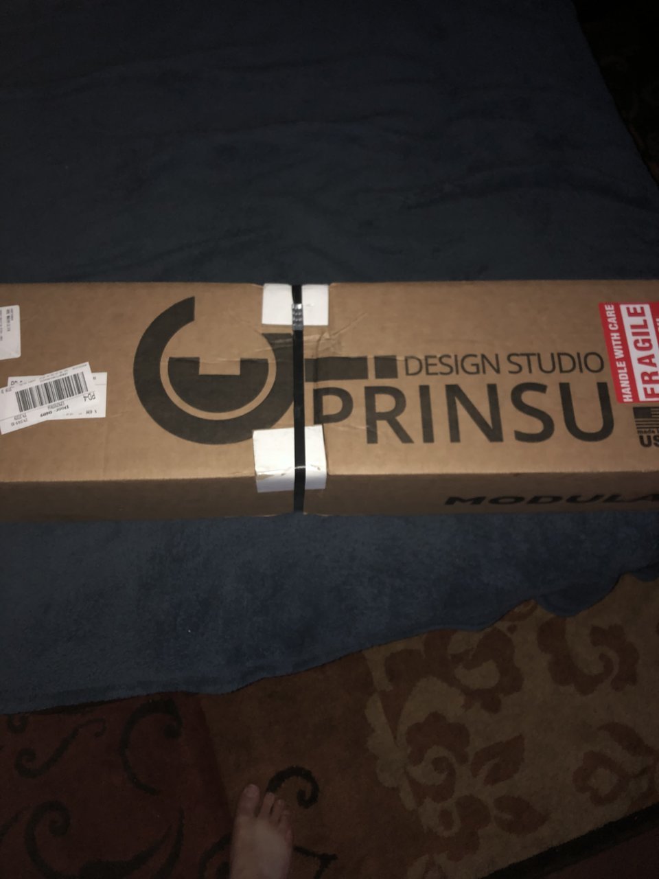

    Had this goodie show up for the 4runner last night.

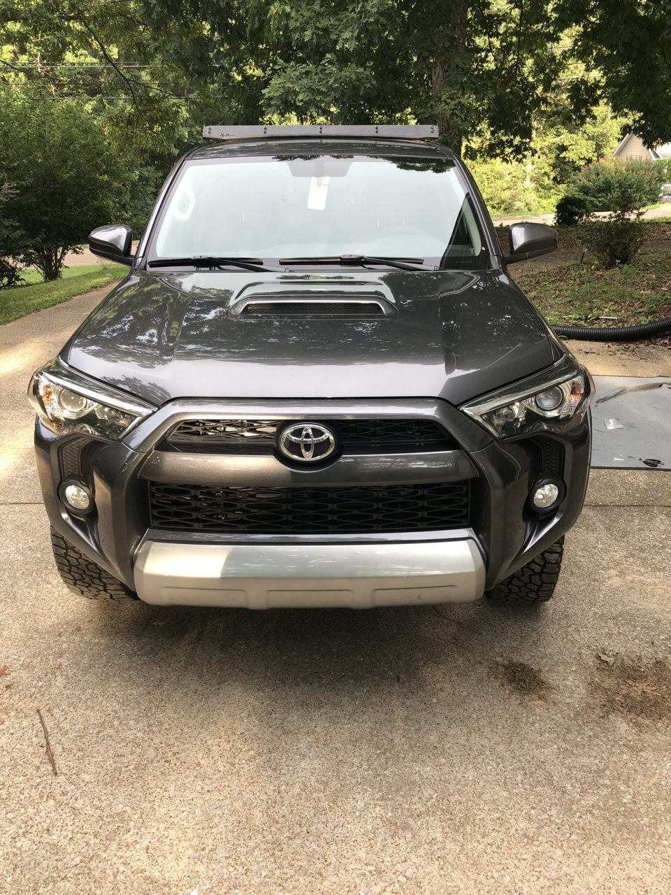

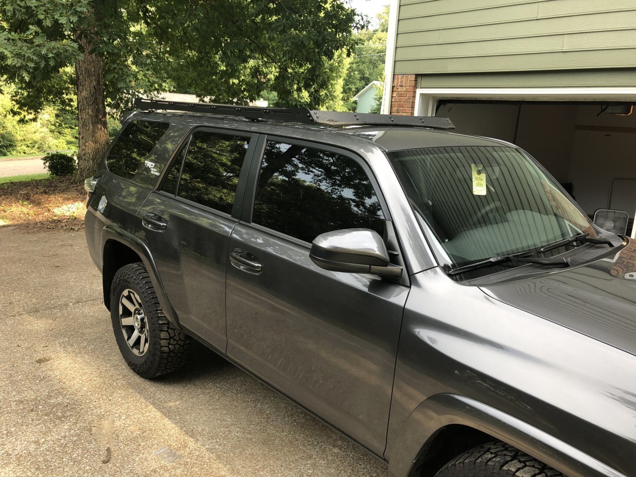

    Got it all mounted up now.

    Looks to short?

    They make 3 different sizes

    Yeah I got the 7/8 size instead of full size. Boss lady vetoed the full size.

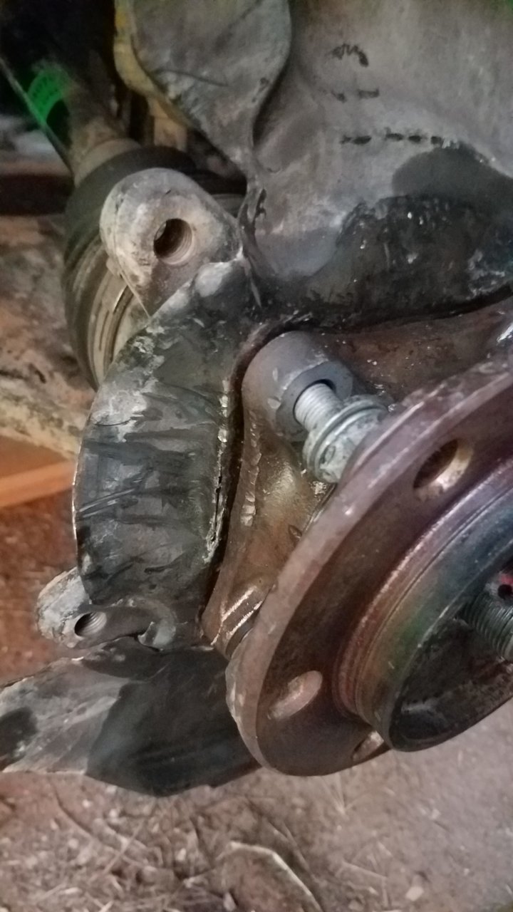

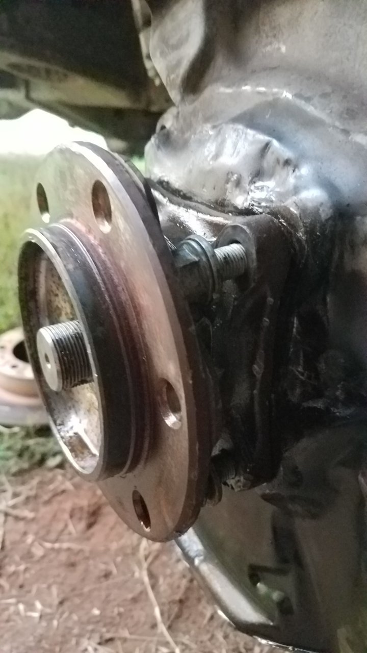

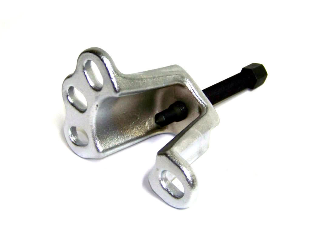

    Got home from work yesterday and attempted to replace one of my hubs "real quick". And of course the hub assembly seems to be seized onto the spindle and I worked until dark last night. Any suggestions? I'm going to torch the hell out of it I guess after soaking in WD-40. All the bolts are clear and the CV moves freely back and forth

    Turn two opposing bolts back in, add a punch or socket etc. between the head of the bolt and back of the flange, loosen the bolts to drive it free. Piece o cake :cheers:

    That's a good idea, same effect as one of these things

    That and throw out the wd-40 and grab some PB blaster. Wd-40 is for 9year olds to lube the chains on their huffys.

    I much prefer the blaster over the few things I've used. But can't beat a cut off wheel or torch
