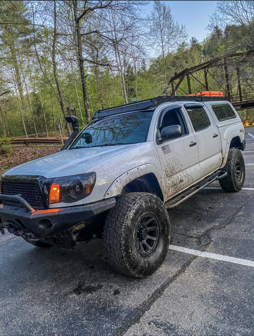

    Went for a quick trip to nemos tunnel and was not let down. The park after the tunnel was so much fun
