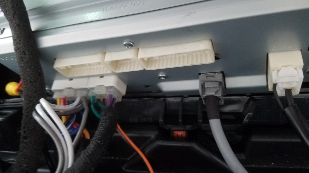

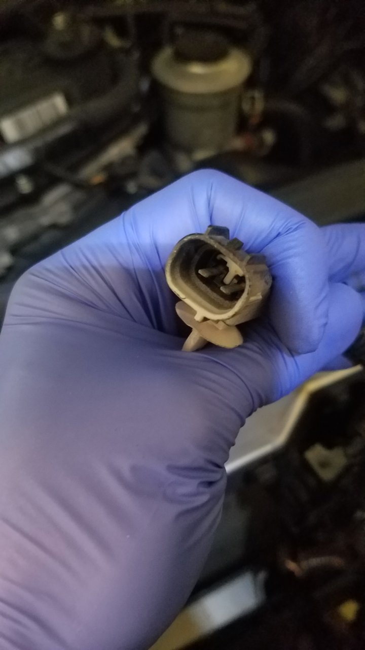

    Does anyone in the memphis area run an air on board switch, dd ss3 fogs, or a car solutions anytime camera mod? I'm having some issues, and was kinda hoping I could troubleshoot the issues with someone locally, so I can confirm if I have a hardware problem, wiring problem, or something else.

    I picked up a switch from AOB and the diagram they included is confounding me. I would assume on an 18, that I'm switched negatively and should use the bottom layout. That said, black is chassis ground. Does green go to ECU 26, and which is green/beige illumination? I know these trucks tend not to tolerate reversed polarity well.
    Next is the Fogs:
    I'm usure of the polarity of the engine bay harness. I'm connecting dd ss3 pros to the factory harness using the supplied adapters. The adapters have a positive and negative terminal marked, but will attach to the factory harness in either orientation. I'm trying to make sure I use the correct polarity when hooking them up. And speaking of harnesses, my harness on the inside of my engine bay seems to have overspray on the terminals where the fogs harness attaches. Any ideas on how to remove it before I let the body shop take a swing? They seem to break more shit than they fix.
    Last is the Car Solutions Anytime Camera mod:
    So I hooked everything up today, and I lost camera functionality all together. The radio works, but when I put the car in reverse nothing happens, nor does anything happen when switching into drive. I even tried manually engaging the camera from the steering wheel, and nothing. I put everything back to stock, and it works just fine.
    Details on my setup:
    I'm using the square natika 720p camera with the black and red power unused, and the trigger from the red D/C connector soldered to the red trigger from the yellow video wire at the camera end. White wire has been cut, and ends have been separated as to not cause a short. On the other end, I used the supplied connector to connect the red trigger from the yellow video wire to the 12+ out from the CS harness. The red wire seemed super small for the connector, so I doubled it on itself, twisted it shut, shoved it in, and then crimped the connector. After a tug, it didn't give any slack, so I assume it's a solid connection. My truck is an SR, so only the two larger connectors of the CS harness were used. I don't have a connection for the small connector.
    Does anyone have any insight wherein lies the issue? I'm assuming it's a controller problem due to no camera functionality, front or rear, but that's just my best guess.
    Any help on any of these issues would be much appreciated.

    I can only speak on the ss3’s as that is what I’m running on my 4runner... they’ll only come on one way. So hook them up and see if they come on. If not, flip the plug. It ain’t gonna hurt them to hook them up backwards for a second.

    As many issues as I'm having elsewhere, I was trying to eliminate possible troubleshooting steps if they don't turn on when I finally get them hooked up

    Are you wiring lights on fresh lines you ran or are you trying to use factory wiring from oem fog lights?
  17. Apr 28, 2020 at 9:23 PM
    tpp4
    tpp4 Well-Known Member
    Oct 11, 2019
    #307757
    269
    Memphis
    2018 DCSB SR
    I have an SR, so I'm adding the factory fog harness to run the fogs with
