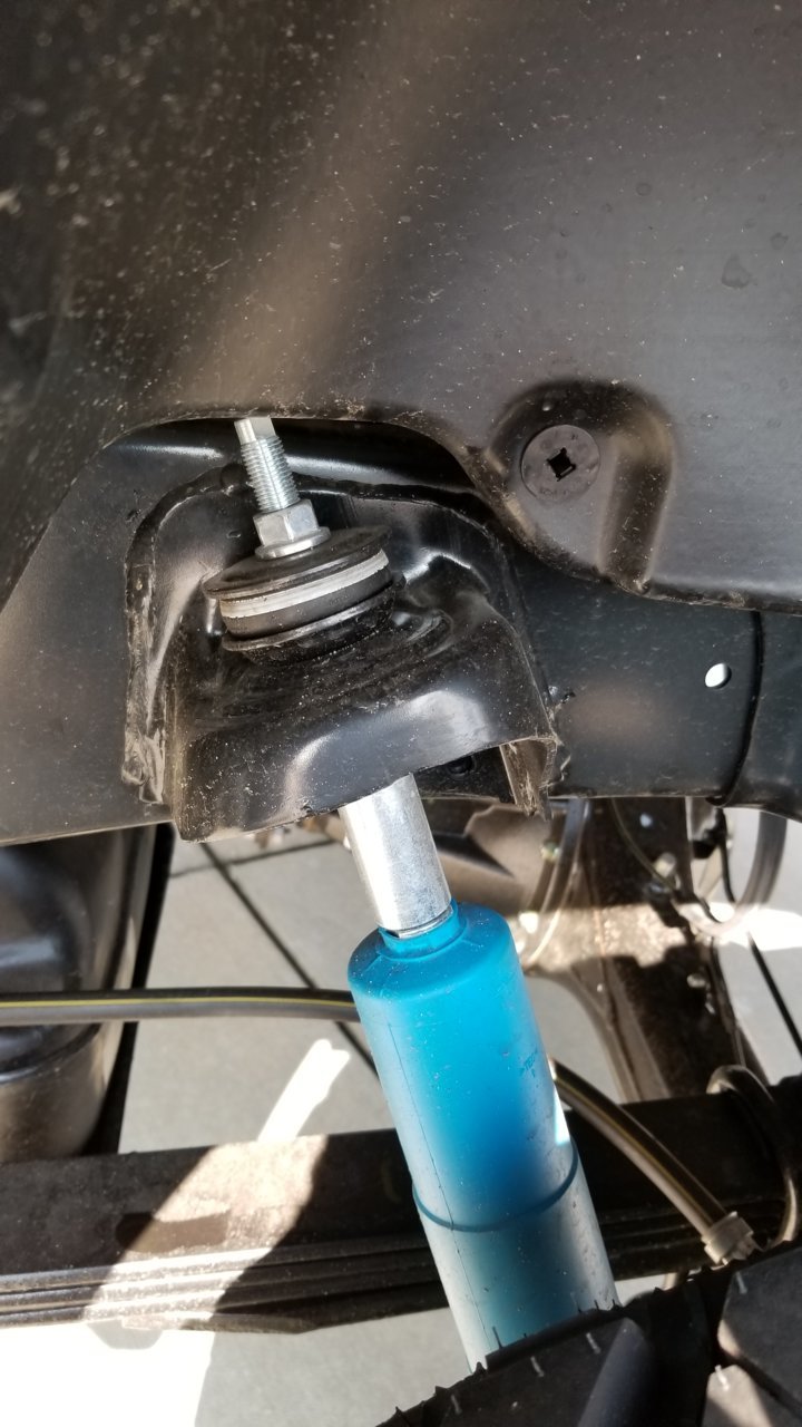

    Local dealer has a tundra with $20k added for accessories.
    *Aftermarket steel bumpers & skid. Lights are crooked in bumper and skid is a joke. Skid looks like 1/8 steel with crap welds on the mounting tabs. Tabs have no boxing or gussets. Likely fold over on first hit.
    *20" rims & 35s.
    *Big light bar.
    *Lift. (spacers/blocks)
    LOL. Parts were only about $6k from what i can tell if they paid retail.
    Spacer lift reused all oem suspension. Check out this part so they could reuse rear shock with the big block on the axle. :rofl:

    FoxShox, Dirt King Heims, Chevy63s, 2UZ-FE V8 Flowmaster 40, Demello Front/DYF Rear w/Swigouts, BAMF sliders, DYFAF
    I made some of those so I could retrofit my Bilsteins when my Fox blew out lol
