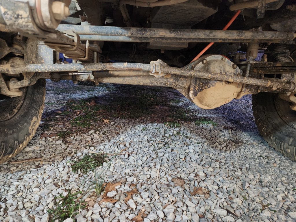

    I did check my alignment last night. I DIY though because 2 different shops here f'd up doing alignment in past. (f'd so much they should not be allowed near the machine at all)
    Camber good enough. Depends how much I want to trust harbor freight digital angle gage.
    Caster was whatever.
    Toe was out, toe-out, on both sides. By a lot. I adjusted to a slight total toe-in and it's driving fine this morning. Front tire didn't squeal around curve on exit ramp like it had before. Lol.
    I'll rotate tires again later to see if maybe there is a tire flaw causing a pull or not.
    Will also fine tune caster later. I want to move tires forward to get more clearance at body mounts.
