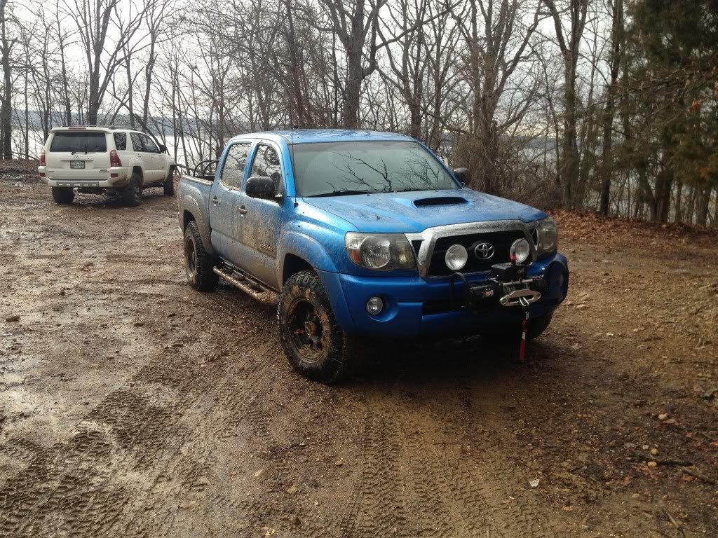

    how would you mount lights onto the front if you didnt want them behind the grill and didnt really want a bullbar or new bumper
    light wise i was thinking like hella 500's

    Like this?

    YES! how exactly did you do it and wire it

    Well my grill has honey comb on the top and bottom of the center bar and took some very large washers to mount them. But if you don't have that kind of grill you can take a 1 inch flat bar of steel and bend it to attach it to the top of the radiator support and the bottome of the grill support. Bend it to allow the lights to to mount to that with washers. As far as wiring goes just like you would do any light with a relay and a switch.

    i have the honeycomb grill on mine also, so you drilled a hole through the solid center piece or how did you attach them

    I took the mounting bolt and sandwiched the honey comb with very large washers. I'll take a pic

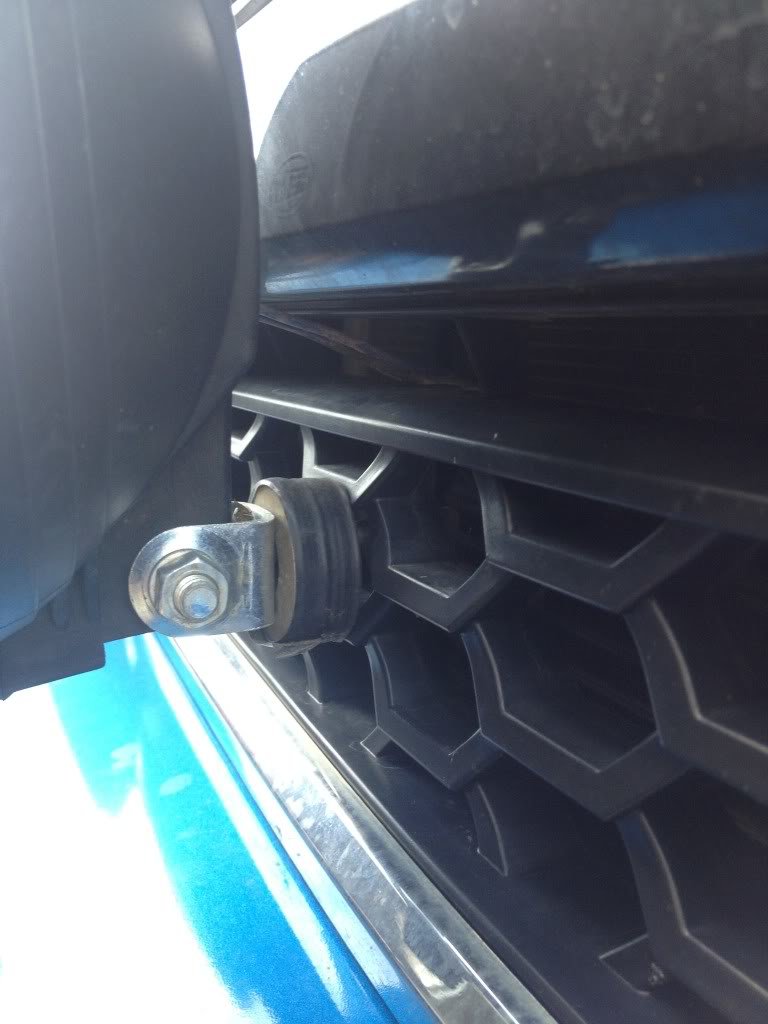

    I took a longer bolt than what came with the lights and used them. Then a stack of large washer wrapped with electrical tape to make them stand off of the grill and one on the other side. Just don't tighten then up to breaking point of the plastic. Just snug and a little more.

    AWESOME thanks so much

    is that considered a "stem" mount

    I have no idea. That's a this is how pappa Kurt is going to mount his lights kinda mount . Lol
