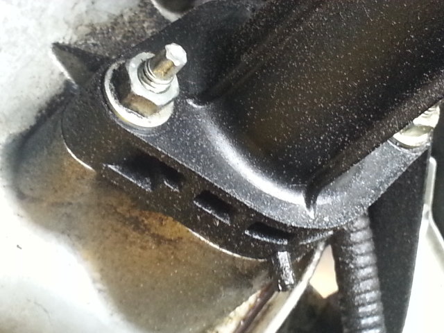

    Ok guys need a little help. Searched but cant find anything. I popped the hood to check the oil and it appearsi have oil leaking out of my filler neck at the base. Is this a known issue and what do I do to fix it? I can slighty move the filler neck around and see a slight gap under it.

    hmm. i have not read anything about that. but maybe it’s a possibility the filler neck is cracked?

    This us where its leaking

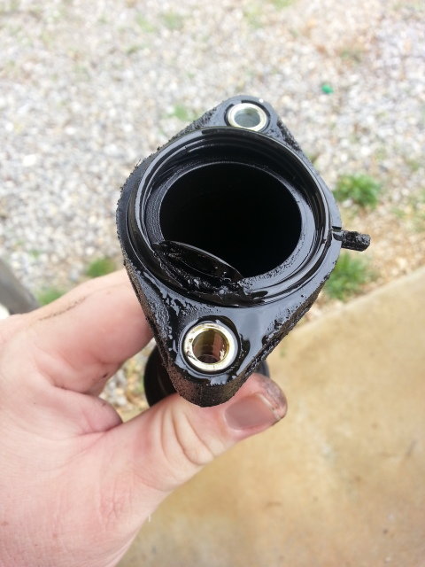

    Nevermind I found the problem 20130704_142514_zps6183dd61_2de62af494100cdfdfea38b872e8f30bf094db3e.jpg

    hm. and what is it? a messed up seal?

    The o ring has blown out it appears. Probably someone prior pulled it didn't seat it properly and over tightened is my guess. Why they would have removed is beyond me but some people just don't get it. But at least its not timing cover or anything else like that

    Oh ok. Ya dont sound major at all. Thats a good thing.
