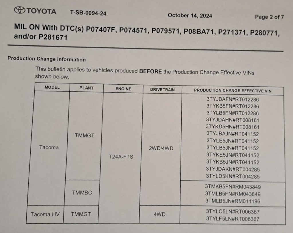

    Newbie here.. can someone please explain if my truck is affected I’m confused how to tell by the vin number. Any guidance will be much appreciated.
    TYLB5JN2RT037449 The build date I believe it says 06/24 not exactly sure about the date. So far I haven’t had any issues

    Yes your truck is on the list

    Can you explain how you know ?

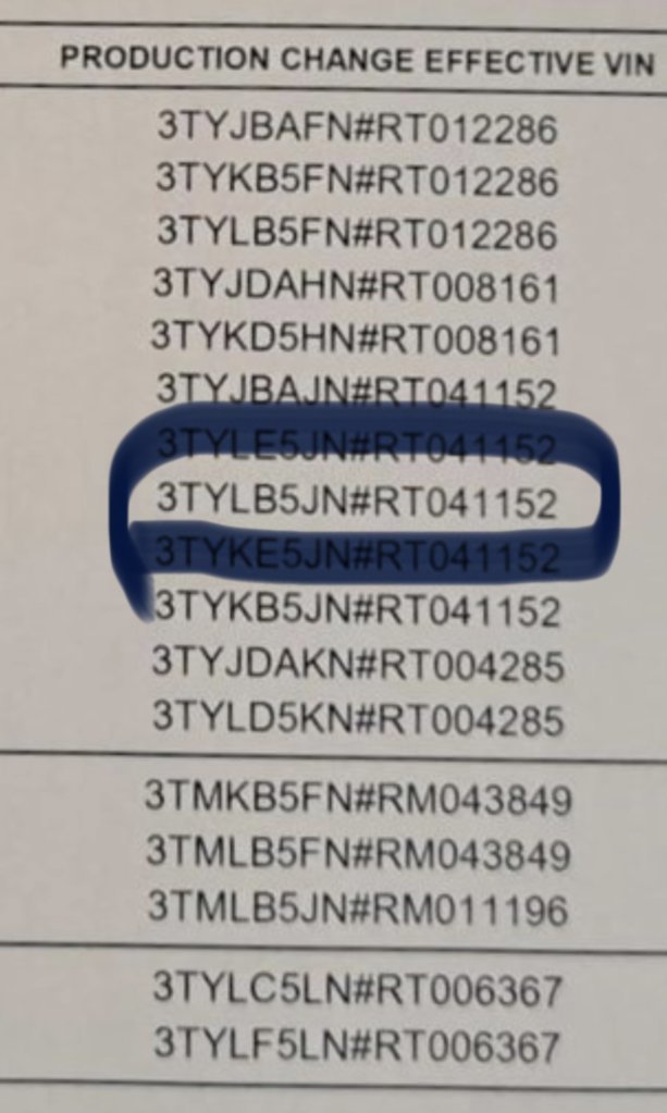

    you just match up the leading characters of your VIN to the corresponding leading characters in the list and see if your numbers at the end are lower - takes maybe 10 seconds

    Your 037449 number is lower than the 041152 number - so you’re in

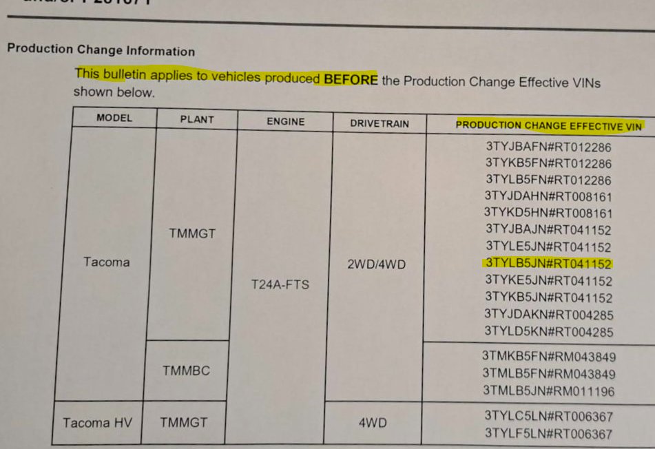

    Yours is lower that the one highlighted....therefor it was made prior to the change taking place.

    Your number is less than 41152 which are the last numbers in your VIN. The 41152 indicate the serial number and the numbers and letters that proceed the 41152 detail what and where it was built.

    So I am in for a new trans if mine fails?
    3TMLB5JN7RM024451
    and if I am in does that mean I just go to toyota and get it repaired?

    You are not in the the ones being part of the TSB,pretty easy to check the chart yourself

    I did check the chart forgot to pay attention to the JN versus FN
