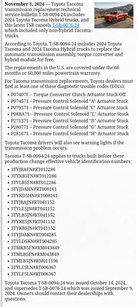

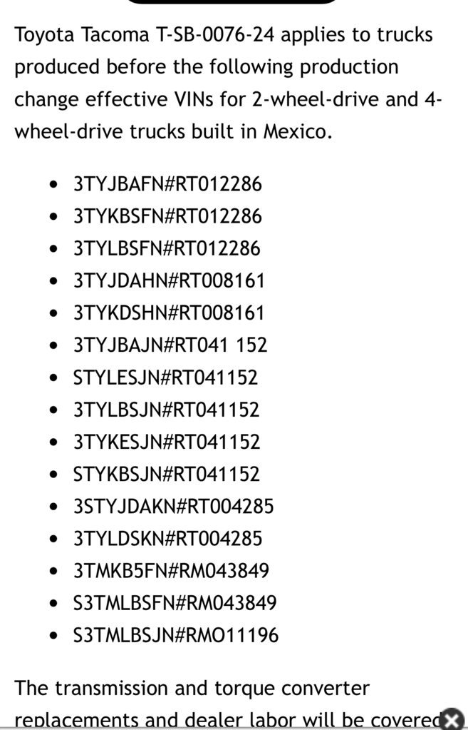

    In case the list of affected VINs hasn’t been posted in this thread for a while, the VINs with the last 5 digits after these were made after the issue was corrected, and are not affected
    Mine is in the list of affected, but not all owners are having the issue. It’s my opinion they should just do preemptive replacements free of cost for owners’ peace of mind, given how much they’ve paid for theseIMG_6597.jpg

    99, 24
    For what it’s worth, whatever translation/optical character recognition was used to extract those numbers failed a bit. Turning 5s in to Ss etc

    21 SUPER WHITE TRD OR 4X4 , 24 BCM TRD OR
    this list doesn't include the hybrids, did they get cleared?

    24 TRD OR Hybrid Bronze Oxide
    The previously referenced TSB was superseded by T-SB-0094-24 which includes the hybrids.
