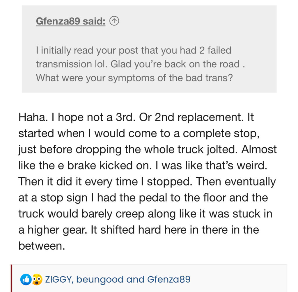

    Curious what early warning signs are. Sometimes my truck, especially in idle when I’m about to move forward, kind of has a jumpy feeling in the transmission. Hard to describe. Nothing that bothers me other than now I’m paranoid it’s a sign.
    Gfenza89[OP] likes this.

    Let me know if you ever get a shudder or vibration when moving slow in stop and go traffic when accelerating slowly or coming to a stop

    Yes. It’s super minor. But yes. I’d like to know if that’s an issue or normal …?
