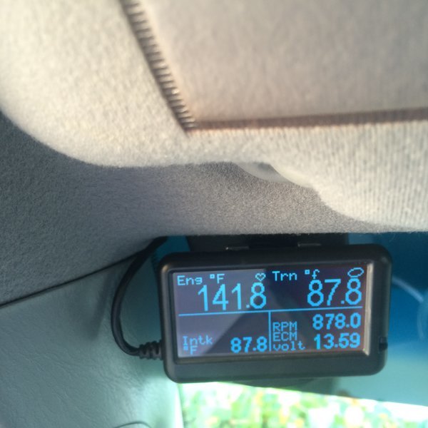

    image.jpg Forgot to post after I mounted the gauge. Decided to put up on the windshield. It's a cool gadget!
