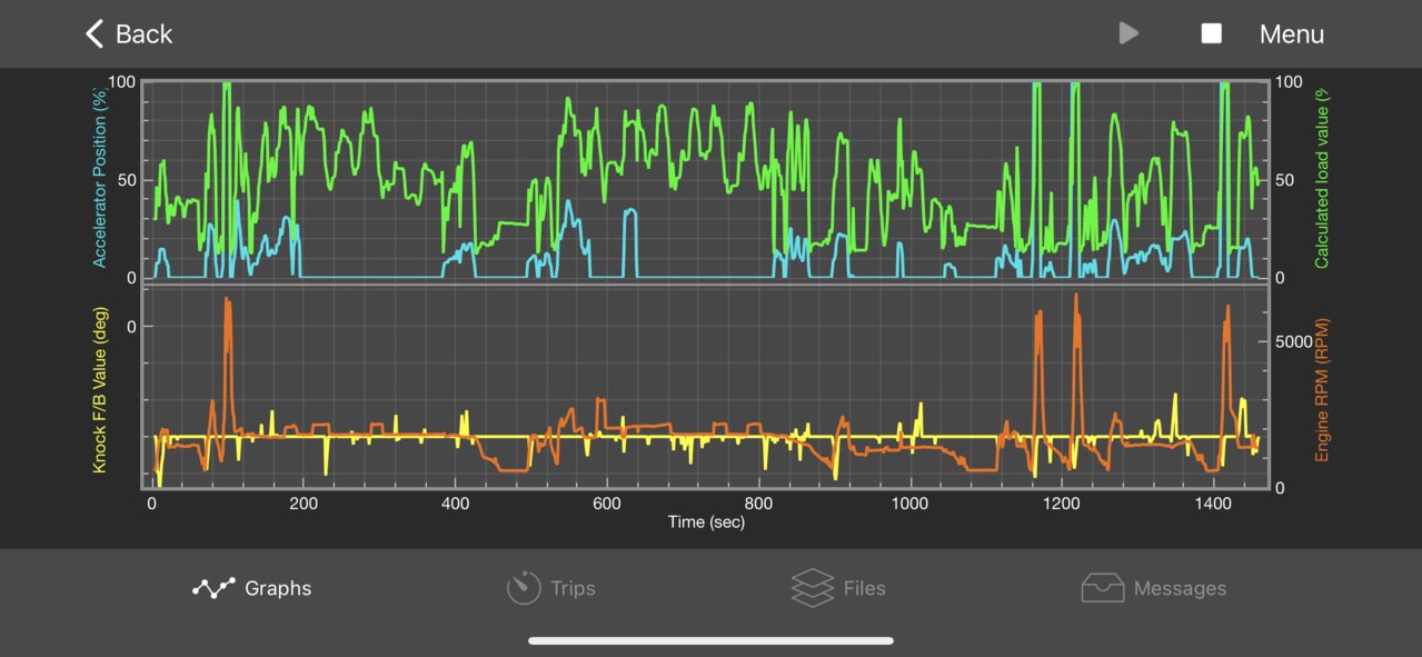

  16. Apr 30, 2021 at 5:28 PM
    #216
    TermLimits
    TermLimits [OP] Owner of Valley Tuning
    Feb 5, 2021
    #355189
    514
    Jeff
    Cleveland, Ohio
    2016 QuickSand Tacoma TRD OR
    ValleyTune.com Current Tunes: Valley Runner
    I monitor "Knock F/B Value (deg)" as it provides more detail to me in seeing which engine loads produce the knocks.
    Acceptable ranges for this value are -5 to +5, I've only once seen a positive number register in early testing.
    On VR 2.0.3 I'm keeping the truck at -3 for idle and sub 43% load, very steady. When accelerating hard, knock values will dip to -3.5 to -4. A sudden reduction in engine load such as accelerating hard and letting off the pedal will result in -5 to -6 knock value. The out of range values occur in every tune even factory, this is a lean knock due to the delay in throttle body closing. Essentially the engine brings in the air to keep accelerating, but for one cycle it injects less fuel and uses the residual airload, resulting in a split second lean value.
    In experimental files for midgrade, I'm staying steady between 0 and -4. I'm to the point where I'm chasing a specific range of load values which produce the -4. The obsession goal is to have a smooth, zero knock value.
    This log has multiple 0-60 runs I performed during additional testing

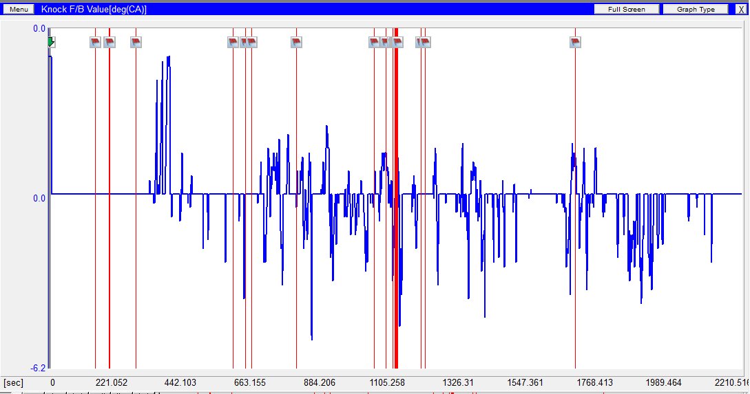

  20. Apr 30, 2021 at 6:09 PM
    #220
    Vlady
    Vlady Well-Known Member
    Dec 20, 2017
    #238986
    4,700
    Issy, WA
    2017 White SR5 DCSB V6 4x4
    I've been accumulating TS log files since 1.05 and seeing -5 -6 values was pretty common, especially on upshifts or downshifts to 4th. What is your KCLV now? 1.05 log below
