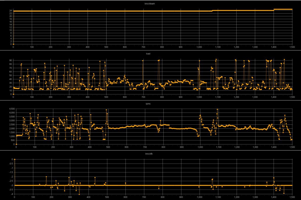

    I didn’t have a 2.0.3 log so I went out and got one for y’all.
    Finishing a tank of mid grade right now.
    KCLV stays locked at 24-24.5 the entire time. Knock F/B stays very smooth and consistent across the board.
    Mix of some highway, some stop and go, few harder access, floored it once or twice in the logs.
    Posted chronologically:
    Crossing headwinds in the hills tonight. Could be a bit better of a run
    Knock values are my personal mission
  4. Apr 30, 2021 at 9:16 PM
    #224
    Vlady
    Vlady Well-Known Member
    Dec 20, 2017
    #238986
    4,698
    Issy, WA
    2017 White SR5 DCSB V6 4x4
    Do you think there are parameters available in vF to achieve this?
    Interested to see the progress...

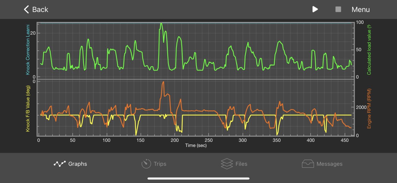

    I asked because I've been doing the same.
    Eliminating the heavy -6 and-7s helped smooth acceleration a ton.
    The reason i asked what your learned was, is when i started on the low knock it started creeping into a higher learned value when then transitioned into the high knock tables.
    Now i only have heavy spikes in the mid to high load at low to mid rpm and the truck is targeting the base table.
    Morning when air temp is around 45
    Afternoon when around 80 air temp
