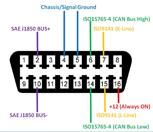

    *** Important Request ***
    I have a request for you guys and gals.
    When you get the chance could you send me a photo of your OBD port? I need to see what year trucks have the appropriate wires hooked into it for ECU swaps. Some users have reported the absence of a chassis ground in newer models.
    Specifically needing to see if Pin 4 and Pin 13 have silver connectors inside your OBD port. Without it then we will need to look into an alternative method for completing ECU handshake procedures for those who may want pre-programmed ECUs or backup computers.
