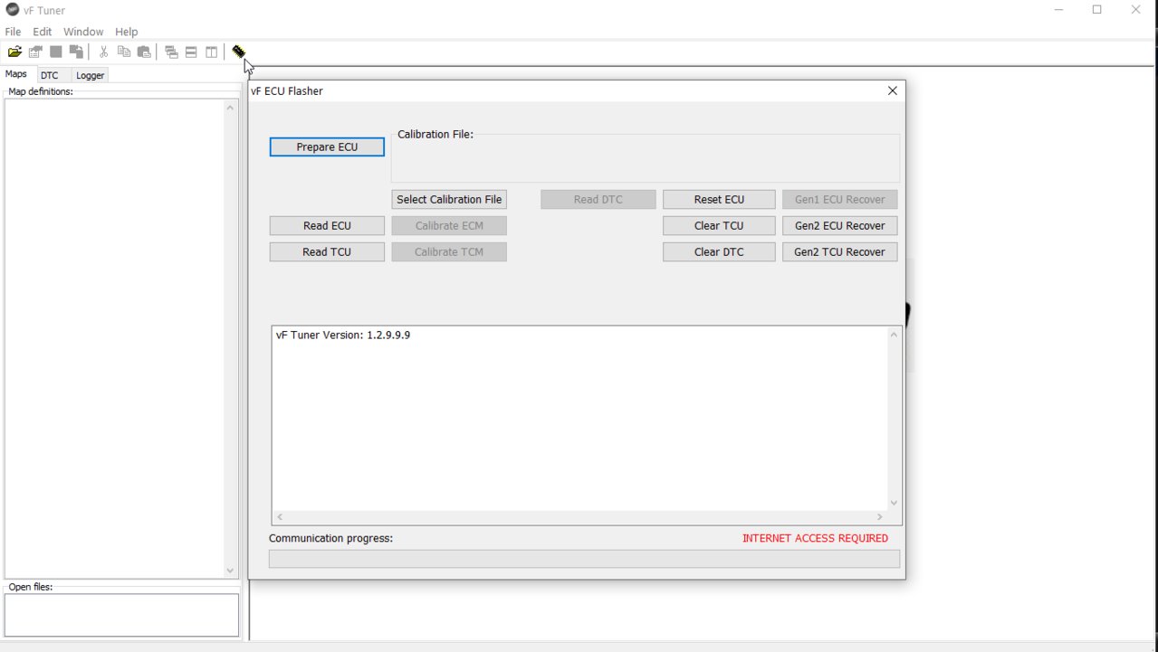

    #315
    T-yoda
    T-yoda Well-Known Member
    Sep 16, 2020
    #341021
    3,440
    Dave
    Eastern pa
    17 TRDORDCLB mgm
    265-75-16 BFG AT, firestone riderites
    I can say that the truck will stay in 5th on the interstate up an incline as if you almost have to make it go to 4th. The shifting that this truck used to do has greatly been reduced. :thumbsup:
  16. Jun 7, 2021 at 2:39 AM
    #316
    Hatfieco05
    Hatfieco05 Well-Known Member
    May 1, 2016
    #185820
    181
    Portland, OR
    2020 DCLB TRD Off-Road Premium
    It cruises really nicely. I really like how it will kick down if you gently apply throttle, other tunes I have tried required a healthy dose of throttle to kick down and actually held 5th/6th too long before kicking down to pass and such.
  17. Jun 7, 2021 at 7:01 AM
    #317
    mackdave
    mackdave Active Member
    Jul 3, 2018
    #258206
    37
    2019 TRD OR QS
    2" bilstein lift, custom grill, ditch lights, fog lights, light bar, rear work light, switch pros, remote start, kicker speaker upgrade, alpine amp, raptor lights, carbon fiber dash trim wrap, OVTUNED, Method MR315, Falkin wildpeaks, MESO 3rd Brake, Meso puddle lights
    Just bought your tune. What’s the difference between soft and regular pedal? And how do you install in Vftuner? It says file locked
    TermLimits[OP] likes this.
  18. Jun 7, 2021 at 8:55 AM
    #318
    C41n
    C41n KDMax Pro Authorized Tuner | Portland, OR
    Jul 24, 2019
    #300113
    1,237
    Anthony
    Portland, OR
    2020 DCSB OR MT
    You are trying to open the tune to edit it. You want to hit the little circuit chip icon shown in this screenshot where my cursor is. Then you will see the box below it open.
    Then hit prepare ECU (not read ecu)
    Select Calibration File
    Calibrate ECM
    Before all of that you may need to update your ECU ID with techstream.
    See this thread for more information if you still need help with the flash.
    Most people are happy with the regular pedal file. If you find the pedal is too touchy, then try the light file.

  20. Jun 7, 2021 at 9:27 AM
    #320
    mackdave
    Jul 3, 2018
    #258206
    37
    2019 TRD OR QS
    Thanks I already updated ecu id to b033 from 30. Thanks
