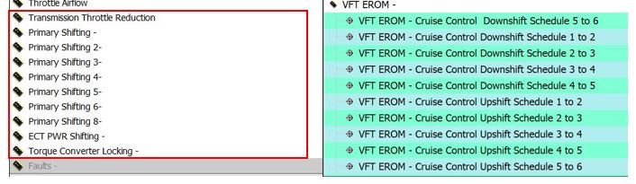

    How are you modifying Radar CC? Looks like there is nothing in 1.3.0, and hearing there is nothing in Pro to modify those maps.
    Or are you saying Radar CC and regular CC work as stock on the VR tunes?

    It works the same as stock with adjusted shift points and targets through the pro software. We can’t change anything with radar. Although it would be great if one car length could actually be a car length and not a semi…

    I'm confused, you must have a special Pro license. Unless shift maps 2-8 adjust adaptive CC, there is nothing there to adjust relative to radar cruise.

    Cruise control shift points are referenced on the same maps for radar and non radar cruise? These are the maps at the very top of the program when opened.
    Ive never had anyone with radar cruise not experience shift point changes while using the tune.
    From my understanding, all the radar trucks have over regular is the automated braking and lane keep. Besides that, the cruise is the same

    In my testing, along with many others, changing any of the maps below {left) has no effect on Adaptive CC. It drives as stock. To my knowledge, there are no other shift maps available in Pro then what's shown below. There were some CC patches that vF had in earlier versions of vF that seemed to help normal CC, but nothing to date has worked on radar CC. Those regular CC patches seem to be missing in 1.3.0 also.
    Image below shows the only maps (VFT EROM) I've ever been able to modify regular CC with and they haven't been in vF for several releases. Maps on the left available now do nothing for CC. What are you changing to get CC to shift different than stock?

    The EROM Cruise shift maps have worked for changing shift points in cruise for me. Pro has a few additional maps for cruise control which have to do with input and output shaft speeds and some other specifics related to transmission.
    Unless those who have radar cruise have never reported issues or simply not cared, to my knowledge all cruise shift point changes in VR have taken effect on trucks. I’ve even managed to get my truck to shift WAY too soon in cruise (granted I don’t have radar but some of my testers do)

    I think you might need more testing for radar CC. Nothing has worked to date to adjust those shift points in my and others testing. Are you seeing the EROM stuff in 1.3.0 Pro?

    I’ve had them since 1.2.9.9.7 pro.
    Idk have yet to be told anything by any radar cruise trucks. If they report anything odd back to me I’ll definitely make any changes to remedy like usual.
