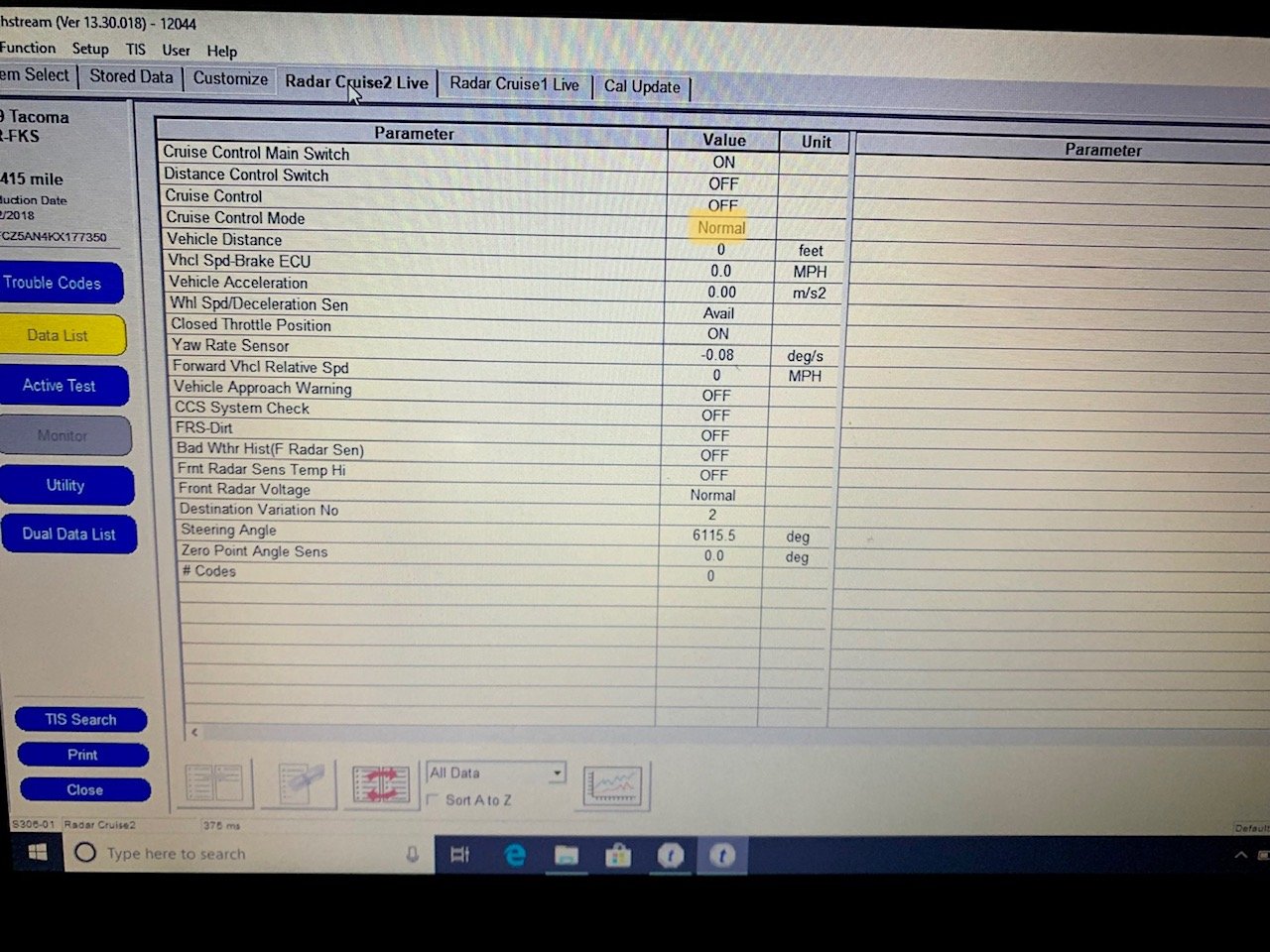

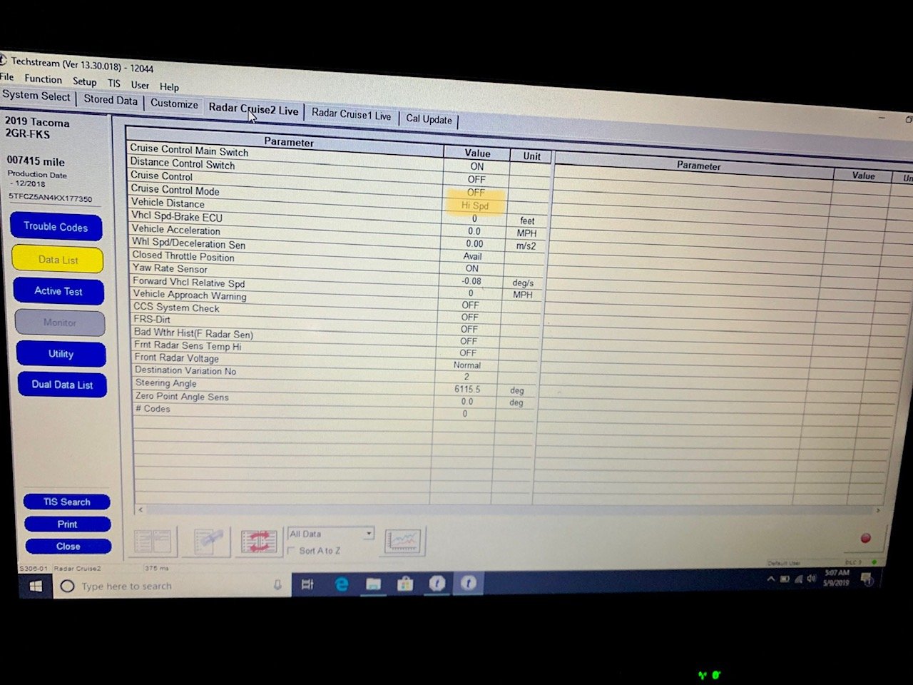

    I talked to Jeff about this in depth tonight. Adaptive cruise control isn’t probably going to be supported unless we make another stink about it.
    I sent these pictures to mat 2 years about when discussing the adaptive cruise issue.
    Regular cruise recovery speed is normal
    Adaptive cruise recovery speed is hi speed
    5F86B9B0-CD67-4C1C-AF68-D00E997EA241.jpg ACD35A60-DA38-48C8-9AC4-D737DA4A8174.jpg

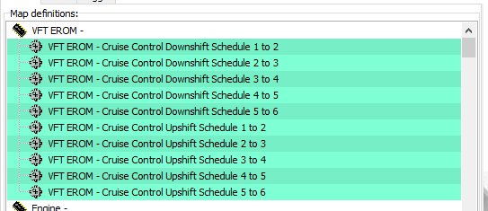

    Been pouring over the files in 1.3 tonight. I’m seeing a huge inconsistency in EROM maps across different ECU’s.
    04B04 has tons, but I also unlocked the test file a while back so maybe that opens them?
    04A61 only has EROM upshift, downshift
    04B33 has more than A61, but less than B04,
    04B81 only has EROM upshift, downshift
    04C20 and 04C21 have no EROM maps at all.
    Not sure how any tuner is supposed to make consistent tunes across multiple ECU’s with this much variability in map access with stock files.
    I’m also on peasant vF. Maybe Pro doesn’t have the same inconsistency.

    I've not seen those CC EROM's for 04C20 and 04C21 2021 ECU's in vF. Does vF Pro have them? Other pro tuners have sent me screen shots showing the EROM's are missing for all those maps in Pro as well. I'm really looking for a reason to go pro, and CC might be it. Without those EROM's, not sure how CC can be "tuned".

    My pro link does not have 1.3 attached to it it seems. I only have the download for pro 1.2.9.9 at this time.
    I'm wondering if anyone else with the Pro software has been able to get 1.3 yet? If so then I'll definitely need to ask Mat to update my link.
    Here is a list of what 04B04 has for cruise settings in pro

    Those are in Reg also. What I'm saying is other ECU's, 04C20 and 04C21 for example don't have them, so how do you tune CC if that ECU doesn't have them? So the post above from the 2021 owner with CC not working well can be explained that way. Maps are not yet available for all ECU's, but vF is working on it. Post same screen from 04C20.

    Yea 2021 is the only trucks who don't yet have CC maps which is odd but thats a VFTune software update.
    Some ECU IDs like you said do not have all the cruise maps available yet either. Eventually I hope this is uniform across the board.
    Until then the only cruise edits we are able to make are to the cruise shift points, however Radar cruise will not reference them. If you activate cruise but NOT adaptive mode, it references them. @uploadadventure and I have discussed this in great detail last night.
    I'm fairly certain that the adaptive settings for hi-speed vs normal as he mentioned above is a simple 0/1 value map within the ECU files. But until Mat and his developer's find which one it is, we are stuck with it.
