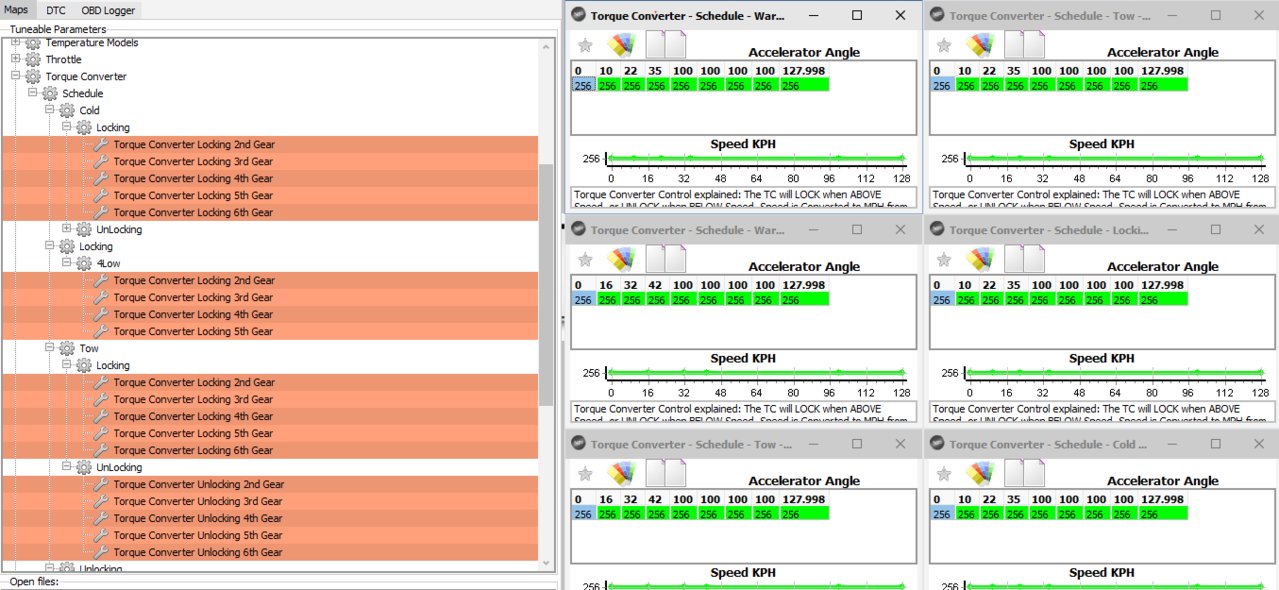

    I was not able to locate TC locking/unlocking S1,S2,S3 maps on 1.5 under all user levels.
    Do you see them? Thanks.

    They are renamed I believe. We will need to open the maps one by one, click the blue I info icon, and look at the mapID.
    The v1.5 update brought plenty of good features but at the same time it brought a new learning curve to it.
    Really wish we had that New ECU Tool :bananadead:

    I did look through every TC lock table under the sun. Still unable to locate. If you find, let me know. I had a distinct map for 3rd and now unable to modify. Thanks.
