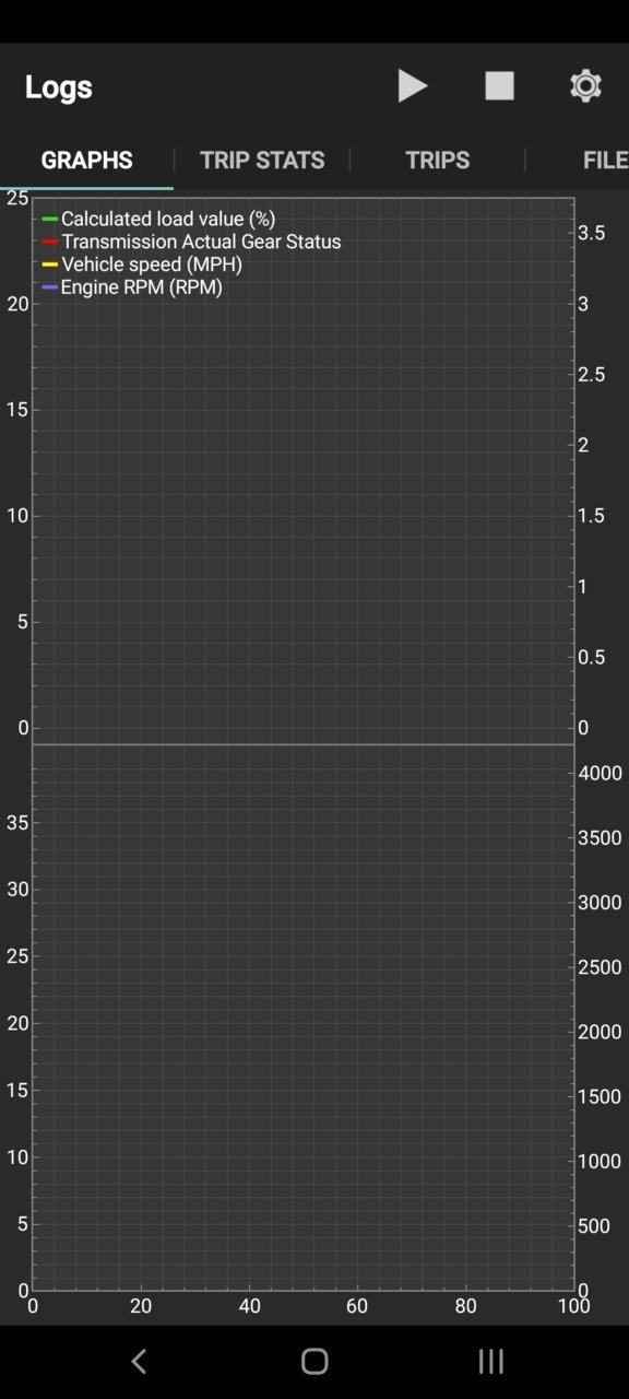

    Ok I'll get my logger set up for that I'm pist we have to work tomorrow ahhhhh lol overtime all night

    Yep that is good for it.
    I personally stack mph and current transmission gear with that graph. This way you can see the load percent climb as the truck reaches an incline. It'll hit a threshold of load before downshifting to maintain the mph. Once the load percent drops below another acceptable value, the truck will reduce throttle and upshift. Its a nice visualization of the inner workings of cruise control logic.
    Unfortunately we do not have the ability to edit the background logic beyond shift points at this time.
    Example, when the truck is in 3rd still at 27mph under light throttle. You're still pulling 20+ mpg flat and 18+ on an incline. It is all in the afr, timing, torque models, and atkinson comps.

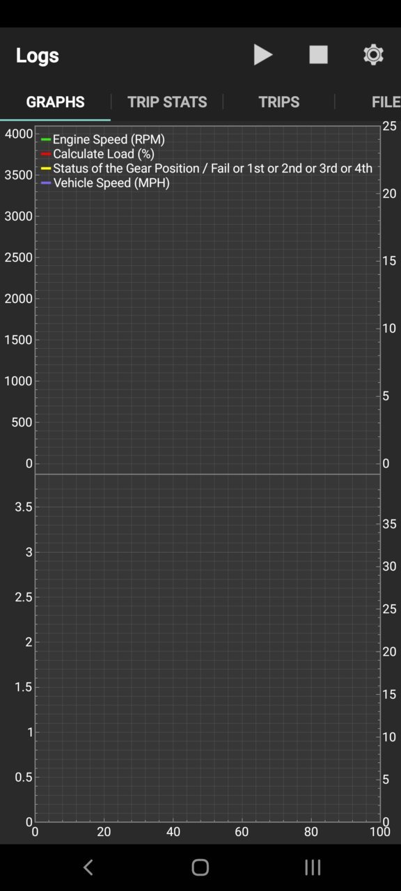

    standard SAE PID transmission status will show the current gear better

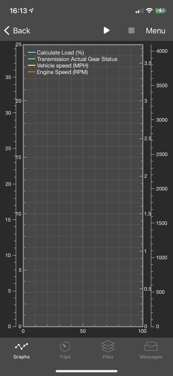

    If I keep it the same as your I would think it would be better for you to help you. @TermLimits

    As far as logging goes I'm pretty much done with all the testing and getting the tune going.
    The only focus of logs from here out is to expand upon the mpg savings and truck's ability to hold the gears in hills.
    I'll work on a gear lock version in the future but right now the focus is on ECU expansion.
