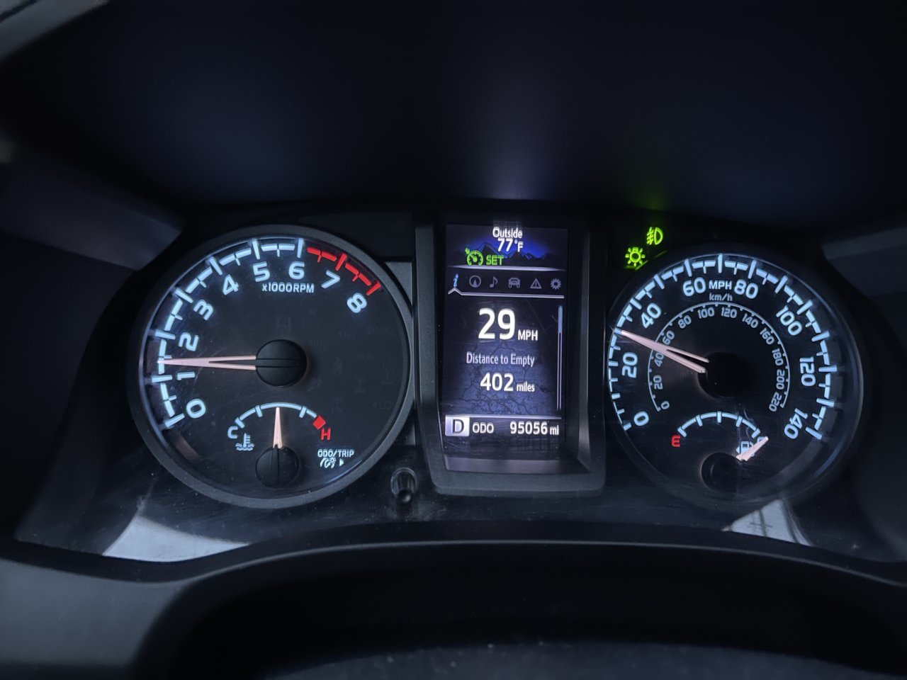

    @shotgunbilly420
    400+ miles to empty is possible. Noticed this when I got into the neighborhood, add 12miles for the trip I drove from the station.
    Also, I just crossed the 15k miles of tune development stage. Long time driving around and editing

    So that photo was following two tanks of 30/70 city highway. I'm looking into finding a place that can perform a dyno but also allow me to run an extended dyno similar to how the EPA runs their testing.
    I know Mustang Dyno is headquartered down the road from me, they produce the only dynos that can provide a full simulation of road force and friction. This should be able to give me the most accurate WHP & WTQ numbers along with an lab controlled MPG.
