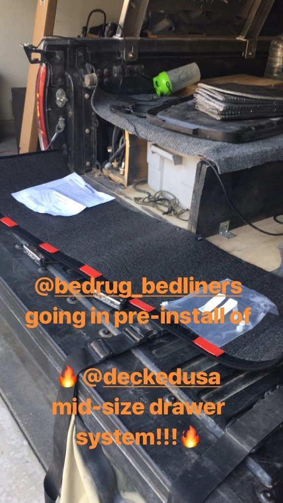

    UPDATE 10/11/2017:
    Added a Bedrug to the tailgate. *Not necessary for any install process of the DECKED system but I wanted a softer surface to “Deckgate” on!:headbang:554C28D0-5FEA-449F-B63A-641C77F323C7.jpg

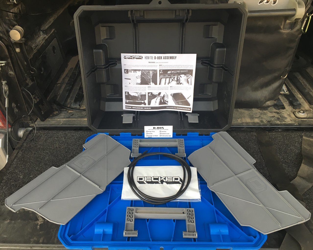

    D-BOX ASSEMBLY
    *note - the D-Box arrived clean and in brand new condition. I trailed the Mojave Road with it so it’s dusty in the pics. It’s a wonder anything in my life stays clean :)
    It arrived well-packaged/protected direct from DECKED.
    All pieces arrived intact with with box. Install instructions were straight forward and easy to follow.
    Thanks to trail dust, I was able to appreciate more the fact that these are MADE IN THE U.S.A.
    I would liked to have seen not only an SAE panel, but metric as well. Heck, DECKED probably could just place 4 x 10mm spots on the lid and it would work just as well for us!:rofl:

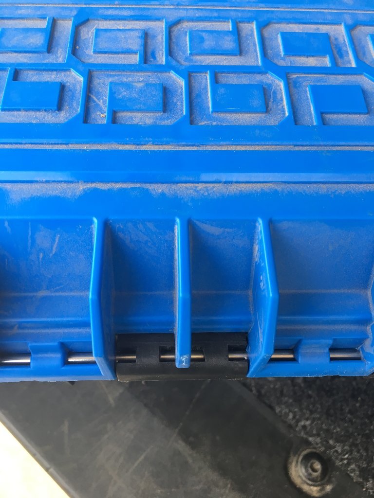

    Step one: insert the rods in the hinges.
    They should not have any space between them as they meet in the center of the box.

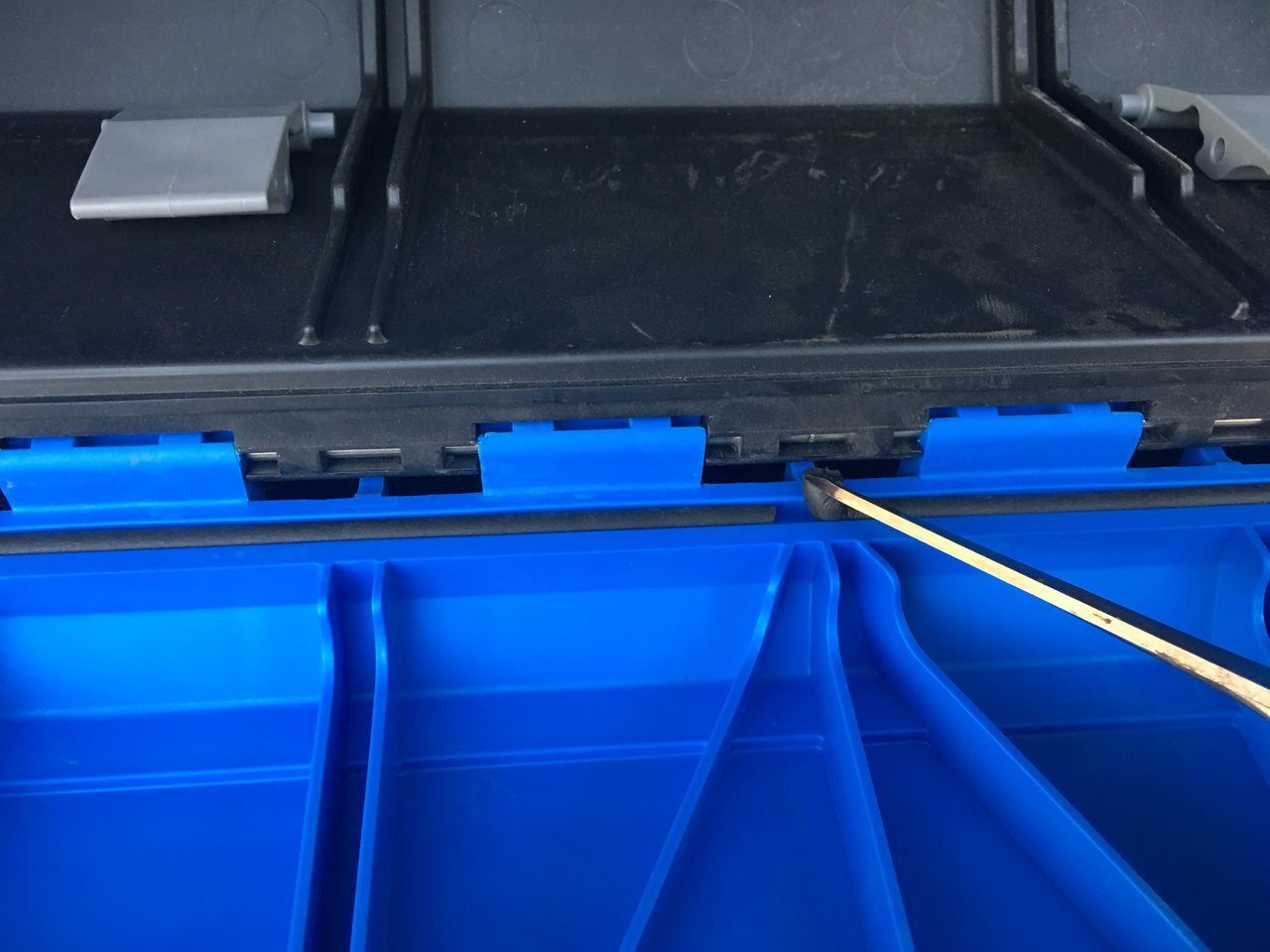

    Step two: Flip the box upside down, insert the gasket around the perimeter of the lid. Nothing complicated here. Just start at the middle back and be prepared to leave a 1” gap in the center.
    I ran it all the way around and pulled back the excess, trimmed so ther was a 1” gap as per instructions.
    Measure twice, cut once. Screw it! I’m living on the edge with a 3/4” gap. Haha

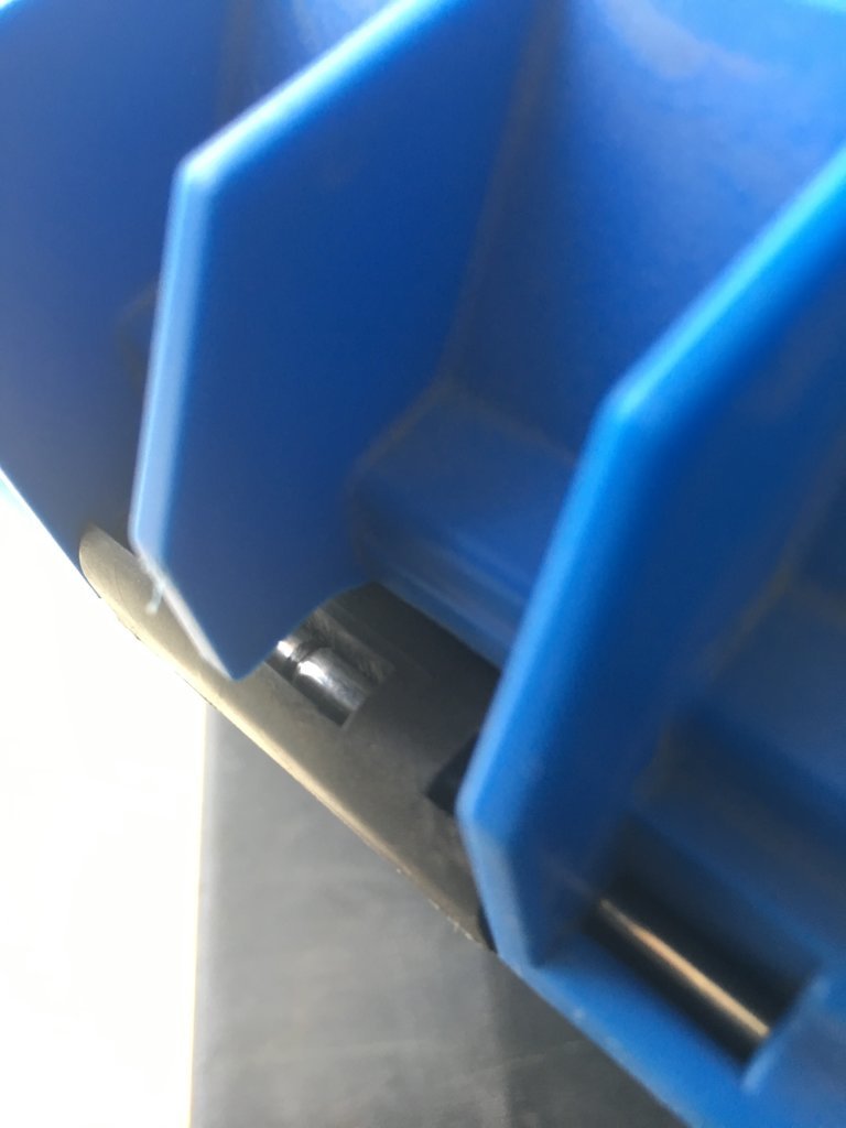

    Step 4: Latches
    ***This is one place that I think needs revision. There is NOT enough material to keep the latch in the lid when side pressure is applied. It literally flew off when pressure was applied to the side where my thumb is. I have emailed video of this to our DECKED contact.
    In normal up/down operations, it was flawless. Note that pressure should be applied to the center bend in the latch to get it to engage. This is very similar to the Frontrunner box latches which you all may be familiar with.
    I did find the divots located here at my index finger to be very helpful to the locking operation of the latches.

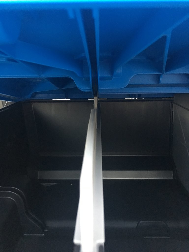

    The tops of the dividers are easily unseated with a medium amount of pressure on the top-most portion. The divider itself remained seated in the section. I would say just don’t overload the top portion of the divider.
    The lid has a receiver mold that works perfectly with the divider. If the divider becomes misshapen for some reason, the divider may not seat properly in the lid and could potentially cause it to not close properly. **This has not occurred in the multiple open/close testing I did with the D-Box itself in various positions.
    Dividers:
    You can’t insert them wrong. It’s impossible to even seat the divider if it’s in the wrong position.
    They fit my socket organizers perfectly! The socket organizers are 17.5” long.
    One thing I found interesting...
    The D-Box has two vertical spaces for the two corresponding dividers that it comes with. It seems as thought there should be one that can be installed in the horizontal mold (wider side). It would be handy to have a horizontal divider for my socket sticks or longer tools like a hammer or hatchet. Maybe @TheDECKEDGuy can help address this?

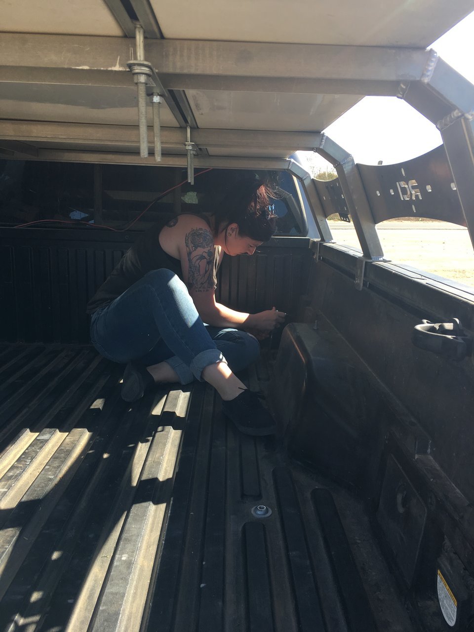

    2. INSTALLATION:
      This was done quickly and efficiently while employing friends to tackle the various yoga poses required to install the DECKED in my truck – I have a mid-level bed rack to contend with. Thank goodness for friends!! @YotaGurlIAm and @eccracer104 3E90703F-8C3E-44DA-AA19-C36945CD1868.jpg A4D0E8B4-49C1-44C2-930D-B072A8218FEC.jpg As stated by DECKED instructions, you definitely need 2 people…no skimping there.
      Impression: Lengthy, but completely doable with a second person.

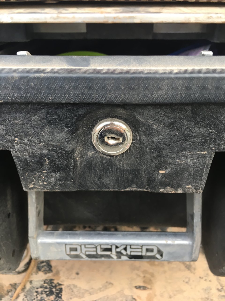

    6. Drawer Handles: My set came with the handles already installed in the two drawers, so I won’t be able to review the installation process of those. The quality is of heavy-duty, solid material (cast aluminum) which feels indestructible.

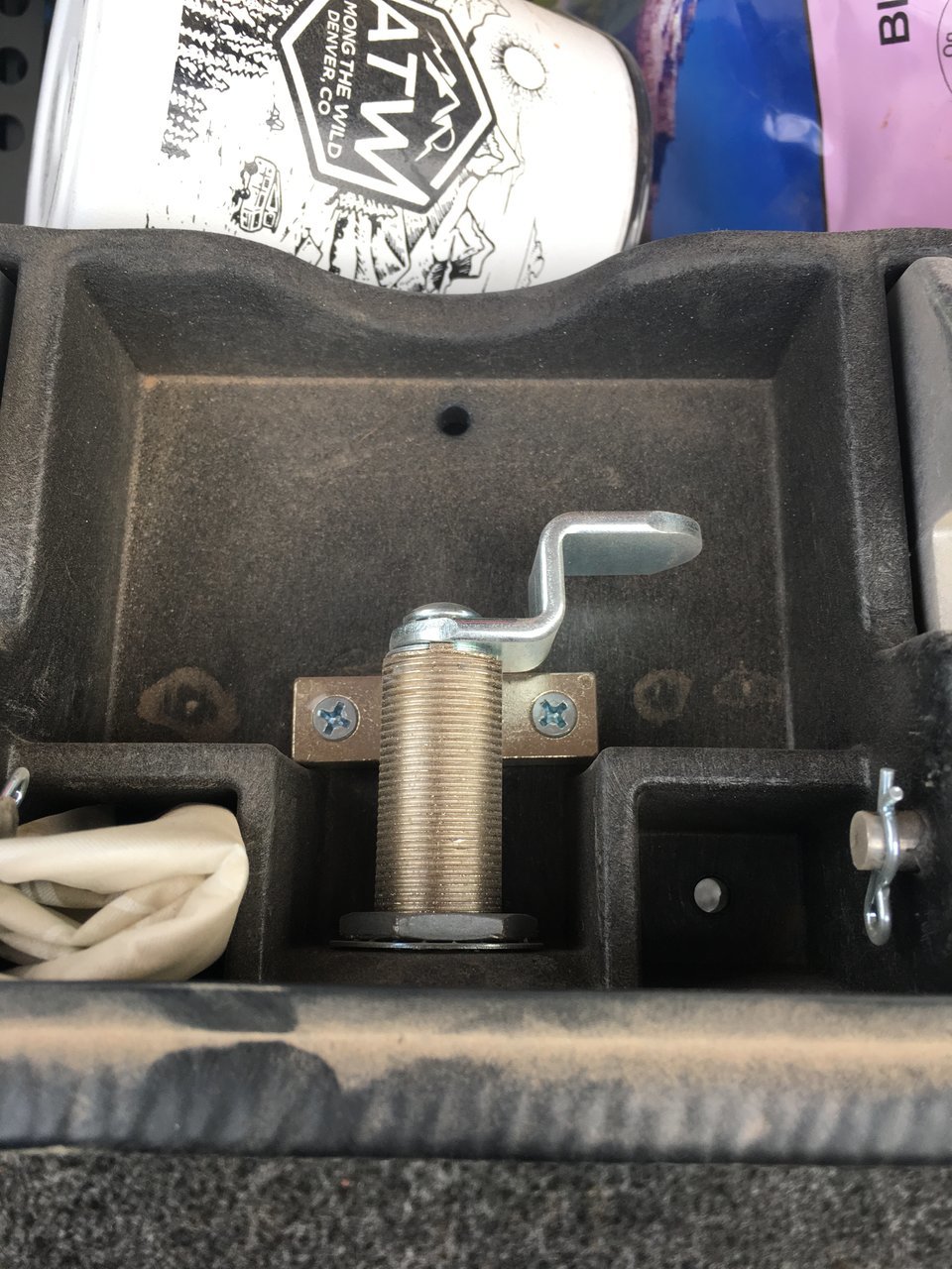

    7. Locks: I ordered a set of locks ahead of the delivery of the system. I’ve never installed a lock of this type before but the instructions included with them was very simple to follow and provided tips to grasping the smaller pieces, which I found to be very helpful. The keys were obviously a new cut and were very rigid in the lock. After about 5 uses, they smoothed out and are very easy to use now. The DECKED drawers land in the long bed with approximately 6 inches to spare between the DECKED top and the tailgate. 1D288731-FDCB-4882-90E0-27EB5A837209.jpg Without the locks installed, I was able to reach in and open the drawers. This allowed access to about the first 5 inches of drawer storage. 7E3CD636-A84B-4DE5-A77D-D6C54FE66BD4.jpg I would highly recommend installing the lock cores to keep sticky hands away from your gear. I also have the tailgate lock which lends to another level of security. Link to the LOCKS: https://decked.com/products/ad1

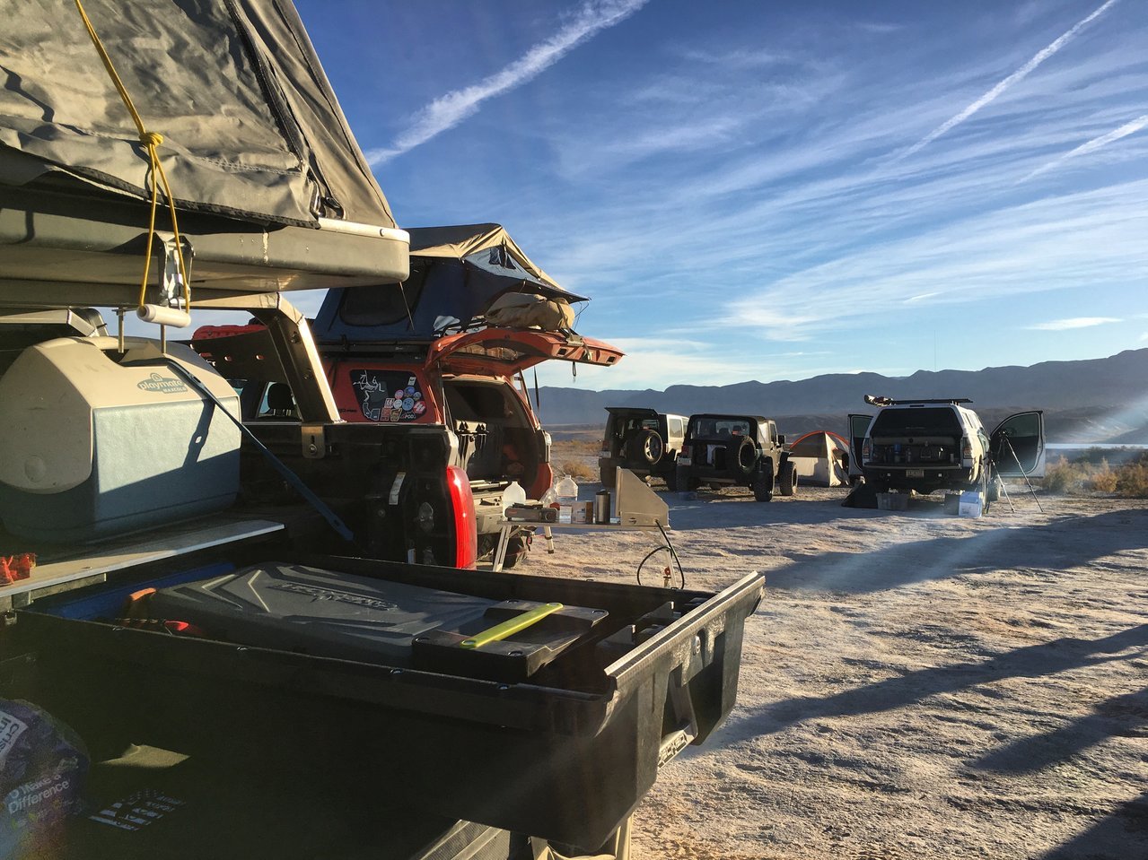

    FINAL IMPRESSIONS: 11/30/2017 After a solid, rugged, off-road experience in the Utah backcountry
    This unit is a well-built, solid alternative to less rugged, expensive, weatherproof drawer systems that are currently on the market or can be made by DIY’rs. I feel the price point is a bit high for the market considering the bed space it takes up and the weight it adds, however that financial investment is off-set by performance ratings that are absolutely off the charts!

    Bumps Off-road…
    (Whoops, ruts, berms, washboards, dips, sand, mud, water, dirt, hard-pack)
    (Mountains, beach, desert, canyons)
    I can honestly say that I have THOROUGHLY tested this unit with the utmost confidence that I have exposed it to all types of terrain, obstacles, natural features and man-made features. CE0ECFE2-CAE9-4242-BC33-AD5E81EFC813.jpg From California beaches to Utah’s vast terrain offerings, this unit has seen it all. Dust? No problem at all. The drawers did take in some very fine dust particles over a very long time wheeling in dust clouds. A4C5DFA7-836F-45FD-8634-0B708988B8AA.jpg The c-channels are covered in the fine silt and red clay of Utah’s backcountry and still roll/perform flawlessly.
    Impression: STOUT and DURABLE!

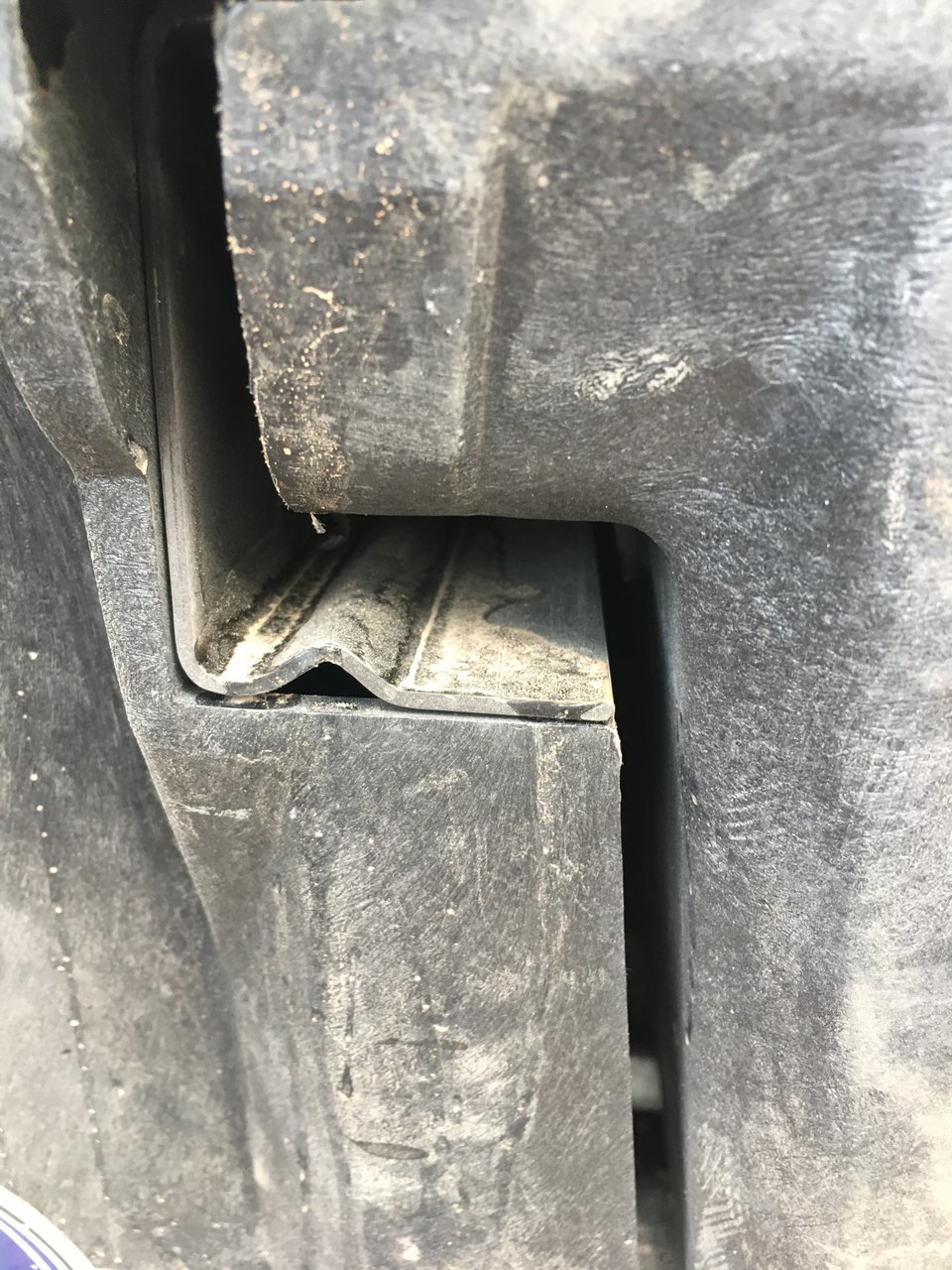

    Weather…and car washes…
    This drawer system has now been exposed to 100+ degree temps in the California desert system and high 20 degree chill in Utah’s mountainous region. From dry to wet weather (it DOES rain in Southern California), the DECKED drawers impressed me throughout! Nothing was wet after a wet day exposed for over 8 hours. 87C5089B-2C52-407C-9041-56B73A25D8C8.jpg
    The high pressure hose at the diesel truck wash was not match for the drawers. Surprisingly after a massive spray session with direct pressure washing of the top and front of the drawers, the weather seal did an EXCELLENT job of keeping the water out. EVERYTHING was dry upon inspection.
    Impression: Pleasantly surprised and impressed.
