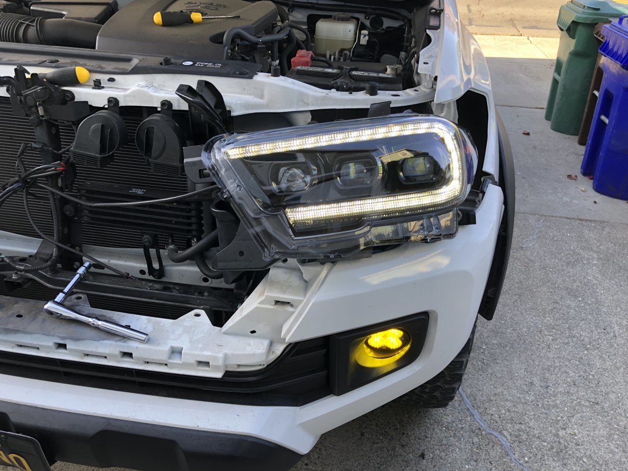

    This is what it looks like installed and you can see the glass front goes all the way down where the trim plate normally would be

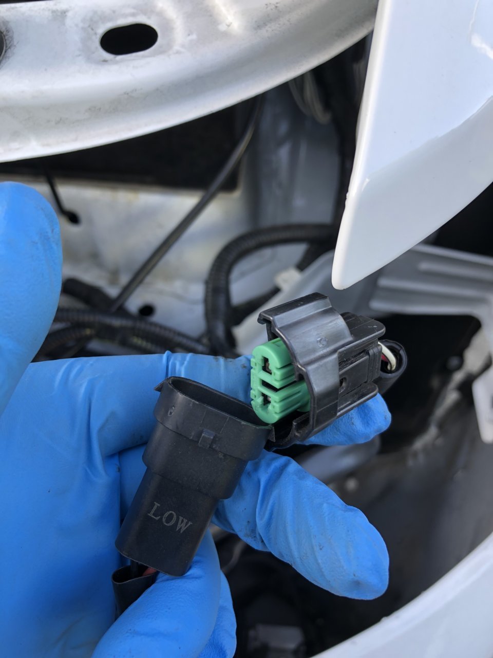

    @TRSAndrew @eledobleu
    all plugs are connected... but for some reason the drivers side light is not aorking? Any suggestion?

    You sure you connected the harness that is labeled Low on the headlights to the one with a green connector from oem harness?

    Drl/turn signal/emergency light works on both side. Passenger side headlight work. But the headlight is not working on the driverside

    hmm, that does look correct. Do you have a test light to ensure there is power going to the oem harness?

    Lol my oem headlight was working fine?

    Hmm, then I'm not sure what else it could be. For shits and grins, can you take the driver headlight housing and plug it into the passenger side harness since you know all that is working and see what happens.
    if the driver side housing doesn't work, then it has to be something internal to the new housings. if it does work, then there has to be something with the wiring on the driver side.

    Check driver headlight fuse in fuse box. Possibly got blown during installation

    Thanks fella’s it was a blown fuse.
