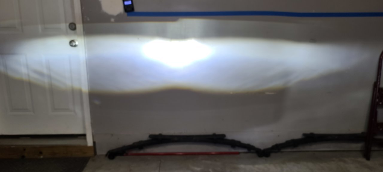

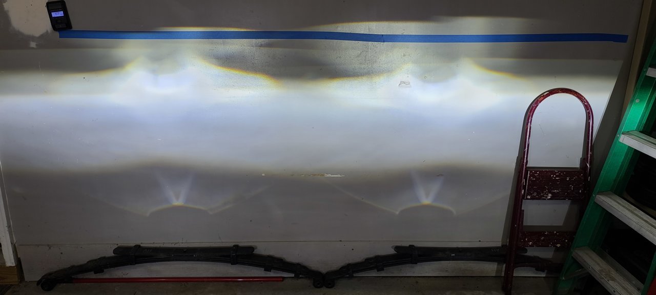

    Just the inner most one acts as a high beam. I have the same highbeam pattern as the gen1s I removed from the truck
  6. Dec 6, 2020 at 2:06 PM
    #2606
    TamaskanTaco
    TamaskanTaco Active Member
    Sep 1, 2019
    #303909
    26
    Jacob
    2019 Tacoma TRD OR
    Interior and exterior LED lighting
    It seems I was wrong. Just hard to tell the difference. Also of note, on the Gen2, due to the bi LED highbeams, they are no longer independently adjustable.

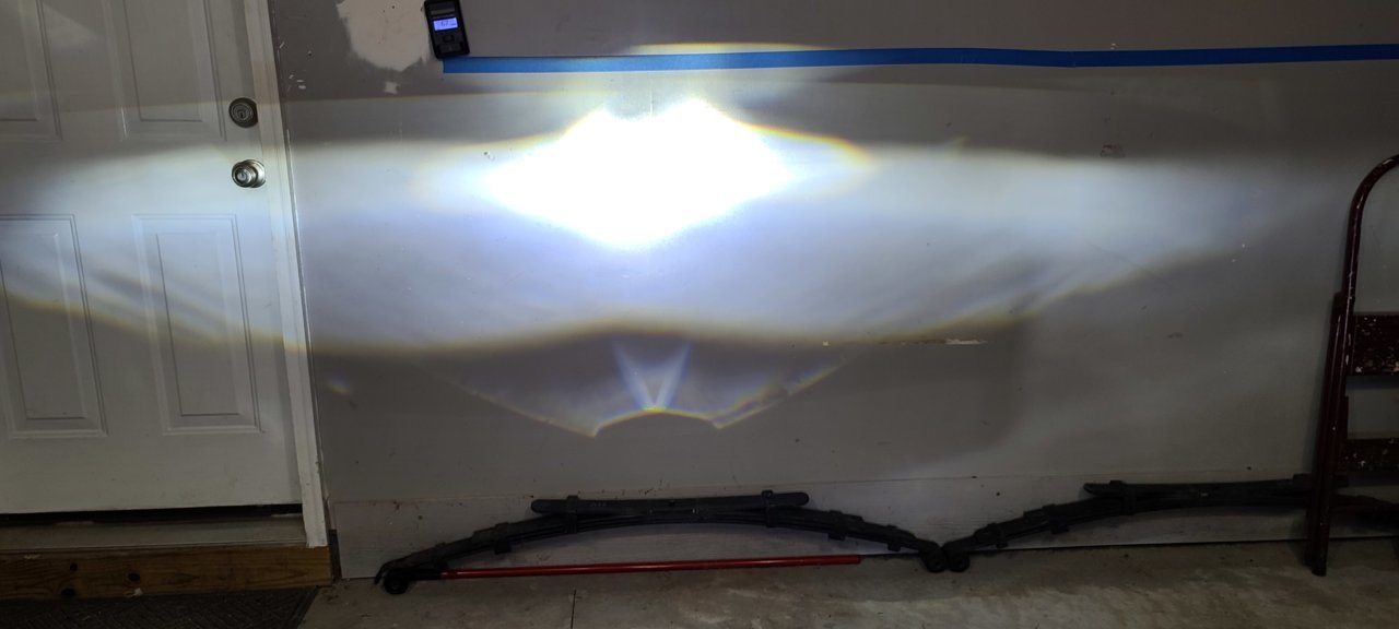

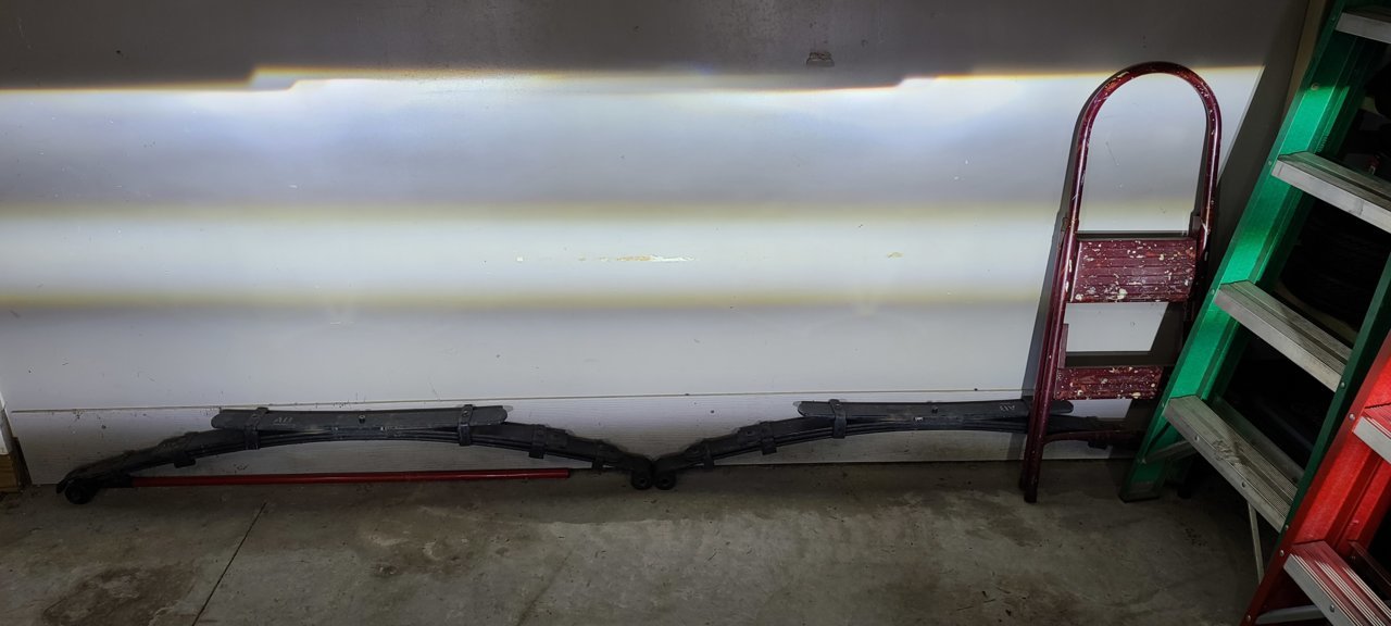

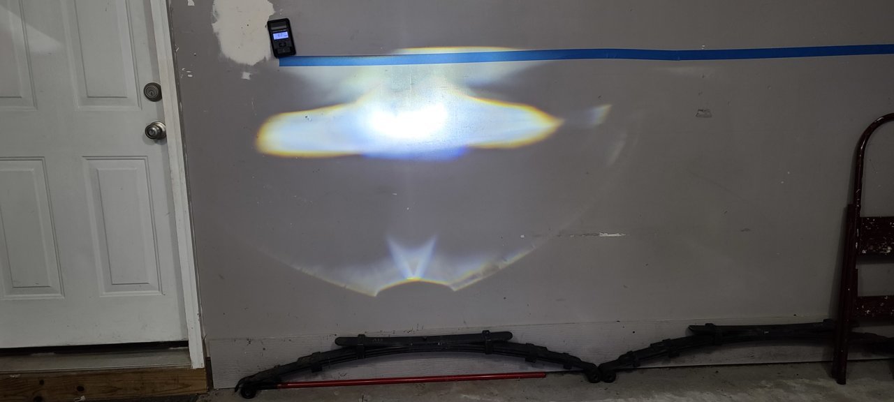

    First image is low beams (sorry for the fogs being left on)
    Second is highs on
    Third is only the high beam of the center globe
    Fourth is the inner most globe only
    Fifth is combined with the outer low beam covered

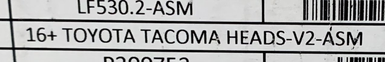

    Sweet thanks for the info! I got them today they are gen 2. Super stoked.
