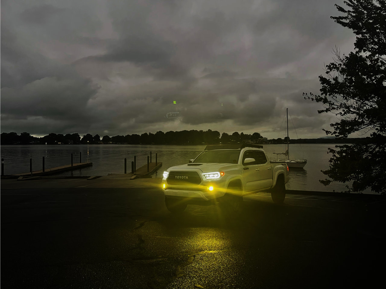

    Morimoto and Diode Dynamics ftw

    Great shot! :thumbsup:

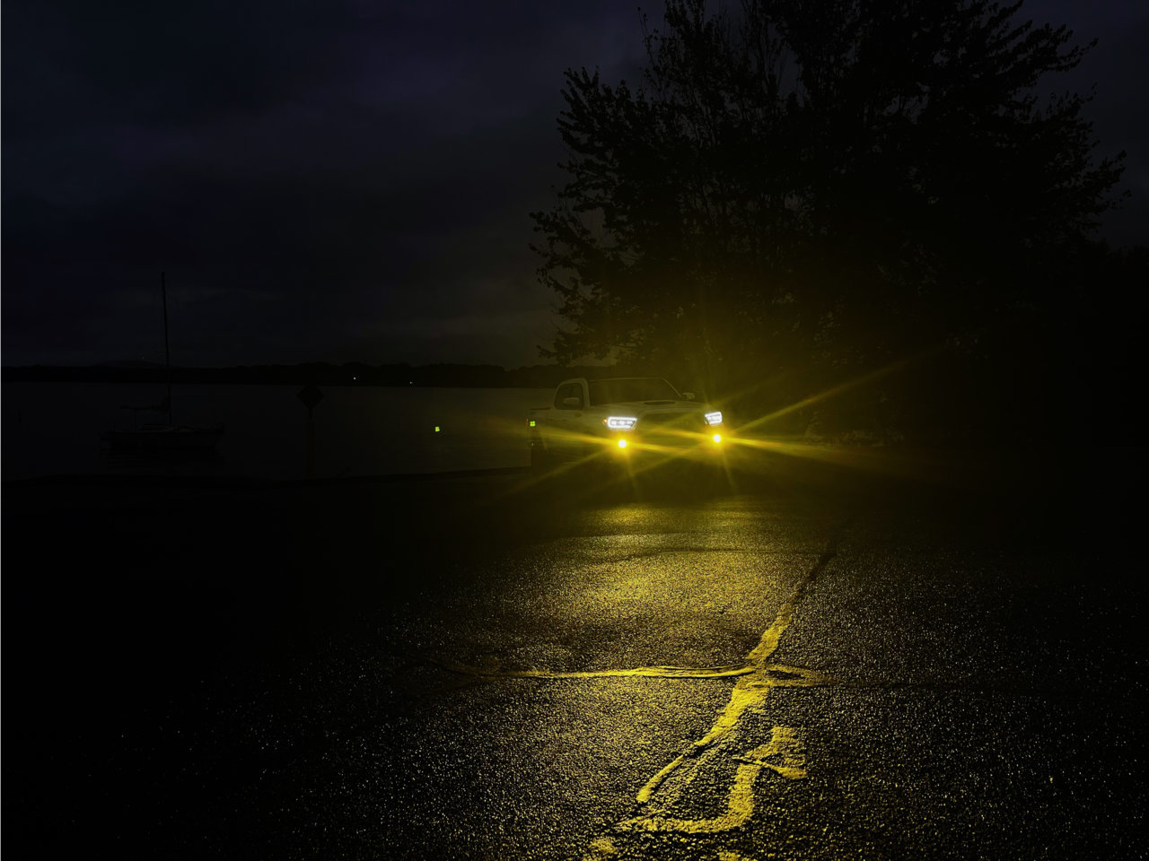

    They look super good. Love the photo!

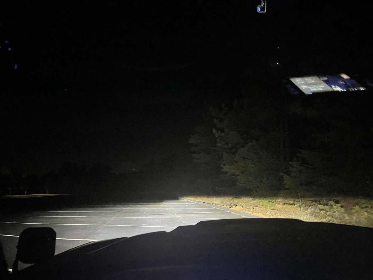

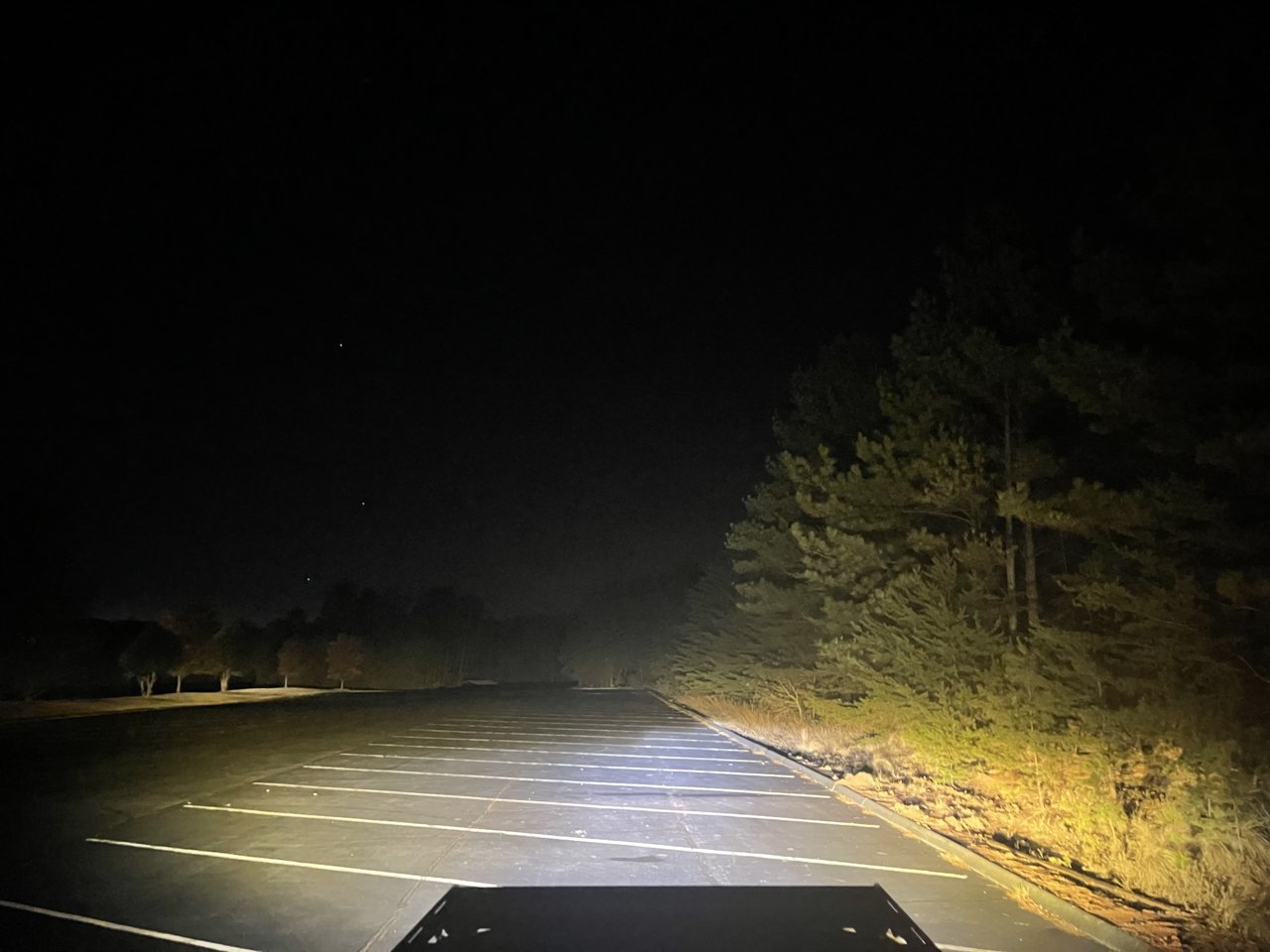

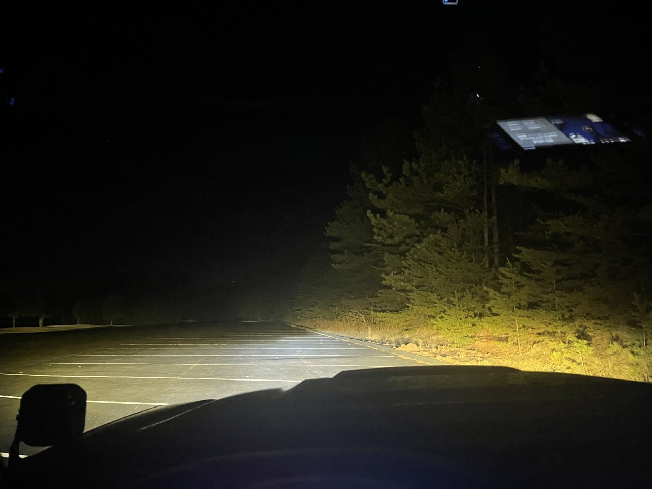

    Finally got some pictures of these lights from inside the cab. Idk why I never though of this.
    Morimoto XB v2
    Headlights on
    Headlights + Diode Dynamics SS3 Pro yellow fog lights

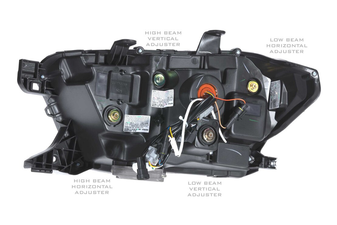

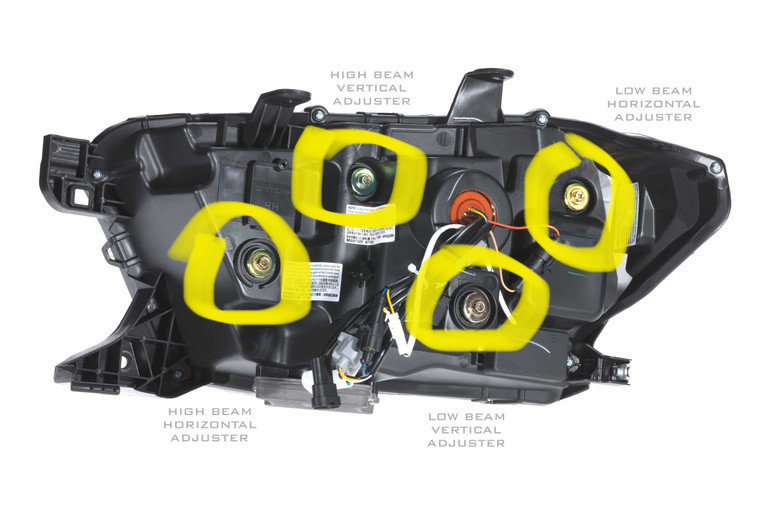

    Anyone have a quick link on how to aim? Not seeing it in morimoto’s install. I know 25ft level on a wall but what screws do what. Anyone have a pic with arrows that point directly to the up down left right?

    It’s going to be a stupid question but since there are smaller screws next to all them I’m going to ask (also had someone say you need a 6-8” long screw driver).
    Are we taking about these 4? I was thinking those but don’t need that long of a screw driver lol

    Correct those are your 4 adjusters. I believe that they're just a phillips in there. You'll likely need a really short screwdriver.

    Thanks! That is what I thought . Looks like 8mm fits on it perfectly also! Clockwise up I assume?

    exactly what I was going to mention. You can use a ratchet, much easier. You may need to add an extension to get to some but shouldn't be tough.
