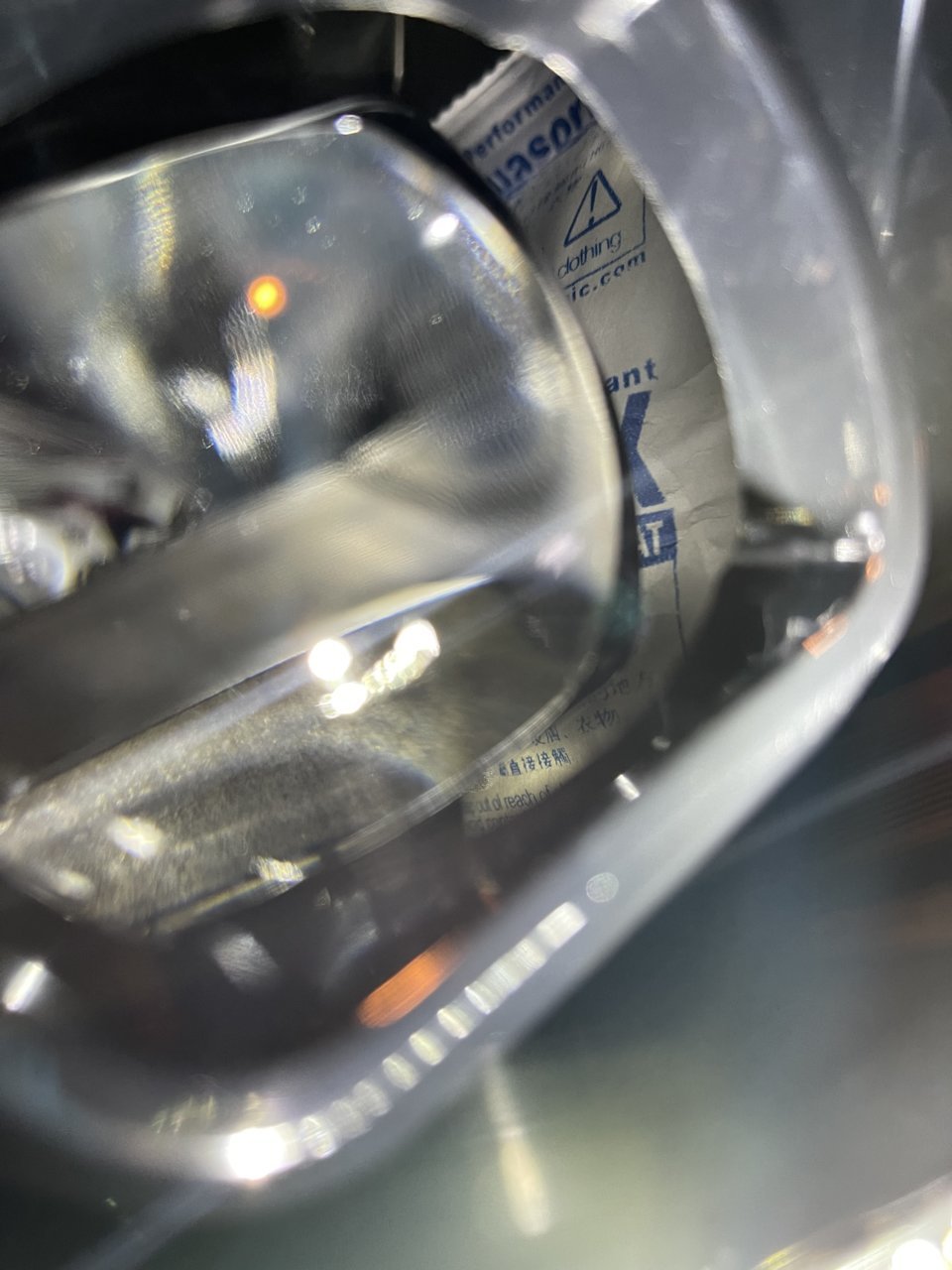

    I got mine in the mail yesterday and when looking at them I noticed a white bag visible inside the housing on both headlights. Does anyone else with these see this too?

    Yeah, that’s not right.

    I got mine today and def no bags inside

    Silica bag to pull out moisture, they all have them.
    Got mine from Hotshot Offroad on Saturday, and had them on about 20 min later. After I adjusted them up I couldn’t believe how much better they are over the stock projectors.

    I can understand that they would all have them. I'm just curious on the placement since after shaking and tapping the housing they don't move. And if they all come with this installed is the location the same.
