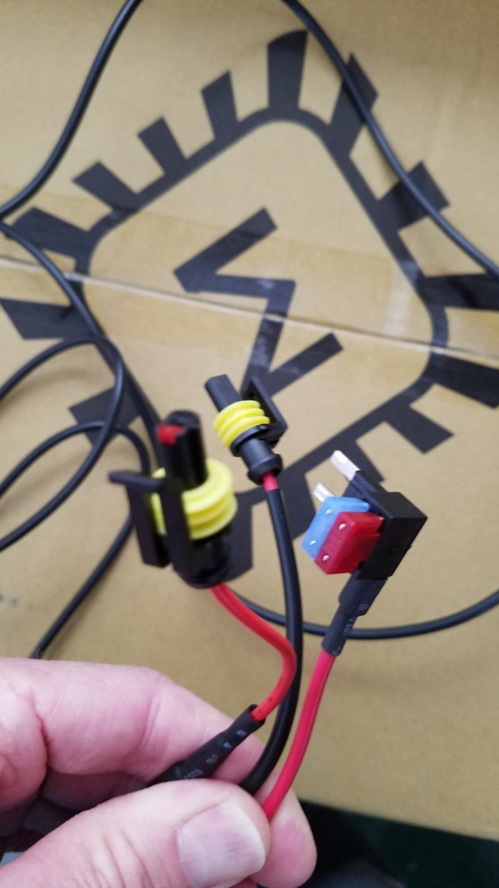

    so got my set a month ago and maybe I wired something wrong but do the drls not turn completely off? I turn mine off and they stay on the whole time. It might be in here somewhere but I can’t find a picture of how all the cables should be connected. Also sometimes my lights seem to come on randomly, seen it’s an issue but haven’t read how to fix it if there is a way.

    I was having what sounds like the exact issues you describe. Bright DRLs were always on, even when in the off position. Bright DRLs would randomly turn on after parking the truck. Noticed them coming on in the middle of the night. Are you using the fuse tap? I was using the fuse tap originally and removed it. Now everything is in working order. When my stalk is in the off position, everything is off. When I switch to DRL, bright DRLs come on. Headlights in the on position, DRLs dim a bit as expected. I recommend removing the fuse tap if you're using it. Solved all my issues. - 2020 TRD OR.

    Which wire is the fuse tap? Sorry a bit new to doing my electrical. Is it the wire that I ran to the fuse box because isn’t that supposed to be there to turn on the drls

    Yes, that long wire that runs to the fuse box. I thought I needed that for the bright DRLs, but nope.o_O

    Ok so I removed the fuse tap but now the bright drls won’t turn on when I turn my drls on. I have my grill lights wired to my drls and those turn on. I guess I’ll mess with the wiring and see how it all work without the fuse tap, maybe it’s just something else I didn’t wire right.

    Did you reconnect the plug where you removed the fuse tap from?

    Hahahaha no, I just removed the fuse tap from the fuse box. When I get a chance I’ll reconnect the plugs and report back how it went.

    Reporting back and it worked! Appreciate the help, it’s been bugging me ever since I got them.
