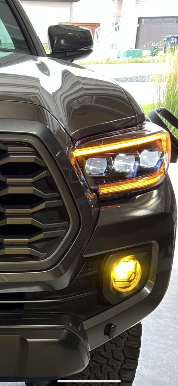

    Installed the amber XB’s and 4 Banger HXB’s. Love them. No regrets. Here’s what the combo looks like on MGM.
