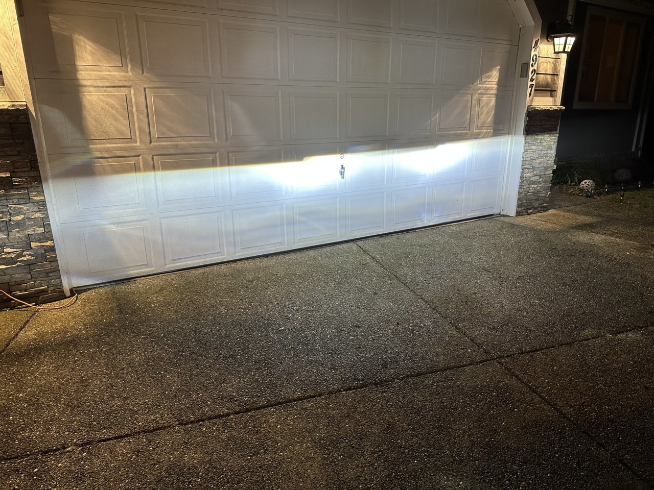

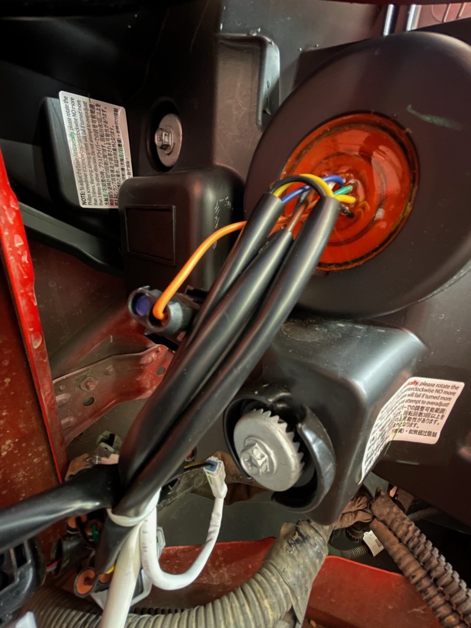

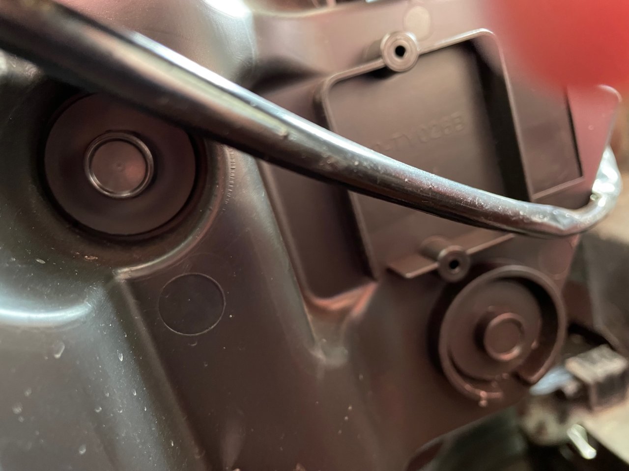

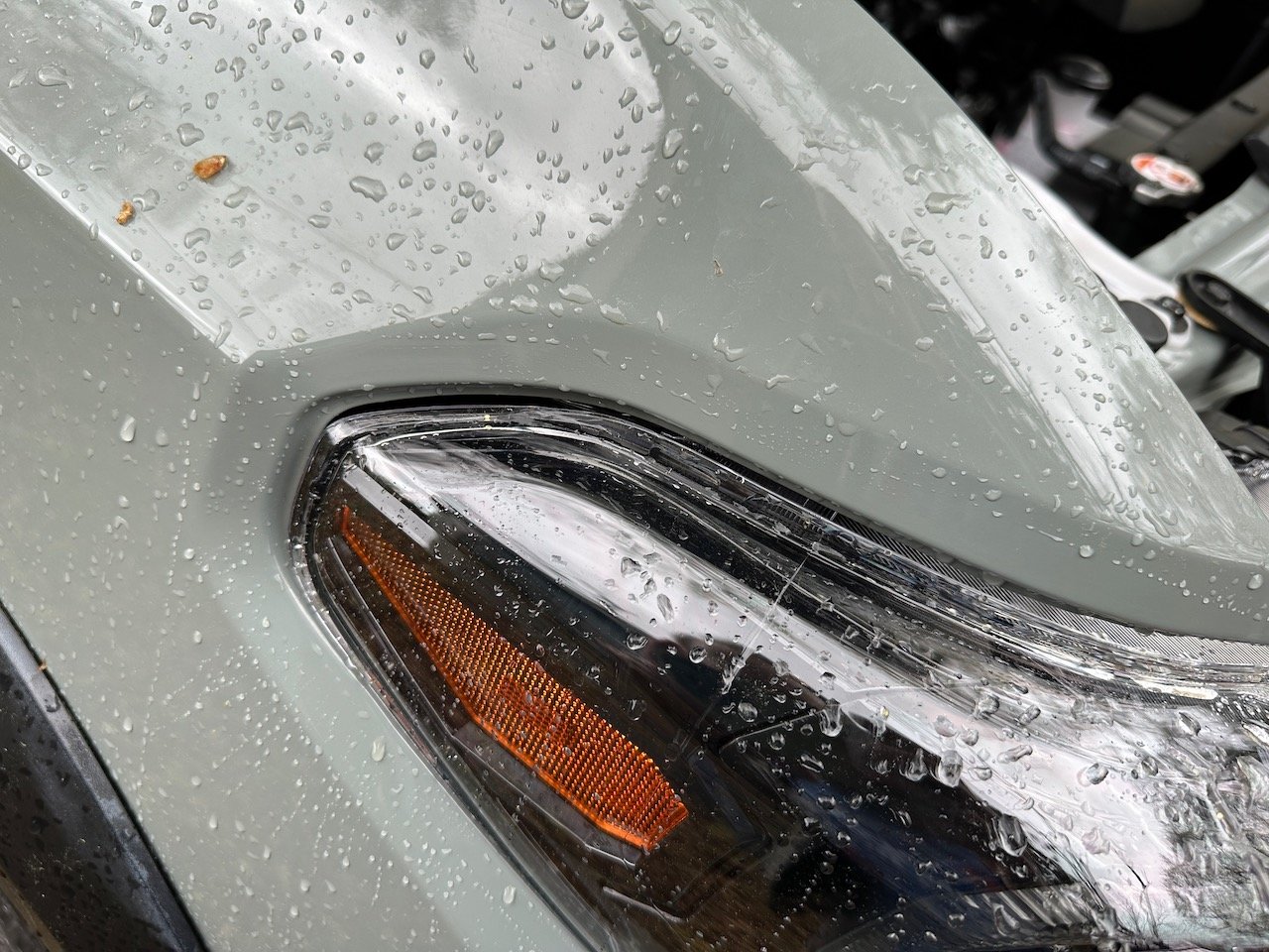

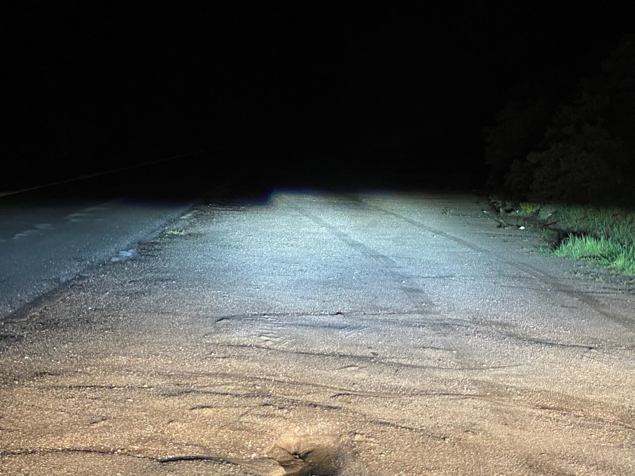

    I just installed the Morimoto XB lights on my truck and I have two small issues. The lights overall work just fine. From the startup dance to the DRL's and the sequential turn signals, they work great.
    Looking at the instructions, it says there should be 4 points at which each of the headlights can be adjusted, but each of the headlights only has 2, and 2 plugs where I'm guessing the "missing" adjustment points should be. Picture attached showing both points mentioned.
    The other issue I have is with the roadside headlight, where the light hits the ground at the top, there's a bit of a dip in the light on the left side, picture is attached. I've attempted to use the 2 adjustment points on the headlight in attempt to fix this, but it doesn't seem to move at all. Any suggestions?

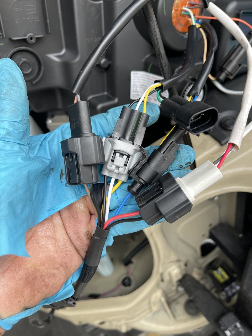

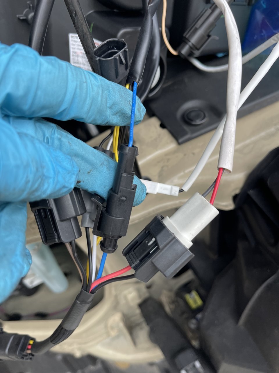

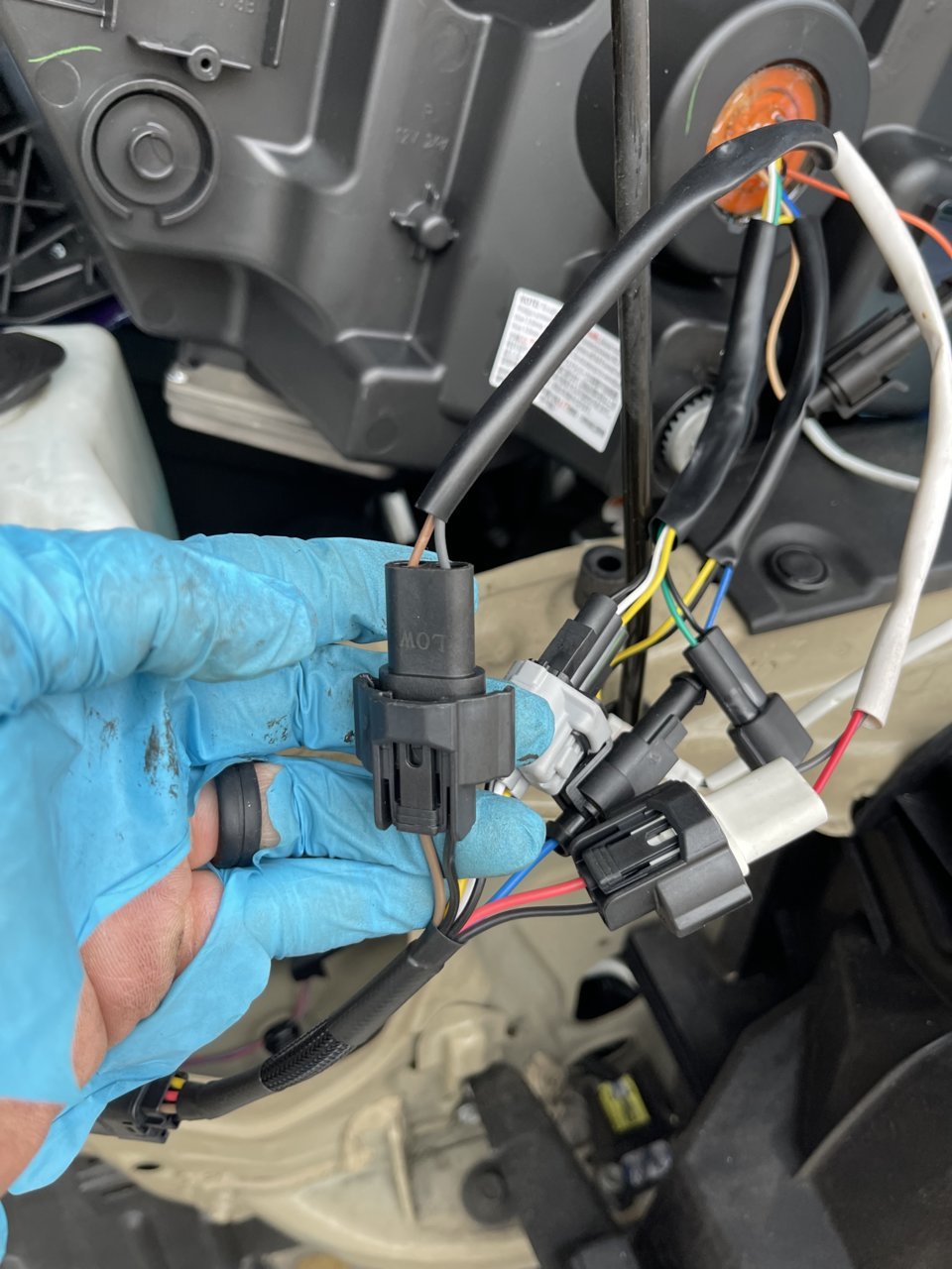

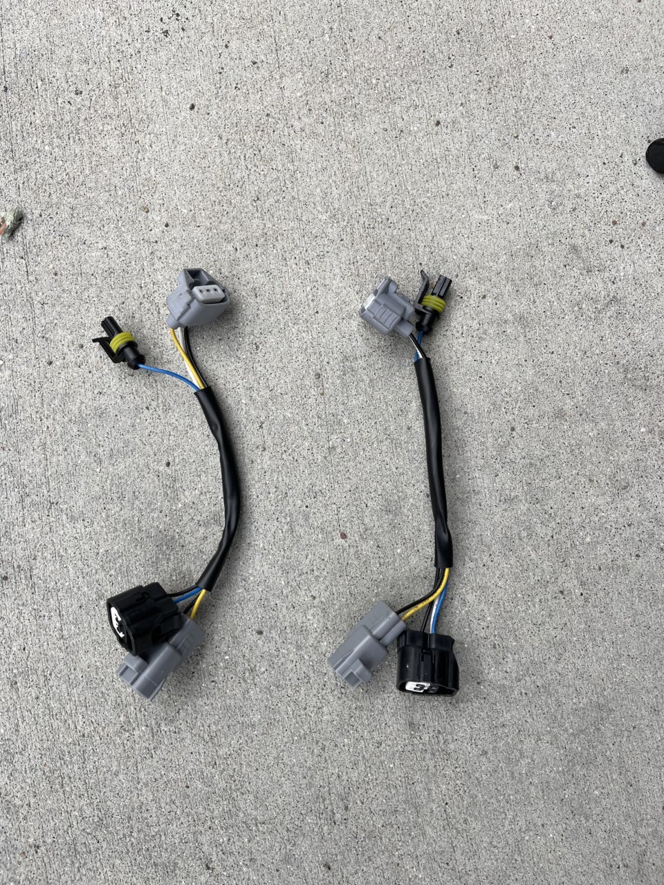

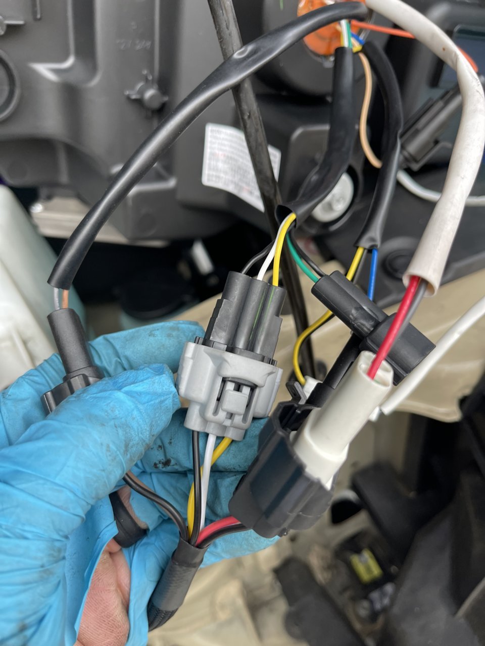

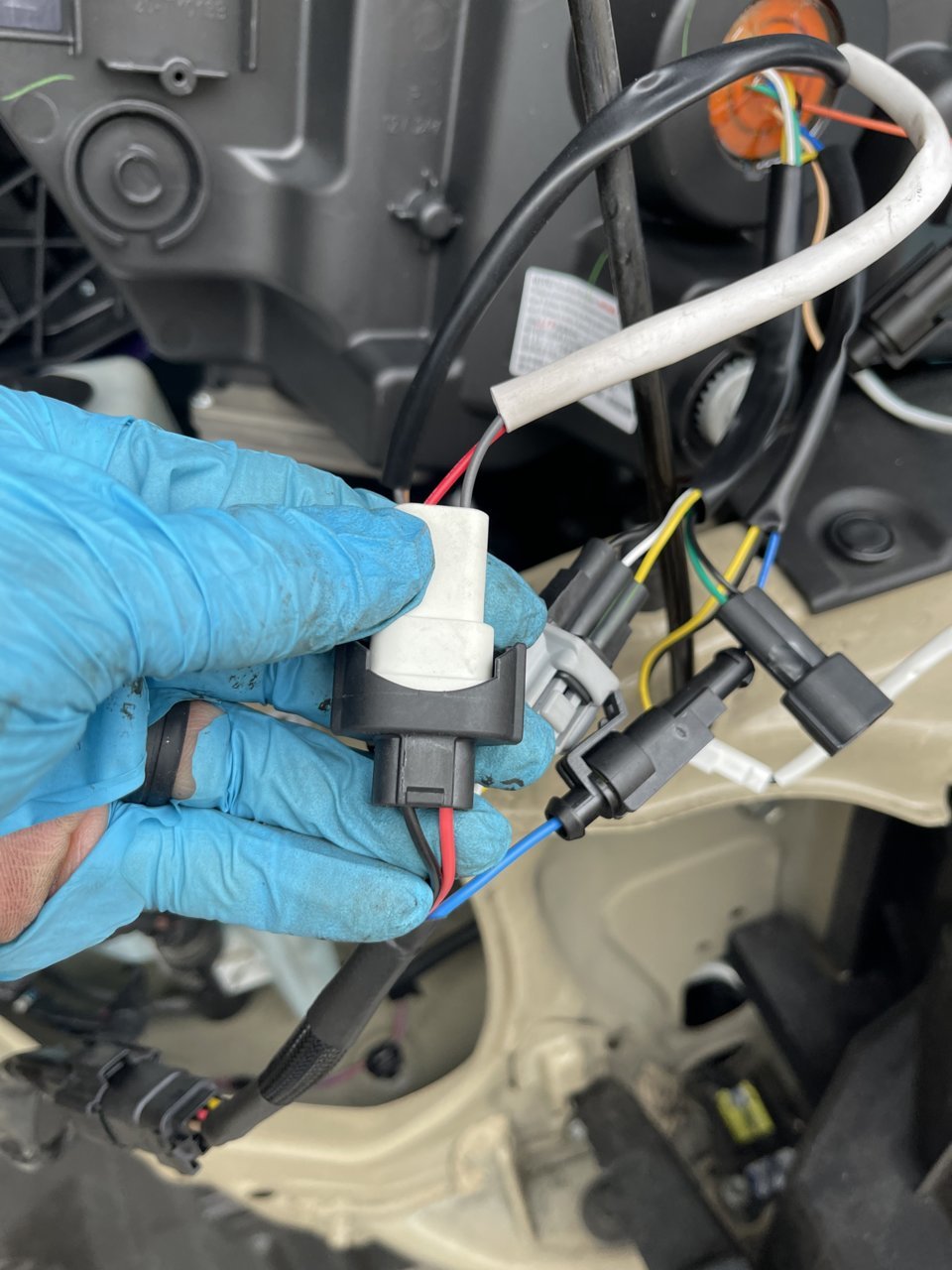

    Purchased the Morimoto XB Gen 2 headlights WITH the Morimoto Harness for the DRL’s, for a 2020 Tacoma Off-Road with LED DRL’s.
    Installed the lights but only the DRL’s worked, not the low or high beams. I bought the harness from Extreme Terrain (Item#
    Morimoto LF530H-2) but I don’t think it’s the right harness since there were some plugs that didn’t quite match up with the headlights. Also, not sure if Morimoto’s instructions are accurate or if I have the wrong harness, or both.
    Any help or guidance with this would be greatly appreciated.

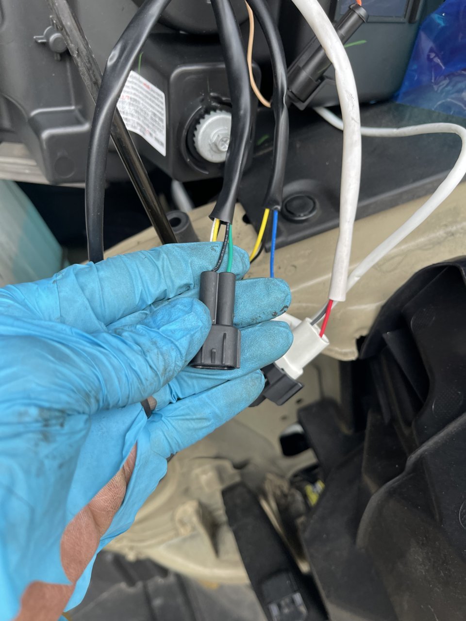

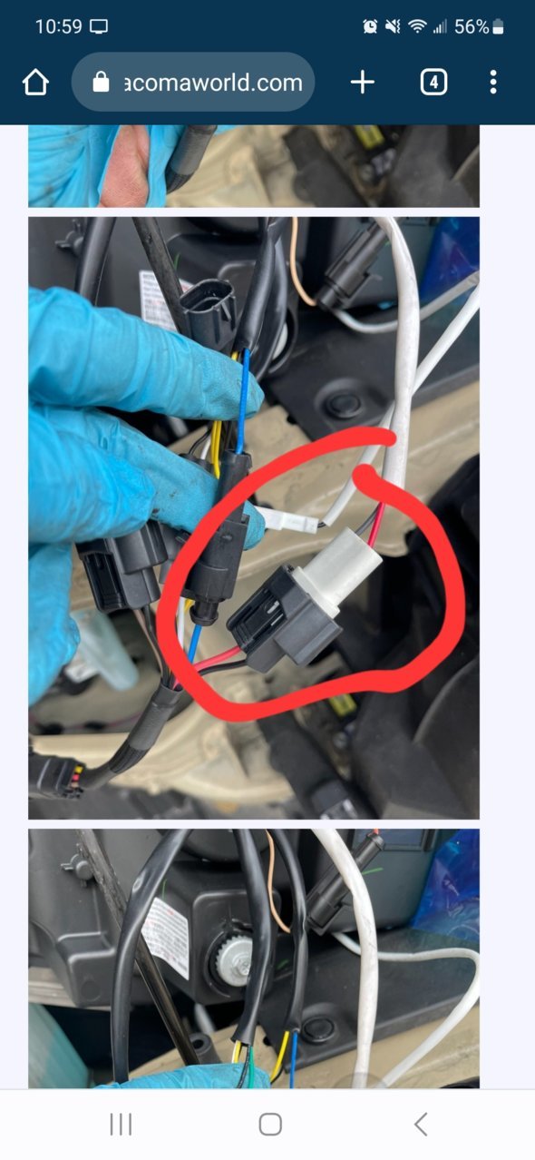

    Stock-ish
    Flip this plug 180 so red matches with red
