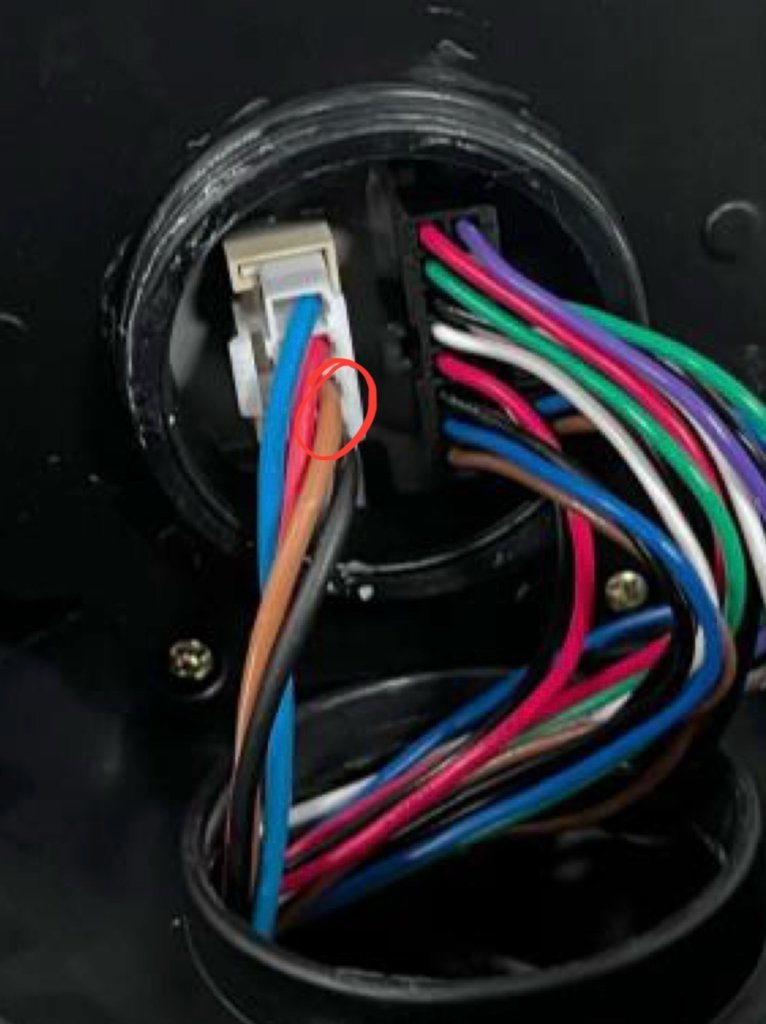

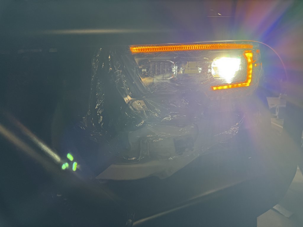

    Ok, just installed my new XBs on my third gen taco. Here’s the issue:
    Only one of my three projector beams is working on the drivers side.
    17 Tacoma TRD Off-road, OEM lights were factory halogen with LED DRL.
    Initially, only the passenger headlights were turning on.
    After careful review of the install videos and some suggestions from the Tacoma World Forums, I decided to reopen the LED driver located at the bottom of the housing and found a that the brown wire to the four pin connector was not connected at all.
    I reseated the wire to the connector and now only one of the two low beams projectors are turning on.
