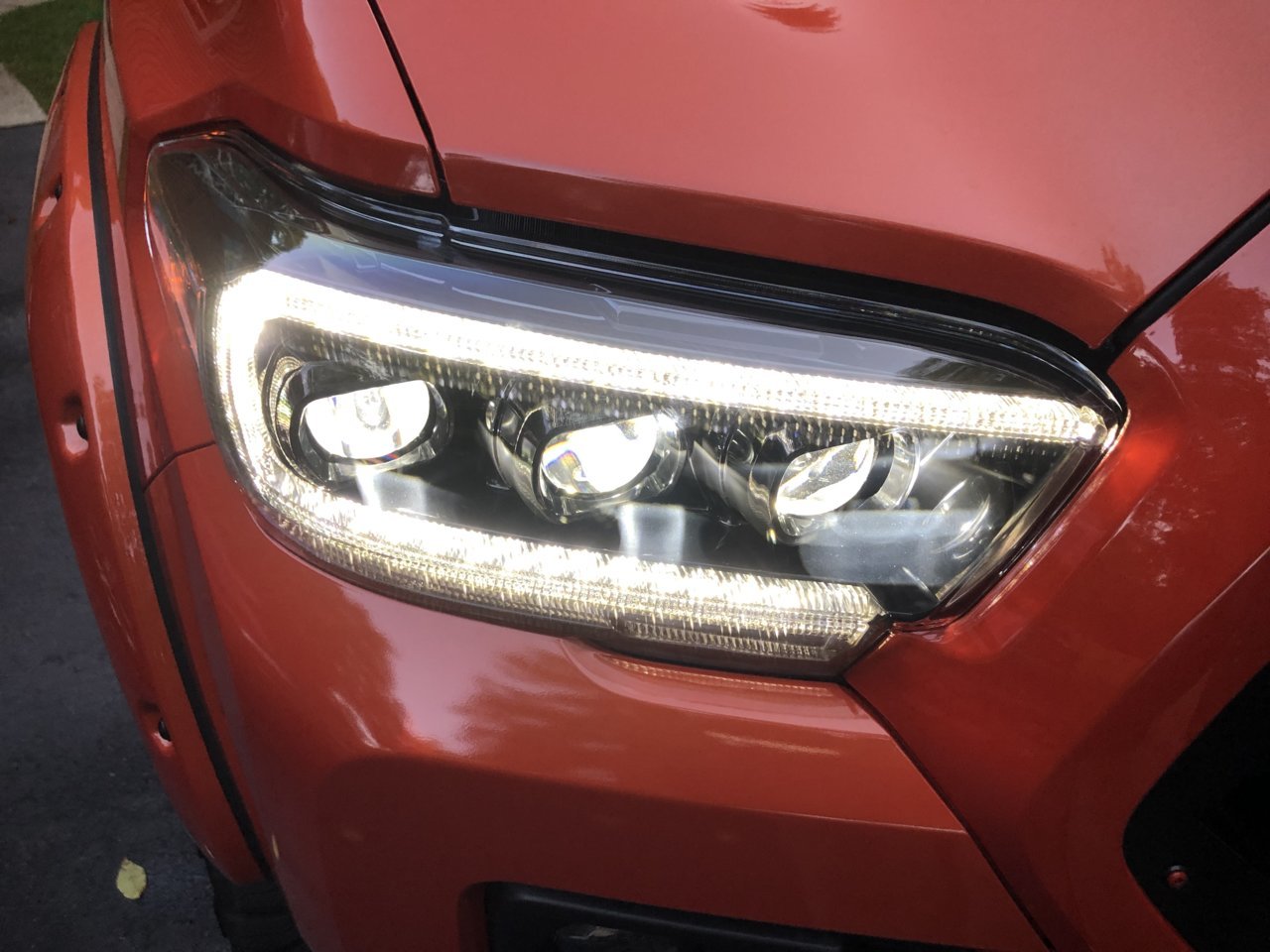

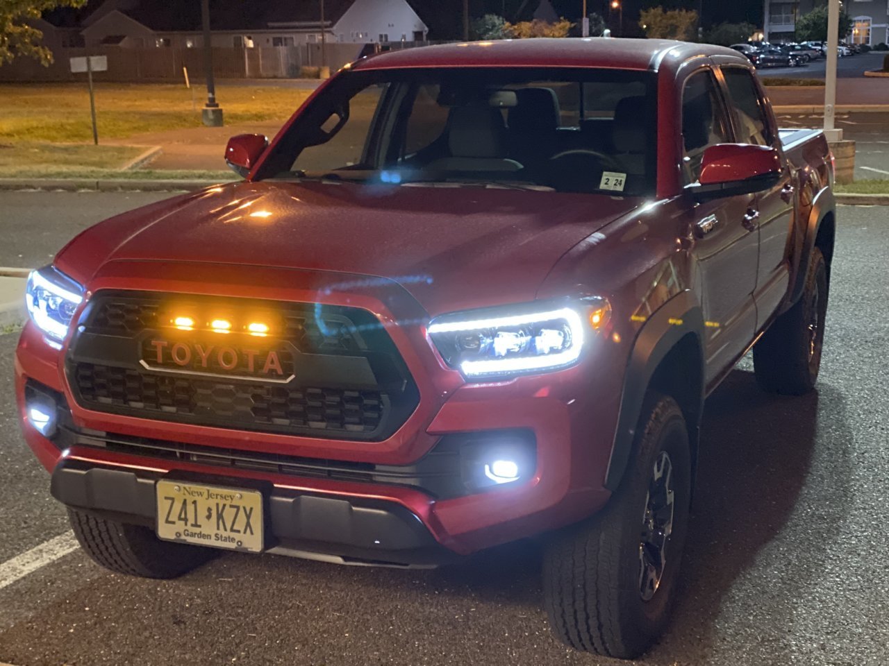

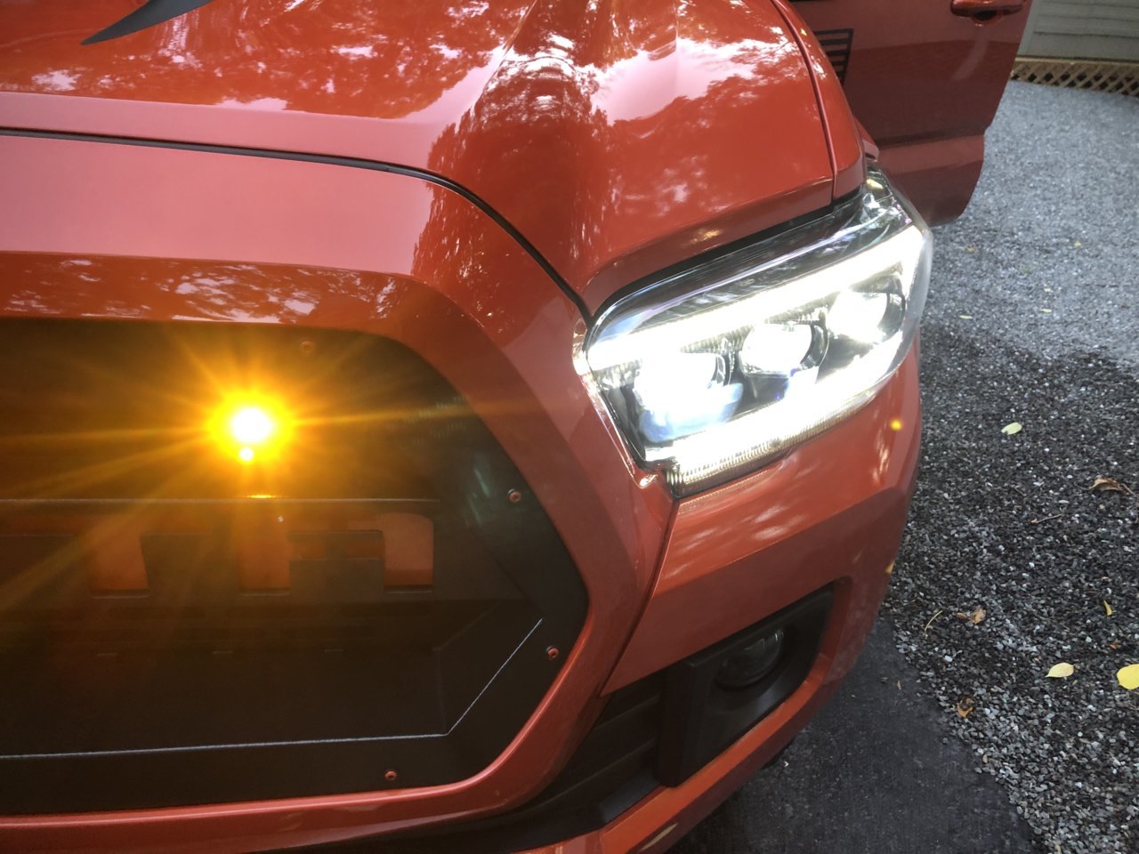

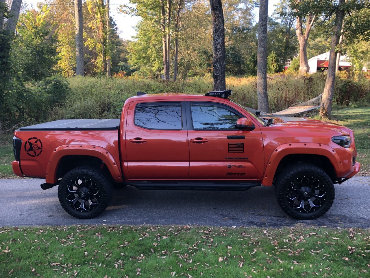

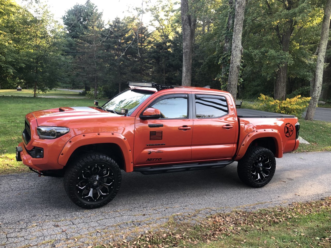

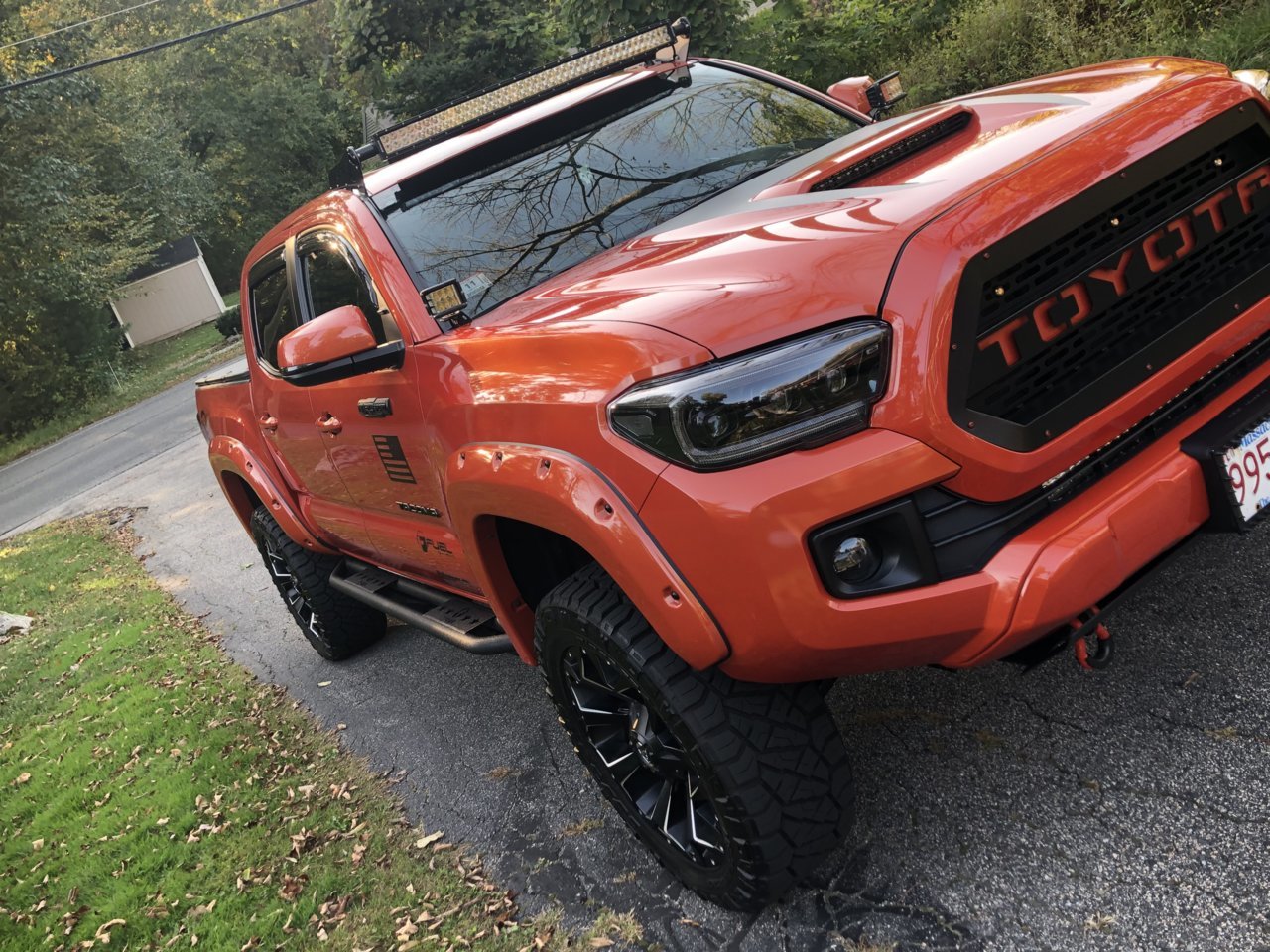

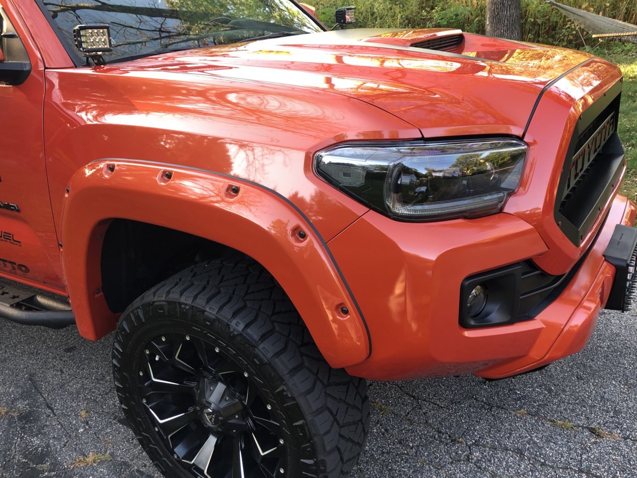

    Checking in from Massachusetts with the endgame of chrome removal and one of the best mods I’ve ever done to my rig since day one...amazing level of quality to these lights with perfect fitment and straight forward install. So happy with the end result...412CD7E6-422A-412C-A532-F527E1357C35.jpg15581701-EEE2-4330-ABE6-AB9982047F0B.jpg 957B9013-39F8-40D3-841D-82A11C7F5484.jpg838A2E83-C1A5-4CD9-A56D-BD35B7A53775.jpg 03ED67B0-C226-4835-B97B-213A9AD39B17.jpg6F6AEE7A-953F-4D7E-ACAB-888B8BAD3177.jpg 4A6762A9-7A2F-4D89-9200-CBD8D56168FF.jpgDD7DA8F8-FAA4-44EC-B4E1-F16F8E82EC8A.jpg
    Semper_Fi, TRSAndrew, TacoInk and 6 others like this.

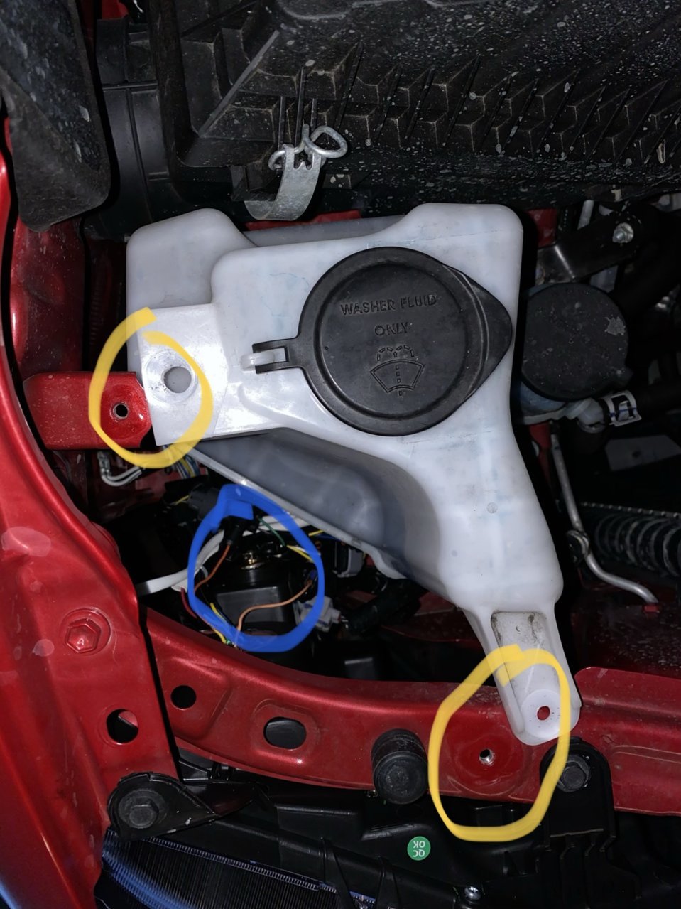

    Just got them aimed. Looking good. Little bit of a tip though, if you don’t have a ratcheting 8mm box end wrench, it’s damn near impossible to reach this adjustment point(blue) on the passenger side. Simple solution, remove the two 10mm screws (yellow) holding the wiper fluid reservoir in place and push it back slightly. Was able to get in there with an 8mm socket wrench no problem and adjust the angle.

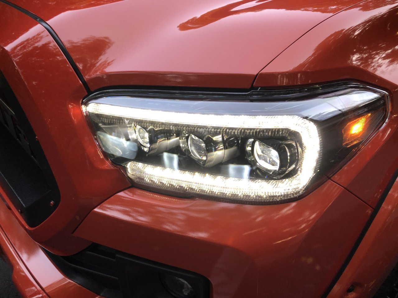

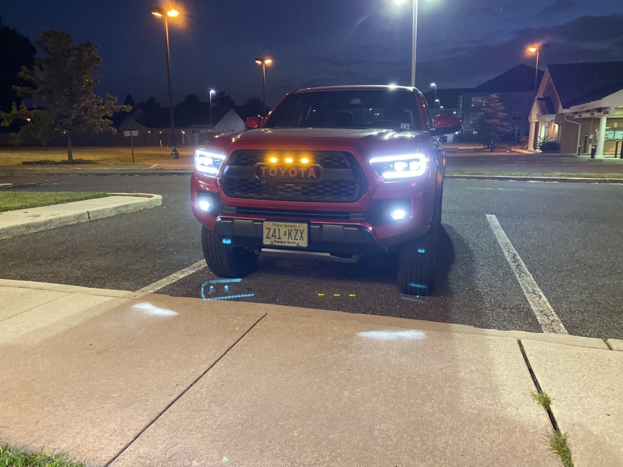

    Some night pics

    Had to do the same thing with the reservoir. My lights needed to be adjusted up a good bit.

    Just don’t remove the tank all the way! I’ve done it before & holy fuck does it instantly start pouring out everywhere & and is a bitch to get seated back the right way
