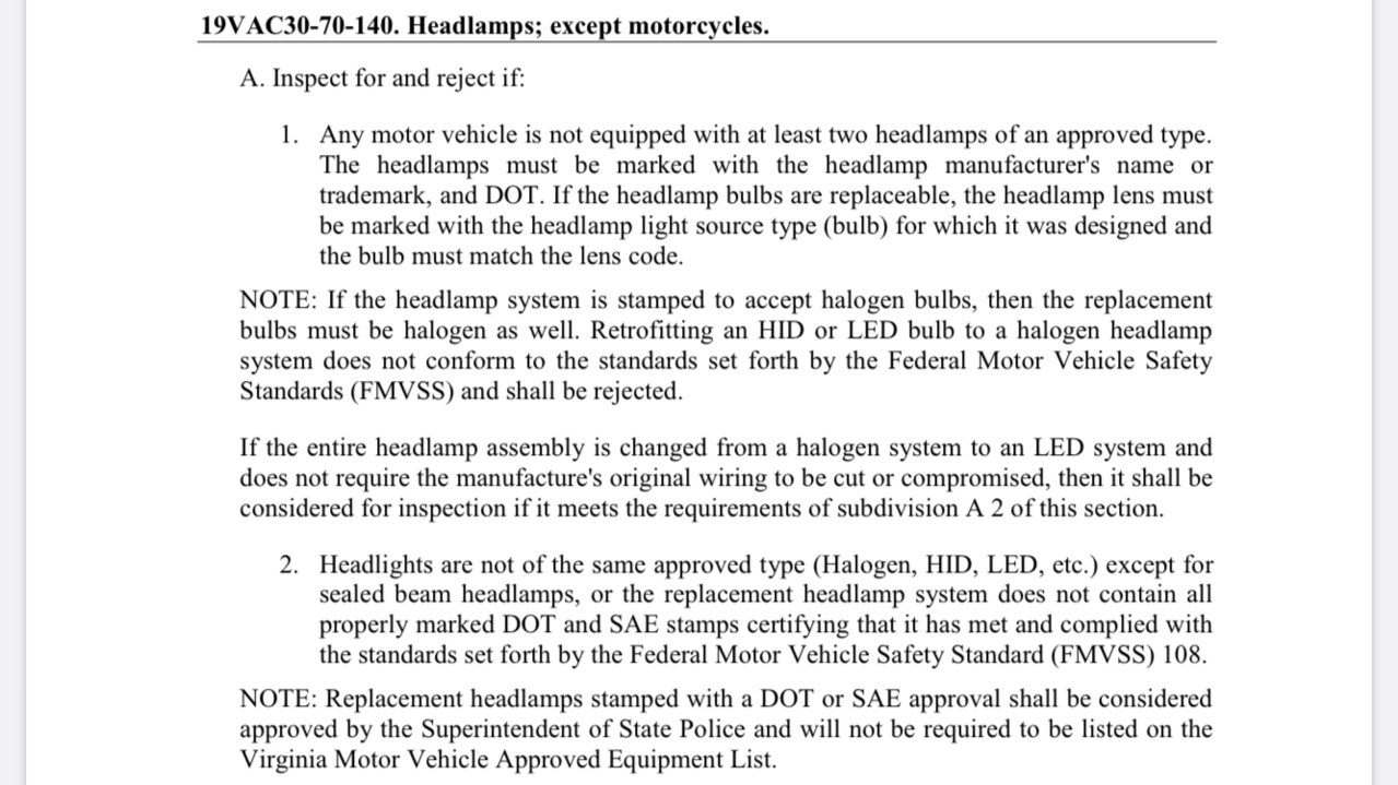

    So in other words they are not “labeled” DOT or SAE Approved?

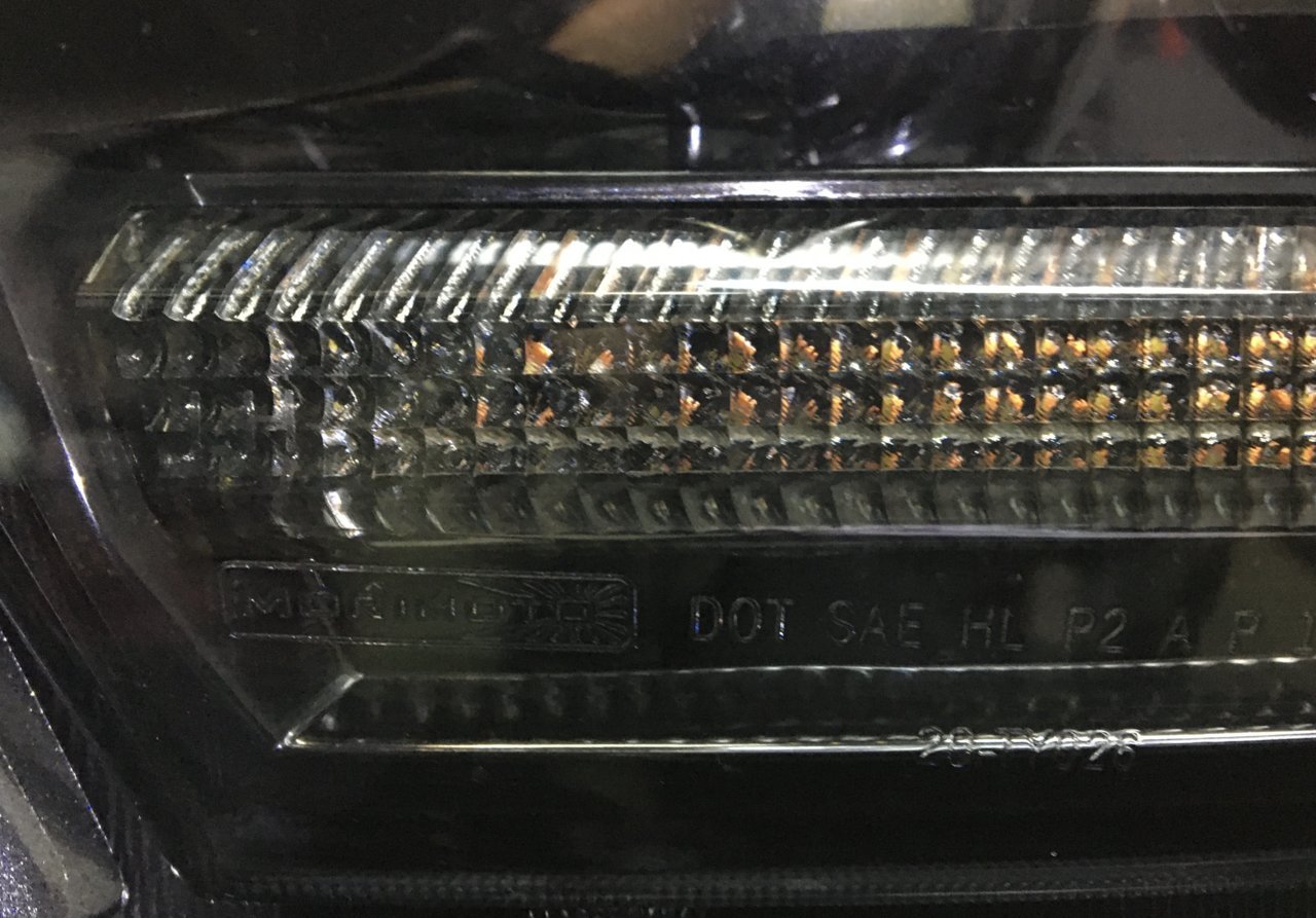

    From what I see they are stamped DOT lower left

    Not a great pic, but here you go, son.

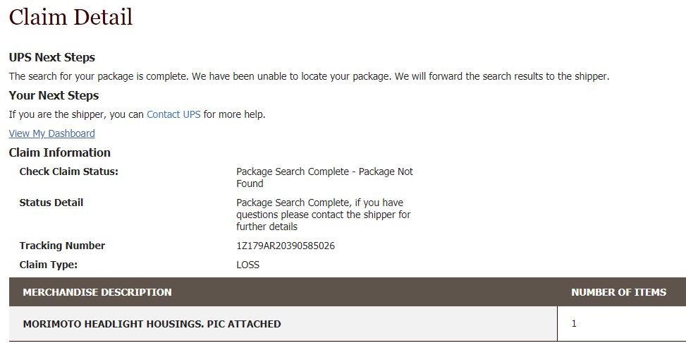

    USPS lost my Depo headlights a while back, I had to return them and the company got one of the lights 10 months later, and never received the other. It doesn't make sense bc the lights were in one giant ass box. How did they lose one of the lights it still boggles my mind. And the whole time company was a pain in the ass acting like it was my fault, and I will never deal with them again. Had to file a credit card charge back to get my money a couple months after the lights were lost
