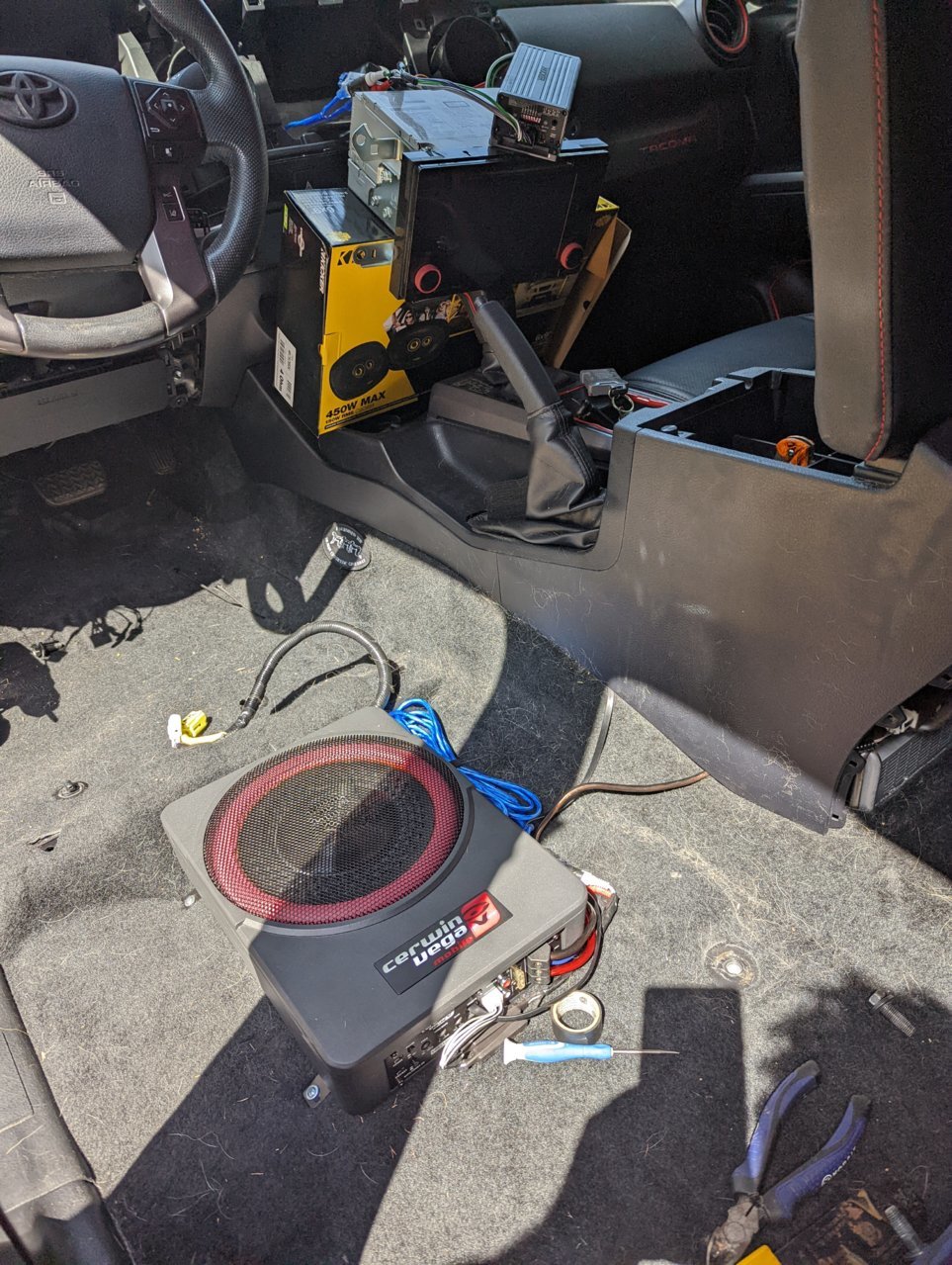

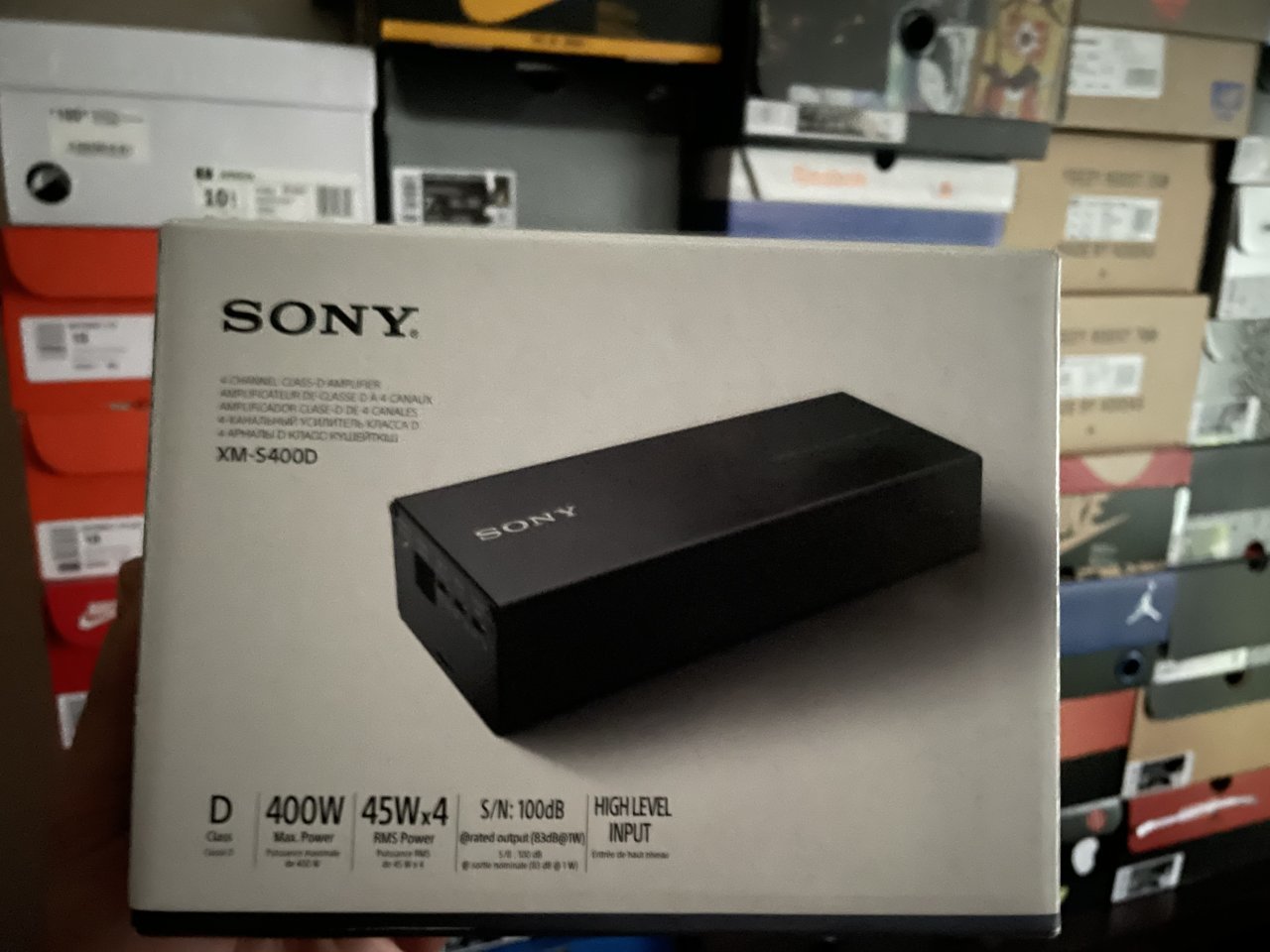

    Very similar. Kicker brand instead of Sony, but similar levels of RMS output.
    ... it was a tight squeeze to get it into the dash, and an even bigger pain to calibrate, but so worth it. :cookiemonster::cookiemonster:

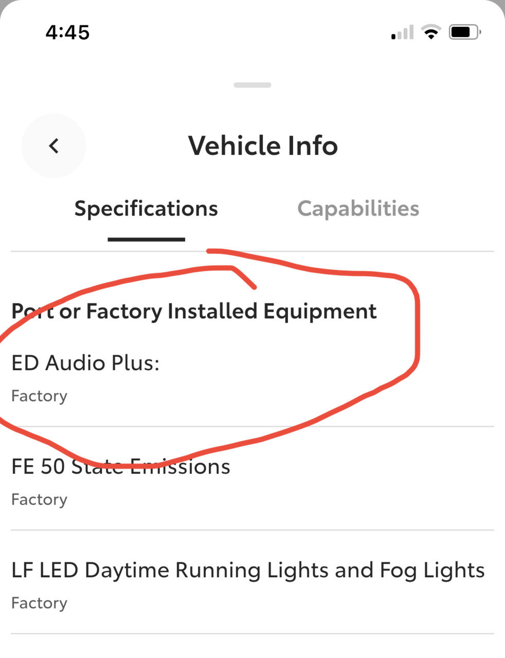

    How can I tell if I have the Premium Non JBL HU? For reference I do have the 8’ screen and on my options list I do see a no cost item called “Audio Plus”.

    You can look at your build sheet. Set up a "My Toyota" account and add your VIN. If you have the premium head unit, the build sheet / options list will read, "Premium Sound".
    Here are the differences:
    https://www.tacomaworld.com/threads/3rd-gen-entune-radio-head-unit-comparison.682700/
    Put your radio into service mode and google the part number or look above... I assume that the process hasn't changed:
    https://www.tacomaworld.com/threads...r-less-than-250.510424/page-236#post-27412928
    Turn the car off/then on again to get out of service mode.
    If you have a base or a plus, only upgrade the tweeters.
    Premium will allow you to also upgrade the front doors.
    https://www.tacomaworld.com/threads...r-less-than-250.510424/page-237#post-27602529

    I only see Audio Plus see the attachment

    You can also go out to the truck and get the part number off the screen once you put the radio into service mode.
    If you only have a "Plus", it may not be worthwhile to upgrade the door speakers; only the dash tweeters.
    On my 2018, the build / option sheet read "Entune Premium Audio w/ Integrated Navigation and App Suite".

    I have:
    Entune 3.0 Plus (8" screen)
    Manufacturer: Fujitsu Ten aka Denso Ten
    Part Numbers: 86140-04230
    Guess I should skip door speakers unless adding further amplification
