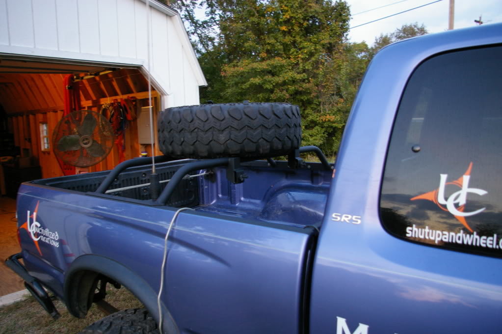

    all you really need is 2 Bolts through your box. but you can see my mounts here.

    yeah hold the jack up where you want to mount it. drill 1/2" holes put a 1/2 bolt through bolt it in. then slide the jack through and use a washer and a wing nut to hold the jack on.

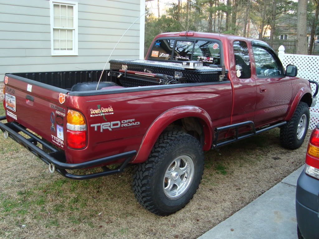

    these are leaf spring brackets for a trailer, i ran a big bolt through em both then bolted em right to the box. i found these at northern tool. i keep a socket and driver right inside the tool box for dismount, thought about wing nuts but after i tighten up the nuts real good its one more step to take for a passer by w sticky fingers.
