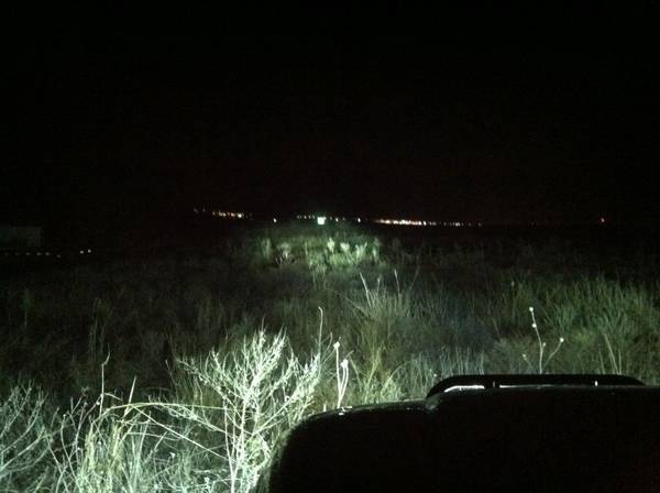

    I have some hella 700 55w with the HID conversion and those suckers are the furthest reaching light i have ever seen. I was using KC lights before i got these. I also have a rigid LED light bar and those are very good lights also. They both blow my old KC lights out of the water.
    EDIT: here is a picture, its a bad picture but the lights are great.

    those are not the ones shown with the elusive elements light bar? and on some trucks on here?

    damn, that is far. both pro and con, too many flippin options!! i've got nothing but time though, keep on searching..
