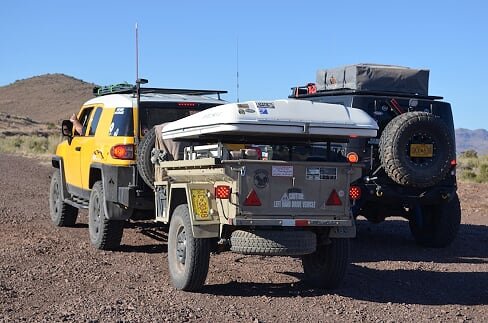

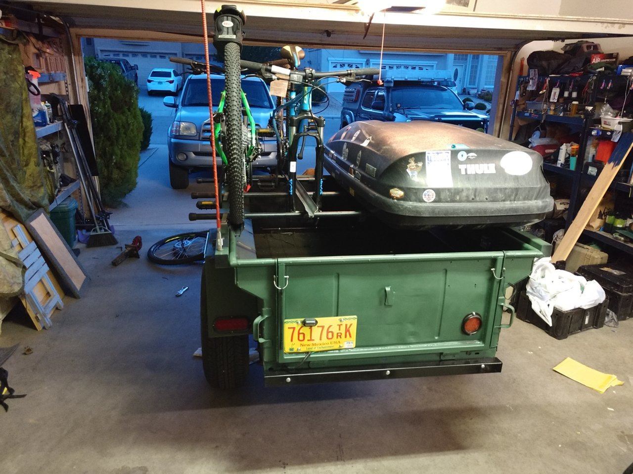

    I've been using on & off for over 20 years a M416 trailer.
    Different RTT, no RTT, bike kayak hauler, its been from MX to Alaska
    Best built trailers out there.
    The Pintel can't be beat

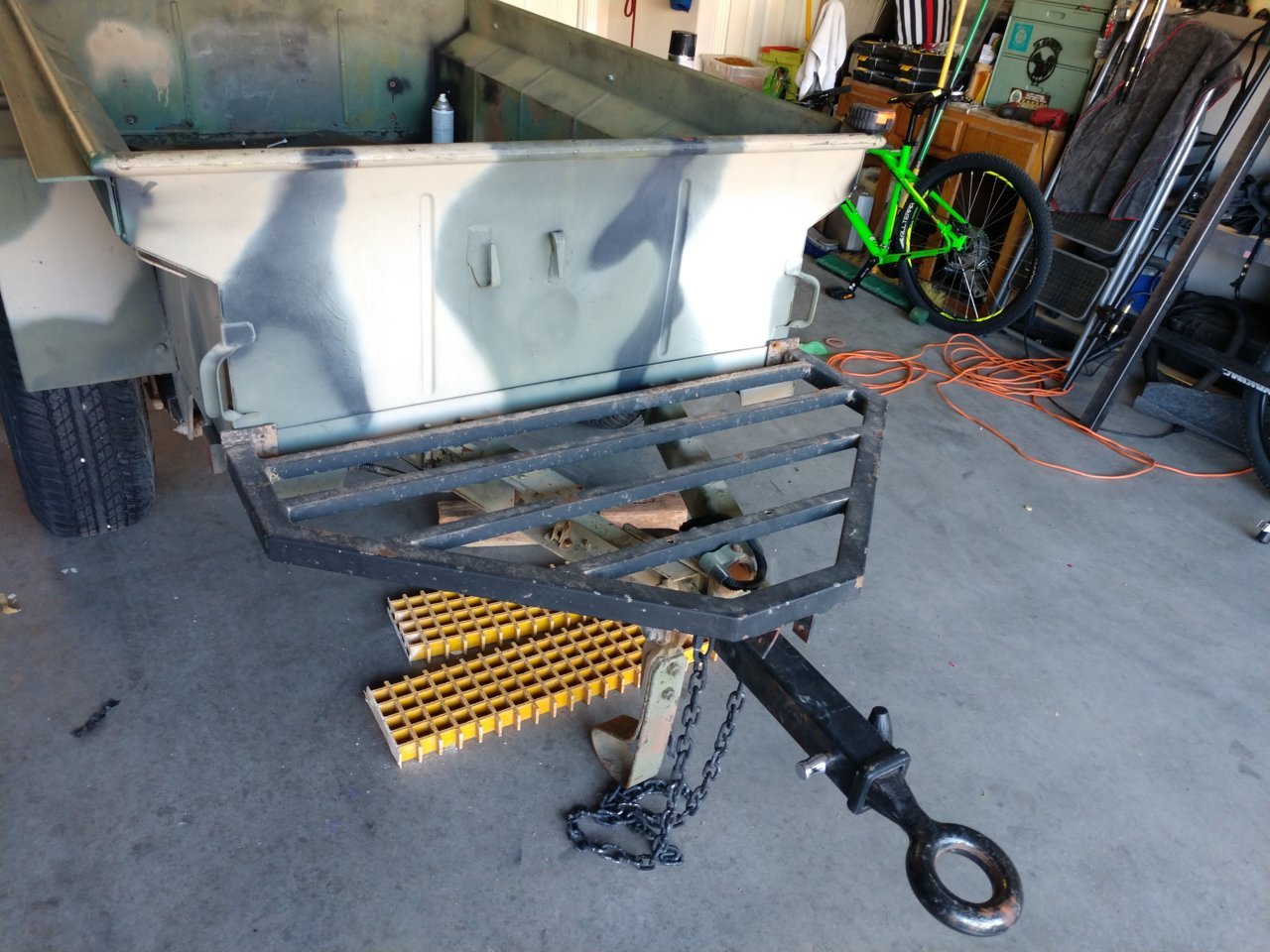

    hold up...
    how you do the tailgate i must know lol
    and the pintel can be beat tbh look at mine lol

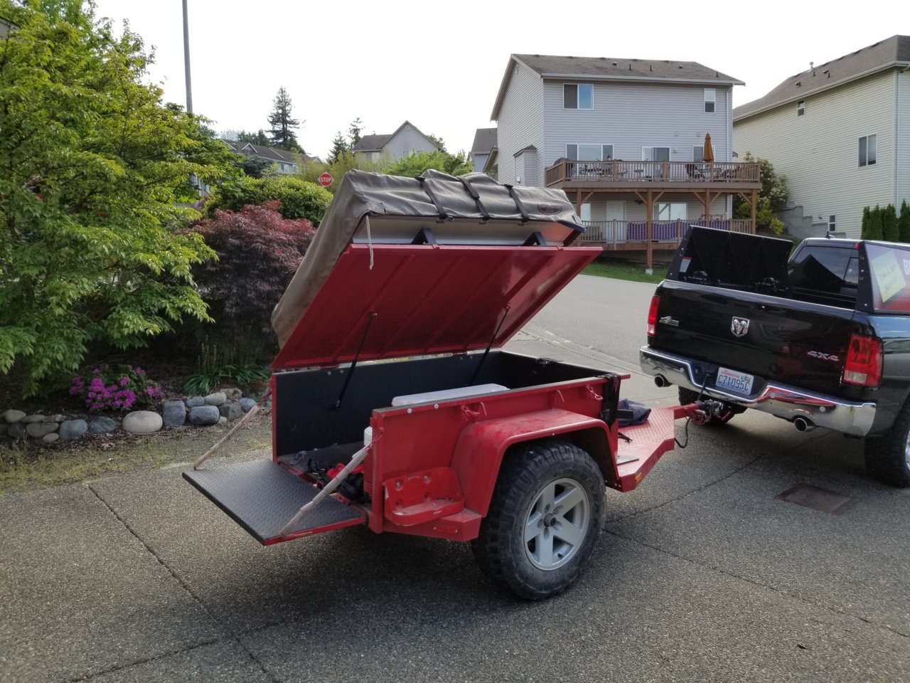

    Hinged hard top... old picture, before wheel and tent change.

    That's pretty cool and allows good access to stuff in the front

    Yeah, the gas strut assisted hinged lid is one of my favorite aspects of this trailer. When I switched from the Mumbasa tent to the CVT Rainier Summit, there was a considerable weight gain and the shocks would no longer hold the top open. Losing that functionality really sucked (crawling into the front). I've since swapped the (2) 200lb shocks for (2) 350 lb shocks and she now opens like a dream.
    I intend to put a taller rack on the top for the tent, so I can fit my kayak below. Hopefully the shocks still support the extra rack steel. I'll probably add some additional hinges to help support the additional load and leverage.

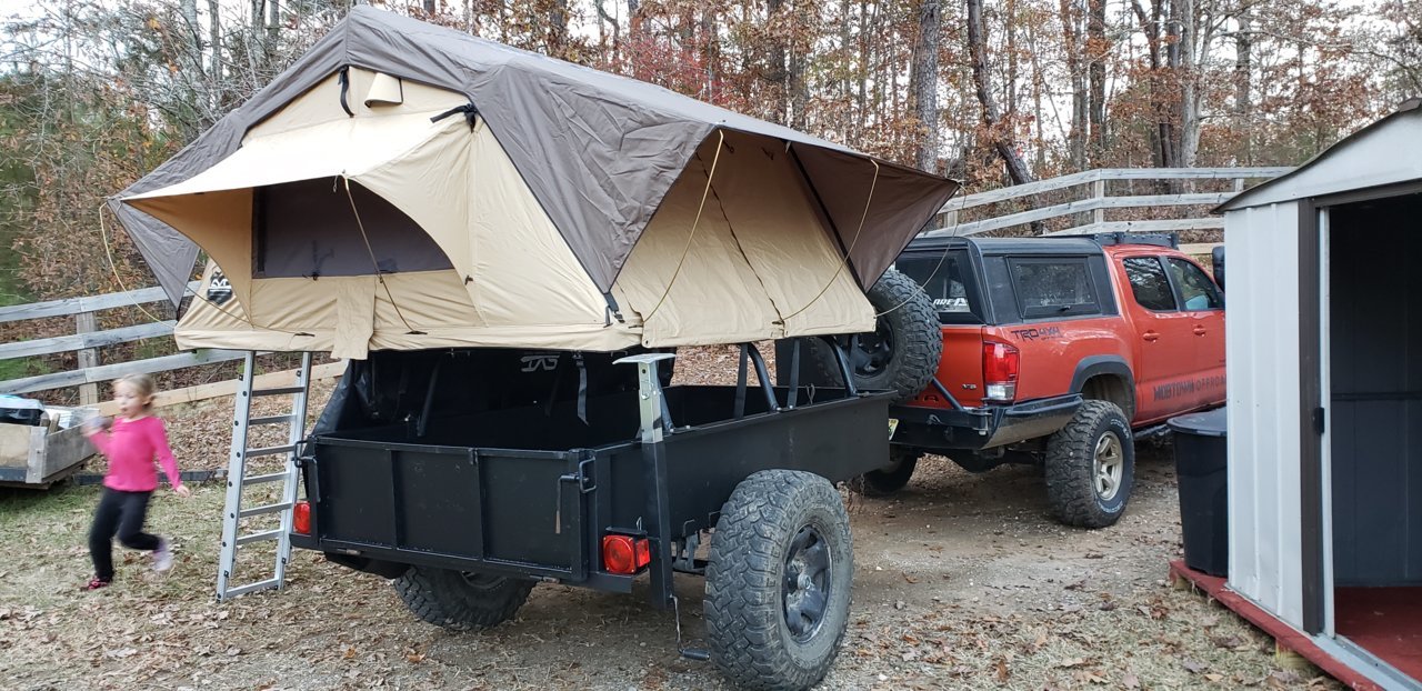

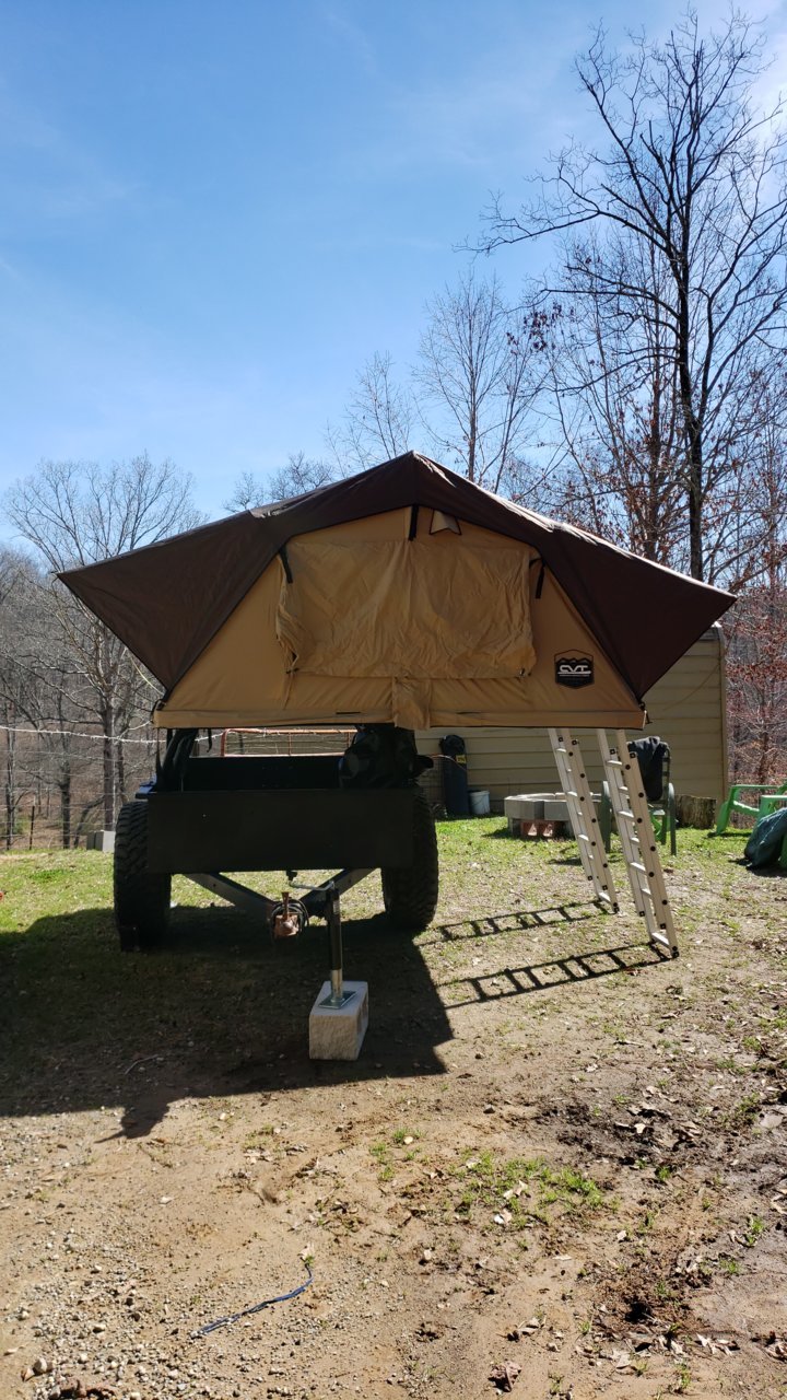

    Been converting mine from a 4x8 heavy construction trailer. Have alot more to do but its coming along
