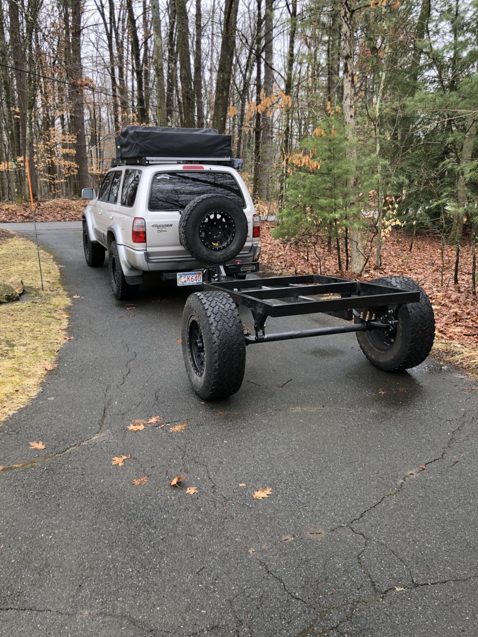

    I'm looking to build mine low as i can (keep in mind I plan to have storage drawers built in my box, with a fridge on a slide out at the rear, and room for 3-4 totes on top of the drawers... the tent I would like to be able to adjust the height from as low as possible to a max of 6'4" (I am 6'2") and will allow me to use my annex. I plan to accomplish this with fitting 1" square tube welded/bolted tot he frame on the fronts/sides and using some inexpensive gas struts to assist.
    something like this... but maybe a bigger box... on matching rims to my taco...

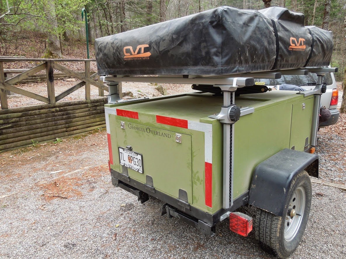

    I looked at one similar. It used a scissor jack to raise and lower the tent platform. Neat setup. Not mine.
    https://www.expeditionportal.com/forum/threads/fs-custom-offroad-trailer-with-rtt-nc.207314/

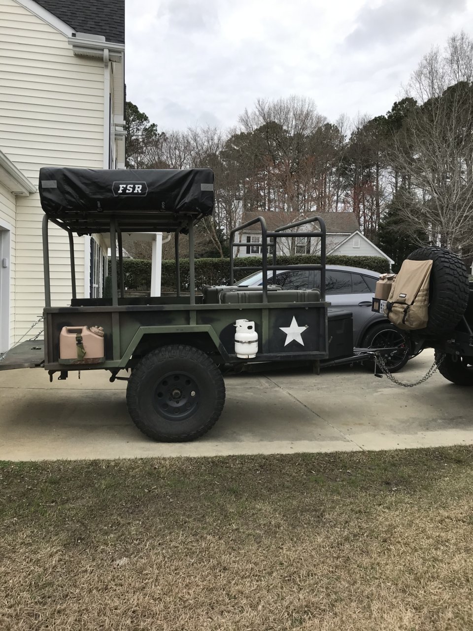

    Picked up a M101A2 last weekend. Installed tent tonight. More to come.

    only real mod it needs is to get rid of that pintle hitch.. an offroad hitch of sorts will get rid of most slop, and rattles.. I can only assue you changed out the hubs for the 6x5.5 bolt pattern. my only concern with the military trailers is the weight.. while not horrible, they do add some un-necessary weight, where I would not, and others where I would.

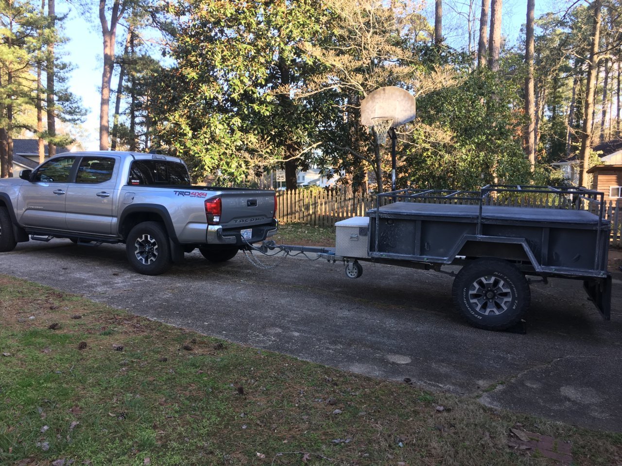

    sorry, just saw your question! It does, I built it with about 16" of lift. We pull the pins and with the struts only have to gently push it up to raise it and then lock the pins. Pulls down almost as easy and no electrical to mess with ;-). Keeps the top even with my tow rig on the road!

    Built mine so we could lift it high enough to walk easily under it when the tent was open, I'm 6'. Prob gives us about 6'4" of clearance. It lets us us the annex room and floor without it sagging.

    @Scott17818 trailers are new to me. Weight concerns are from which vantage point? Stopping, starting, or other? MPG take a big hit, I'll grant you, but have not seen much else.

    all of the above especially if you are taking it offroading.. the weight can mean the difference of having to winch a lot, or not much.. basically think of it as dragging dead weight uphill, or through/over traction robbing obstacles. and mud holes.... basically makes it an anchor.. so as much weight you can shave off it the better. especially if you don't have trailer brakes/surge brakes on it. aluminum would be ideal, however it tends to crack when stressed, steel can stretch/bend to an extent, and eventually will break welds/crack, but is easily repairable in a shop, or with a set of batteries, jumper cables and either a welding rod, or a metal coat hangar..
    design for weight savings can be key here. I'm planning out a box with either an internal frame, or a bottom frame covered in 1/2" UHMW.. playing with some 1/4" UHMW right now for drawer sliders on my bed drawer build. stuff seems fantastic it is slippery, and with a bit of wax on it... should slide very well and give me YEARS of service. stuff is used for the bottom hulls on airboats for S&R.. and when properly supported holds weight, and will allow the trailer to float/slide over rocks, mud/snow/sand...still in the planning stages right now...

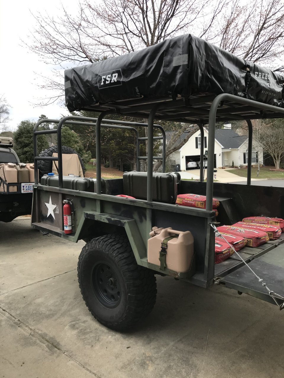

    Mine hauling concrete for our new puppy fence.
