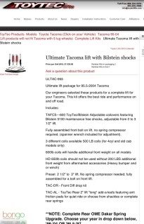

    Would this suspension be great for this
    E7C7C225-70FF-4CD9-89EF-BADB601BCF1A-123_ba9b51d36f0363521f3373773536f381322c109f.jpg

    No. Look int mid travel.
    You'll need extended travel coil overs by either icon, fox, or king preferably with remote resivoirs and some new UCAs.
    Then you'll need a nice flesh leaf pack and some nice smooth body shocks around 10-12" travel and possibly a small shock cage.
    Or go big and get full long travel. Which you'll have to look up.
