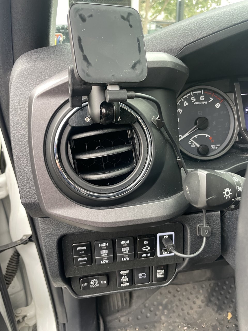

    This is how I have it setup. I did a fuse tap to run power.

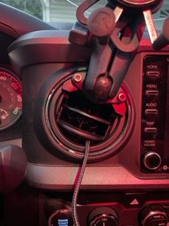

    Different mount for me but ran the cord through the vent the way you mentioned. The foam tape used to “seal” the trim vent to the duct is soft, so I just gently pushed the panel trim back into place, no problems for a year now.
    Didn’t want to drill a new truck.
    Added pics/
