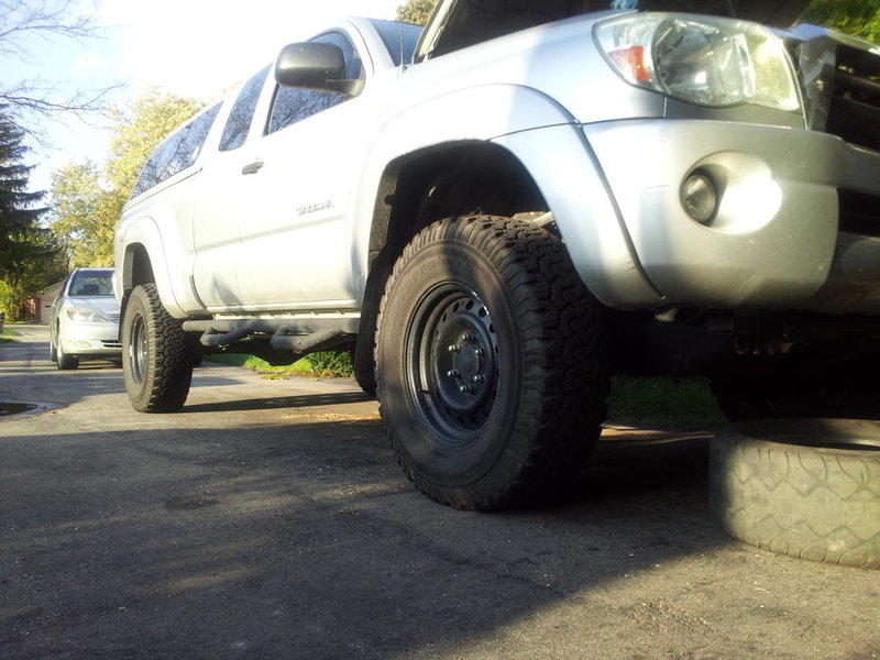

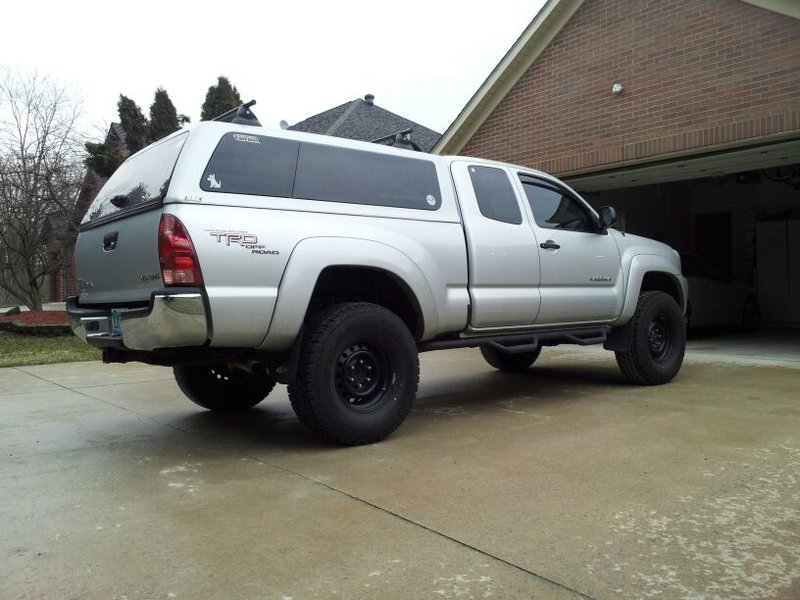

    When you say 33" does that mean 285/75-16 or 33/12.5/16?
    I found that Tundra steels like the attached worked great when I had the 285/75 on them (265s in 2nd picture), they are 16x7 +15mm, nothing rubbed. Stock 2nd gen Tacoma wheels are 16x7 +30mm, tucked in more by 15mm, so 285s might rub on the frame rail.
    the FJ Baja 'bead-lock' 16X7.5 +10 works best with a 285
